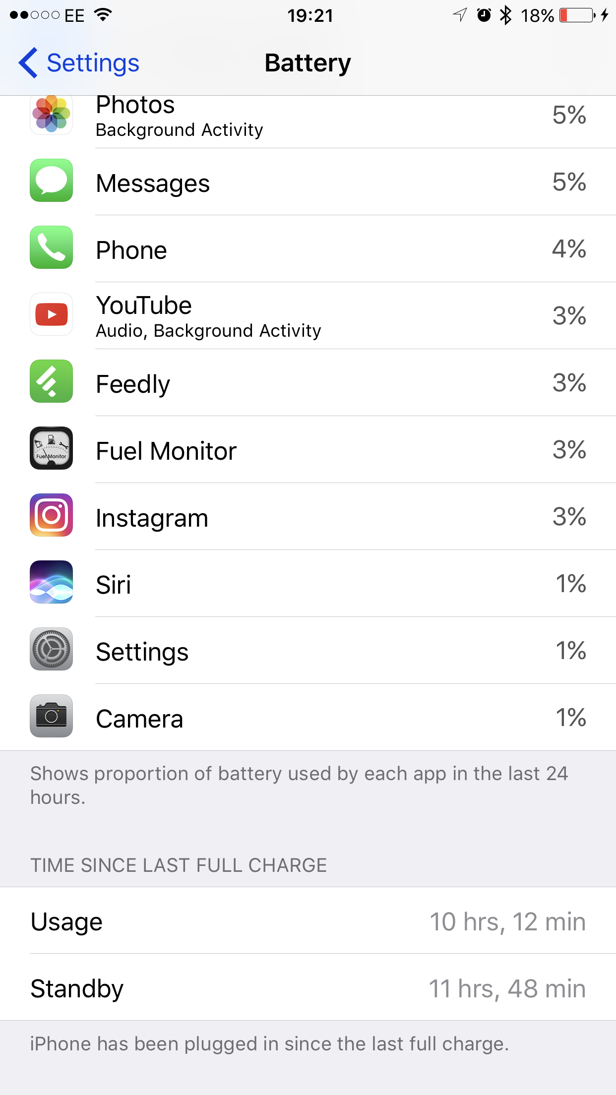

Signal isn't great - probably 2 bars most of the day.
When I've seen other people with signal battery issues it's usually poor standby time rather than high usage.

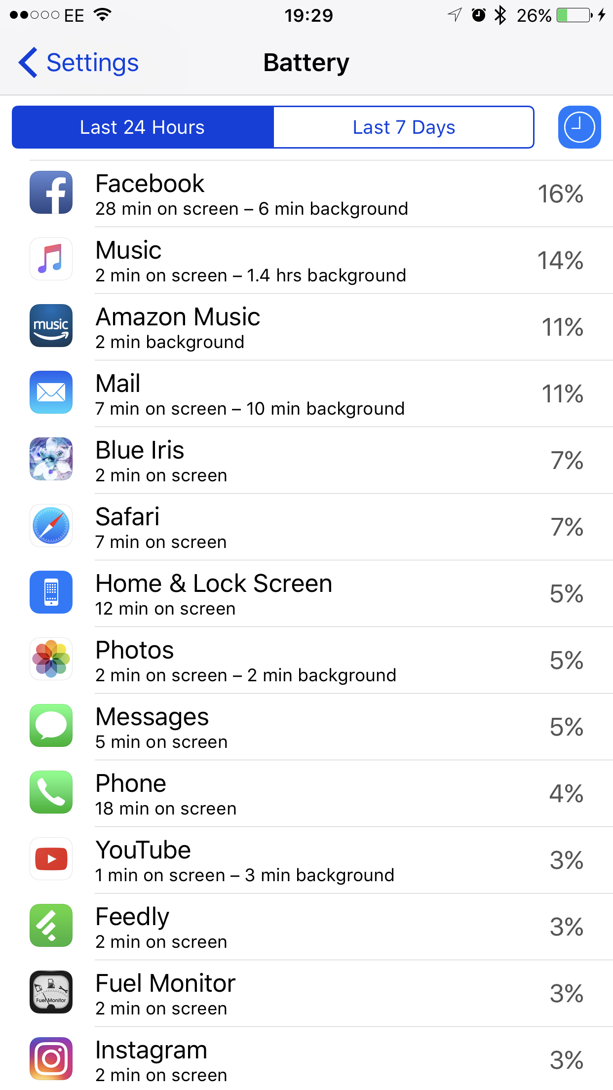

Nothing suggests high background activity at all.
I can only think that there is a certain app that remains running even in standby but I can't work out what it could be. Most days the usage is very close to standby but occasionally it seems accurate and the battery lasts well. I'm stumped.

Under settings - battery it should show you what apps are using battery. Does anything stick out - look strange like some app you didn't think you were use with a high percentage
No that's exactly the issue. The highest thing in the last 24 hours was facebook and that was used at night before it was charged.
I've recently noticed that doing a hard reboot fixes the issue for a while so I can only assume that an app or system service is not closing correctly and is eating the battery. I have no idea how to diagnose it but my battery currently has 72% left and it's been off charge for 10 hours so far.
