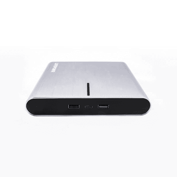

A few years ago, it was difficult to find a USB-C battery pack capable of charging a MacBook at a speed of 30 or 45W, but with Apple and other companies increasingly embracing USB-C technology for everything from smartphones to laptops, high-powered USB-C battery packs have become more readily available.
Higher-watt USB-C battery packs are ideal for fast charging iPhones and iPad Pros, providing power for MacBooks and MacBook Air models, and even charging up a MacBook Pro when charging speed isn't an issue.
In this guide, I'll be comparing 27, 30, and 45W battery packs with capacities ranging from 19,000 mAh to 26,800 mAh from companies that include Mophie, Anker, RAVPower, Jackery, and ZMI to help MacRumors readers find the best USB-C battery packs.[*]Anker PowerCore+ 26800 PD Charger (30W)
[*]RAVPower 26800mAh PD Portable Charger (30W)
[*]Mophie Powerstation USB-C 3XL (45W)
[*]Jackery Supercharge 26800 PD Portable Charger (45W)
[*]Anker PowerCore 19000+ PD Portable Charger and USB-C Hub (27W)
[*]ZMI USB PD Backup Battery & Hub (45W)
USB-C Battery Pack Basics
All USB-C battery packs suitable for use with devices like the MacBook or MacBook Pro are large in size and generally just under or over a pound in weight. You're not going to want to stick one of these in your pockets, but they fit into a bag or a backpack.
Each of the battery packs we tested are 45W or less, because there are no higher watt battery packs available on the market. They all come in at under 100Wh, which is the limit that you can take on a plane in your carry-on luggage (power banks like these can't go in checked baggage).
All of these battery packs have additional USB-A ports so that you can charge more than one device at a time, but keep in mind that the maximum power for each one is distributed between devices when you have more than one thing plugged in. If you want the fastest charging for something like a MacBook that takes all of the available power, charge it alone.
For recharging these battery packs, you're going to want a USB-C PD power adapter that provides 30 to 45W of power. Some of them come with an appropriate power adapter, while some of them don't. You're going to get the fastest recharging speeds over USB-C, and when dealing with a power bank of this size, faster recharging is essential. Most of these will recharge in 2 to 4 hours using a 30 or 45W power adapter.
While all of these battery packs are between 19,000 and 26,800 mAh, no battery pack provides the maximum stated capacity because some power is always lost when transferring charge from one device to another.
