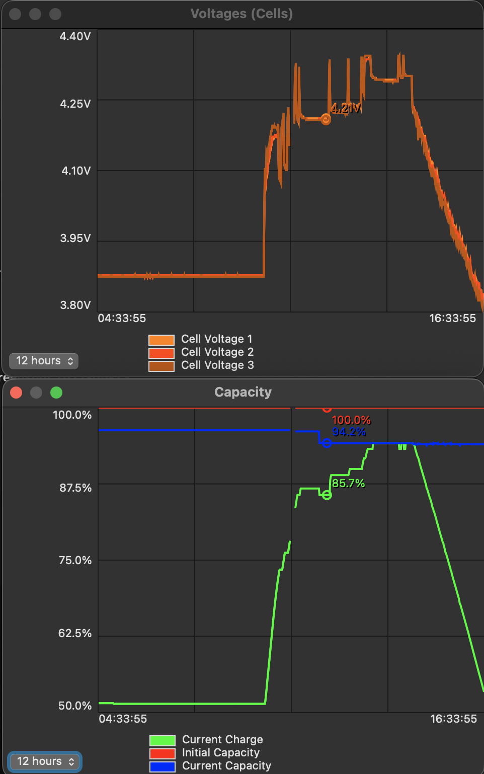

Thanks for interesting angle on battery health. I am not an expert either and doubt whether you will get the level of expert replies here. You have probably seen this article since you mention Battery University site. I just had a look at my recent cell voltage history and confirm what you say.
