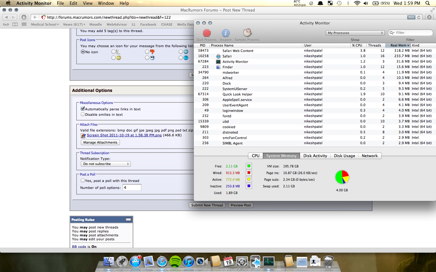

Why is my laptop getting so loud when I am just browsing the internet?
As you can see, I have nothing open but safari and finder
I also don't have any tabs open besides this one. Whats going on?
______________________________________________________
Have a look at Activity Monitor (Applications / Utilities /) and select All Processes and sort by CPU to see what the culprit may be.
Also check the "System Memory" tab to see what your "Page ins:", "Page outs:" and "Swap used:" are.
image below uses sorting by CPU as an example

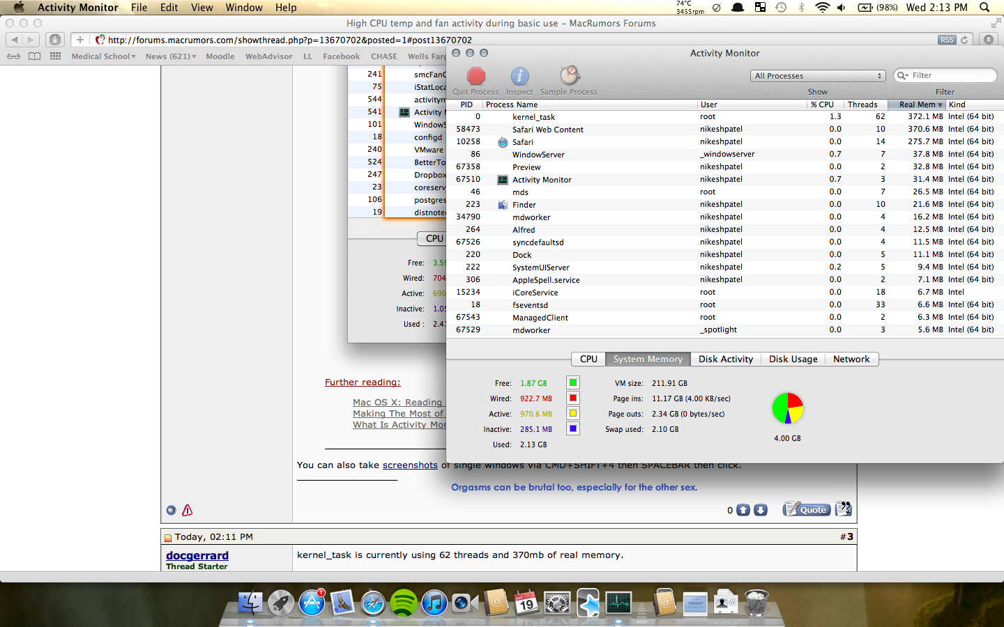

kernel_task is currently using 62 threads and 370mb of real memory.
everything else is the same
i did everything so you guys could see the temperature and the fan speed, plus the other stuff on my screen that may help figure this out.

SORT BY CPU, as advised before. Sorting by REAL MEM does not provide the info we and you are looking for, as RAM does not heat up the Mac, the CPU does, and the CPU does heat up when it is used, thus finding out, what causes the CPU to be used, can explain why there is this temp.

sorry man, i definitely understand what you are saying, but can't you just see CPU on the side? thats the problem there aren't any processor intensive programs running but its still a problem. if you notice, kernel_task is highest one
So no other process uses more CPU than "kernel_task", even WHEN sorted by CPU?
If that is the case, then maybe your vents are blocked or something is amiss. With high fan speed, you can always try an SMC Reset, but as the temps are a bit higher (not even critical), the fan speeds is normal.
