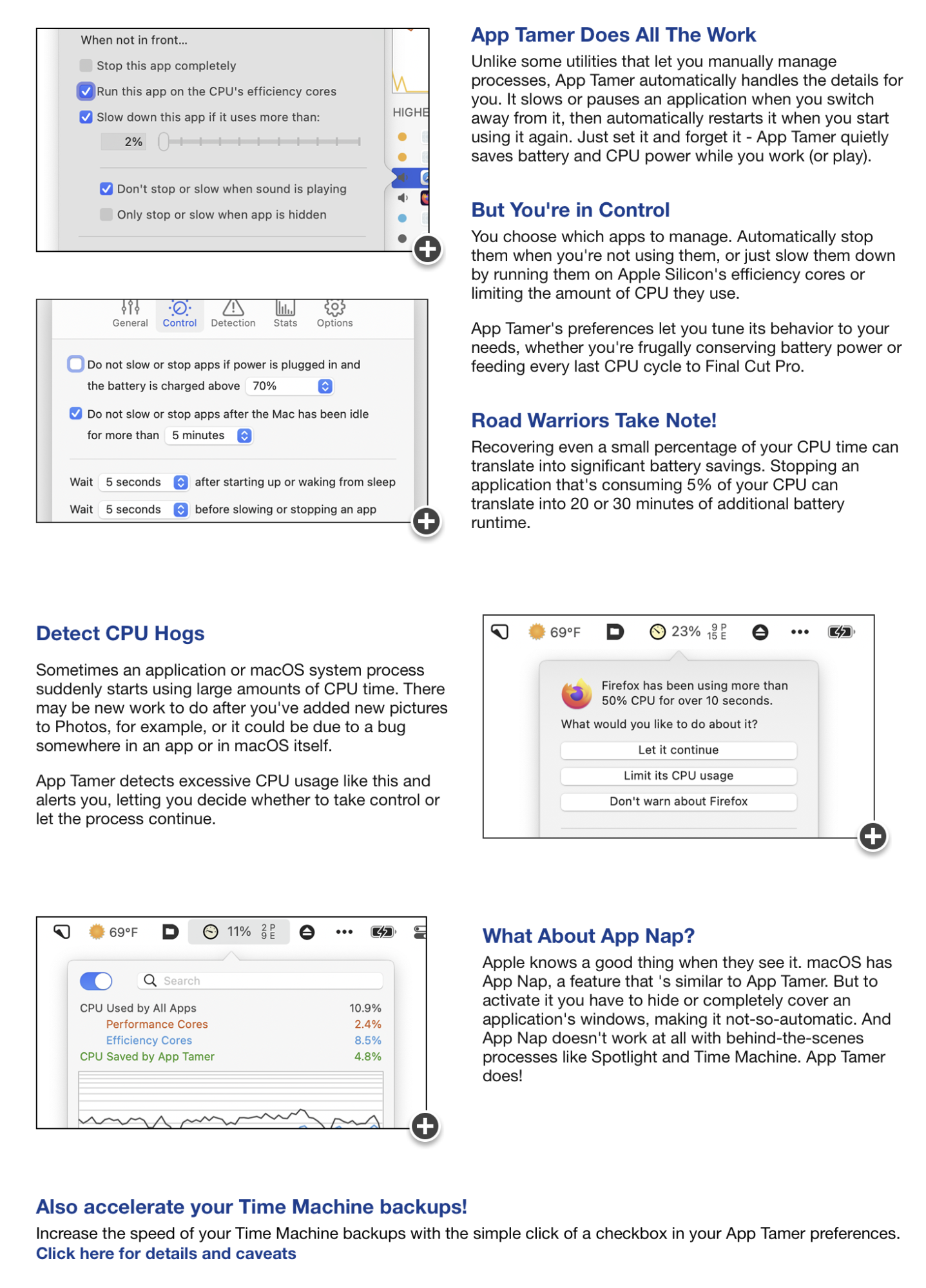

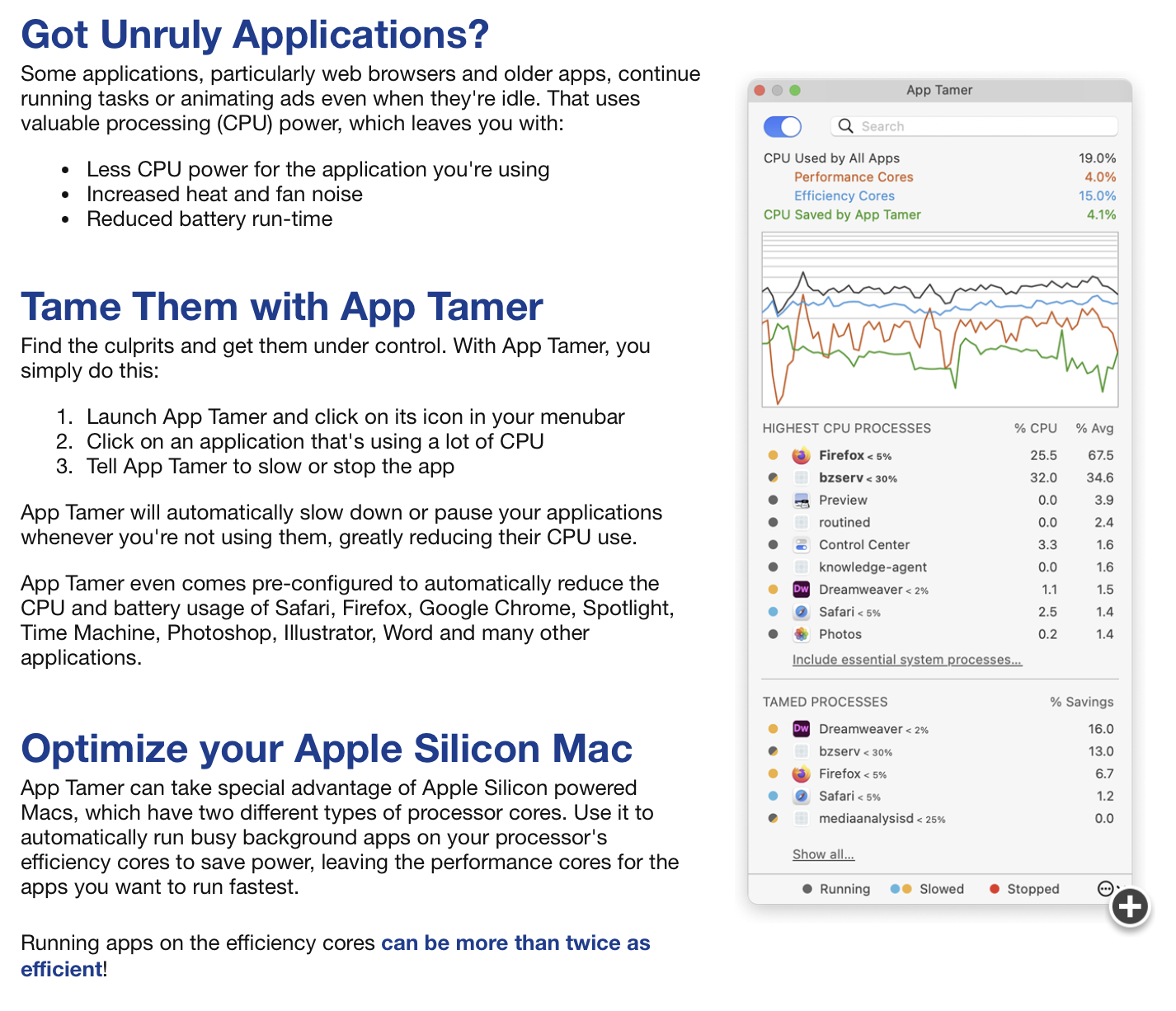

I tested this one because it is in Setapp:
https://stclairsoft.com/AppTamer/index.html
You can set limits for every single app and process and it warns you if something is causing a too high CPU load in a too long timeframe, you can change those limits. Also you can tell an app only to use low efficiency cores etc.
