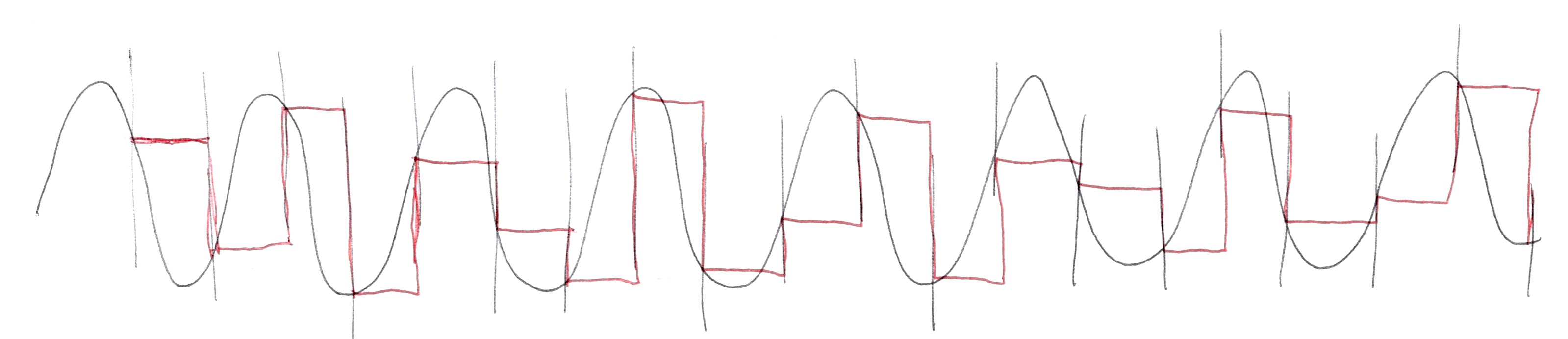

Ok, well, I can't explain it very well - and as I say, I'm sure it's down to me fundamentally misunderstanding what's going on - but let's take a slower wave, and sample it more than twice a wave cycle - I've sketched here a black wave form, and then sampled it and sketched out in red the resultant information. I suppose it's then down to how the DAC actually converts that blocky form into something that's actually smooth and analogue, and I'm sure that's where the magic actually happens, but on first sight the red waveform certainly bares little resemblance to the original waveform:
The digital signal has a value at the sample point and then nothing until the next sample. So instead of that blocky graph where it samples and holds draw it as a lollipop graph with a vertical line to the waveform at each sample point

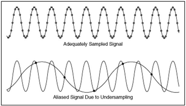

This is not an inherent property of what the nyquist limit does. Your statement is only true if you've used a lowpass filtering in your mastering process so that frequencies and harmonics above the Nyquist limit are filtered out before they are recorded.
For example: A Nyquist limit of 22.05kHz does not mean that it will not sample 33kHz. ANY sampling frequency will intersect with that 33kHz wave in a way that produces a series of values that result in a different wave at a lower, and often audible frequency.
There are only two ways around this phenomenon:
1. Use a lowpass filter at the nyquist limit to completely prevent any frequencies above that limit from being captured at all. The nyquist limit is a conceptual limit, not an actual barrier to sampling frequencies above it.
2. Choose a Nyquist frequency so far above the A-weighted range that frequency roll off and frequency aliasing become completely immaterial, as they will not produce other artifacts inside the range of human hearing.
The other general rule is to work in multiples of 24. So if you're sampling at 192kHz during the recording stage, don't mix down to 44.1, but rather 48 or 96. This reduces downsampling error... though computer processing is so powerful these days that this is a far smaller concern than it used to be.
But again, I want to be clear that the Nyquist limit does not prohibit frequencies above it from being sampled. Even the sampling frequency doesn't prohibit that. If you sampled a 33kHz wave thirty-thousand times a second, it would produce an audible distortion... not the original wave, mind you, but the resulting ALIAS of the wave--a lower frequency wave--which ends up inside the A-weighted spectrum.
More detail here.
Excerpt:
"Although sampling at twice the Nyquist frequency will ensure that you measure the correct frequency of your signal, it will not be sufficient to capture the shape of the waveform. If the shape of the waveform is desired, you should sample at a rate approximately 10 times the Nyquist theory."
