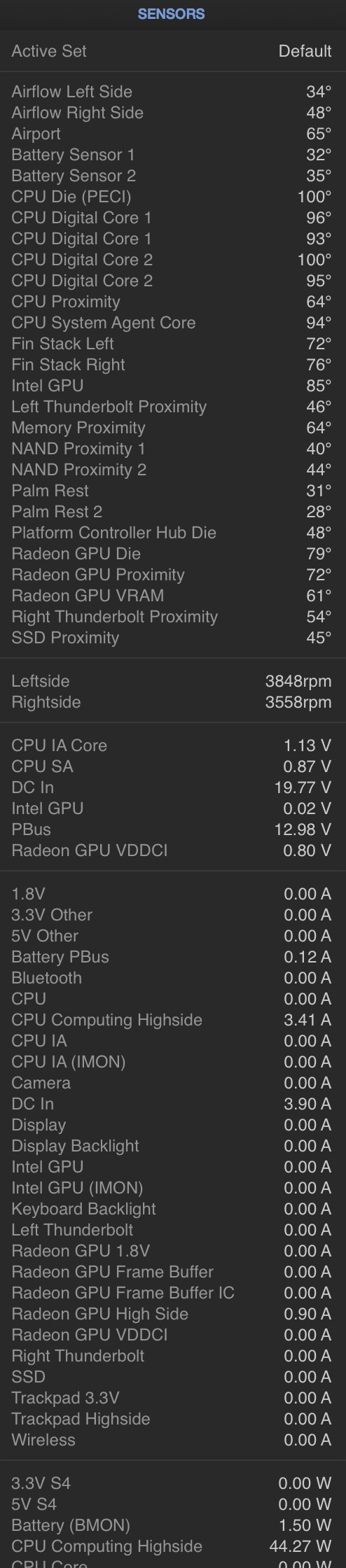

I have the 2.9 GHz / 460 / 1TB model and was using PDF Expert with huge PDF files and word documents on an external display when I heard the fans and snapped a screenshot of my temps... 100 degrees C CPU!
This can't be good... should I bring it in? Return it? Is this normal?

With 2.9GHz and dGPU active reaching 100C is normal, but.... it doesn't mean much at all unless your fans are at 5500/6000 rpm. The screenshot is also absolutely meaningless without the actual CPU load %. CPU Highside load could be an indicator, but it's not that helpful either unless you know the idle/max wattage.
I'd strongly recommend you to install Macs Fan Control and adjust the default rpm curves. It's a mandatory thing to do for a decade already for any Apple laptop. The moment your CPU hits ~85C both fans should be at their max rpm.

In my opinion 100 C is never good. But also as Maratus pointed out the fan curve profile seems to be weird. The CPU is reaching 100 C but the fans are only spinning at around 3500 RPM and that makes no sense. They should be at 5900 RPM when the temp is that high. If I were you I would install SMC fan control and adjust the fan speed accordingly.
This fan issue should be reported to Apple aswell so they can make the fan profile more aggresive in a future update. People dont pay these sums of money to get a Barbecue grill, people want a laptop that can last them for years.

They start to spin up at 95C but they accelerate rather slowly. Higher-end CPU combined with active dGPU may be enough to briefly reach 100C instead of 95C (95C happens to be the limit for a 2.6GHz CPU @ 100% with fans in 3800-4500 range which they achieve faster)

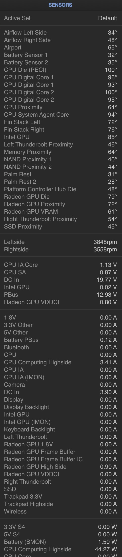

I did a fresh install of Sierra because I was having some other issues and thought they may be related to restoring from a time machine backup...
Look at these temps! And the MacBook Pro is elevated on a Griffin laptop stand with lid open and an external display, mouse, and keyboard attached...

Doesn't look exciting but I don't think it's defective either. And yep, that's the reason why I'd always go with the base Quad core configuration (this time it's 2.6GHz). Extra 10% in frequency isn't worth 10C higher temps, possible throttling and reduced lifespan with higher chances of hardware failure due to temperature.
I'd recommend to do a repaste with Kryonaut, but removing the heatsink is such a pain on these 2016 models.

100 C with fans almost spinning att full RPM while the MBP is standing on a laptop stand? I went with the 2.7 ghz mainly because of me being afraid of the 2.9 ghz version getting too hot. Now I begin to seriously regret not taking the 2.6 Ghz version... It feels dumb that a machine with the purpose of acting like a professional mobile workstation can't handle temperatures better than this.
I dont care what anyone say, 100 C is too much and even if the CPU can handle 105 C, these high temperatures will negatively affect the lifespan of other components in the laptop. I mean, the majority of the people dont buy a MBP just because it looks nice, they also want to utilize it without being afraid of toasting it.
My only recommendation is to buy Applecare, especially if you buy the 2.7 or the 2.9 GHz models, then you are atleast covered for 3 years. When I invest this amount of money in a computer I do expect it to last me a while.

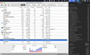

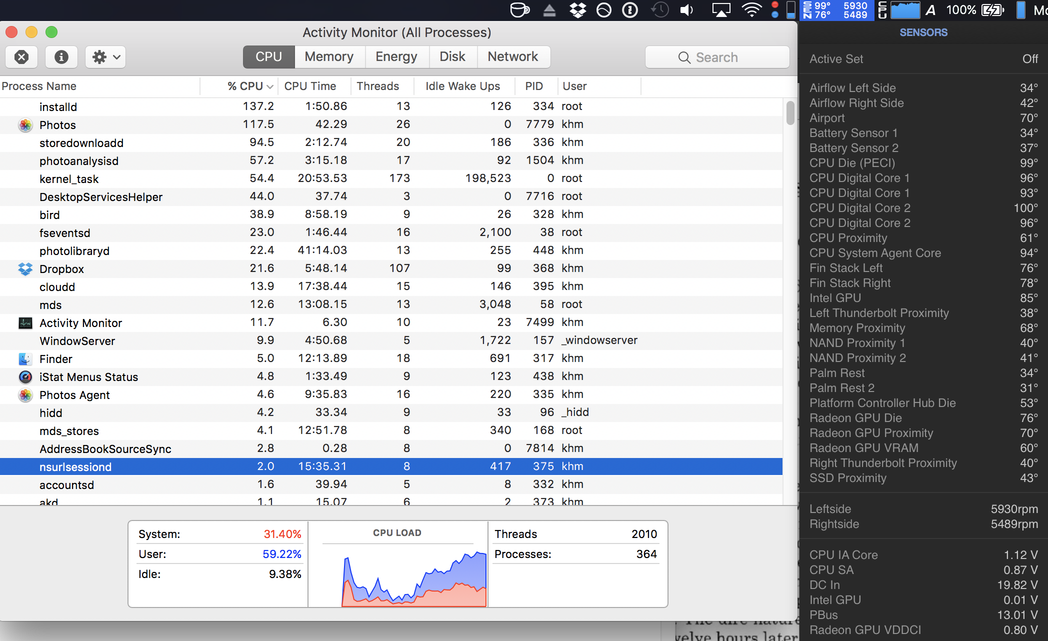

Literally just had Photos app downloading my backup photos and a large PDF open.
Apple claims its normal based on going to their support - but that can't be right. Are there any other 15" MBP users with these temps?

not everyone gets 90% cpu load basically while doing nothing
With 100% load

I've seen photoanalysisd use a huge amount of CPU (to where Activity Monitor looks like it does when I'm ripping a movie in Handbrake) when importing photos.
I'm guessing Photos is analyzing your backup photos for faces/scenes/etc as it downloads them?

I guess you haven't used 15" MacBooks from 2006-2015. 95C is a trigger point for fans. And it's always been like that. If you want conventional rpm curve, you need to install aftermarket fat control software.
