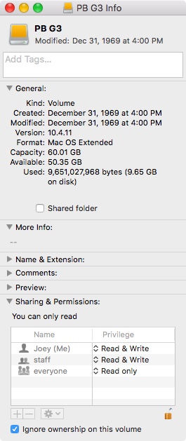

So I discovered that High Sierra seems to have some permissions problem with older versions of Mac OS X. I suppose this could be posted in that section, but I feel like I'd get more responses here.
I just got a G3 pismo the other day, and I'm just trying to load it up with some old games and software. Most of which is already on my iMac G3 and G4. I connected the PowerBook to the G4 with the PB being the one in target disk mode, copied everything that I needed to it no problem. Fast forward to right now, I have it plugged into my Mac Pro with HS. The drives get info box is pictured, all the permissions options are greyed out. Unchecking the "Ignore ownership on this volume" makes no difference.
The exact same thing happens with this Mac Pro and my iMac G3. I thought it was an isolated issue with my iMac because of the sata to IDE adapter I have in it, but being as this PowerBook does the same thing I think its a problem with High Sierra (figures). My MacBook with HS cannot write to them either.
Does this happen to anyone else, and possibly have a fix? I need to get myself another firewire drive, I havent had one in years. But USB is next useless with all these USB 1.1 Power Macs lol.
Both the G3s are running 10.4.11 and 9.2.

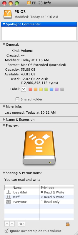

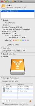

As for the formatting, HS is the only one that sees it as non journaled for some reason. It's definitely formatted mac os extended (journaled). I noticed it wasn't reading that right either.
My Mac Pro is APFS, but only on the boot SSD. My MacBook has high sierra as well and it's not using APFS at all. This screen shot is from the G5 instead.

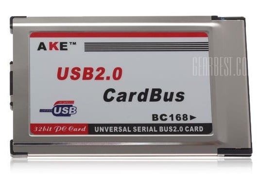

Or simpler still, get one of these generic adapters
at least one, if not both of the ports should get enough juice from the Pismo's cardbus port to power up a flash drive without any additional power supply. Also both ports sit flush inside the cardbus port so no snagging from the side of the Pismo.
extra info:
make sure you get one with an NEC Chipset for the best compatibility with Mac OS 🙂
(I have one of these as well and it works pretty good in the Pismo, even works well in my PowerBook 3400c,s and Kanga)
Reactions: Project Alice
I do want one of these eventually, very useful. I am going to invest in a FireWire enclosure though. I used to have one years ago but I've since then gotten rid of everything I owned and am now getting a decent collection of old macs again. FW drives are pretty much a requirement.
