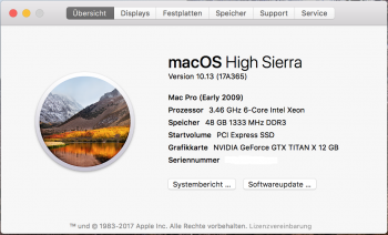

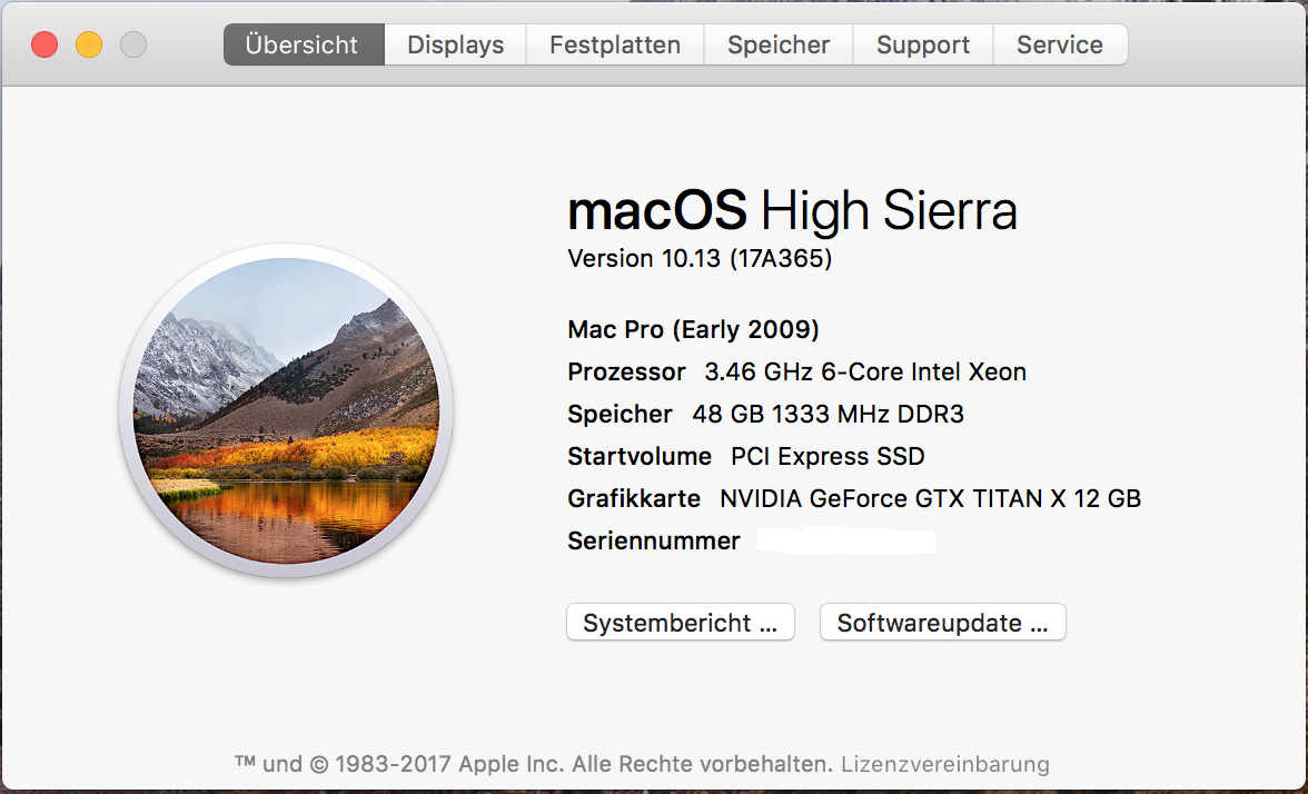

I upgraded my 4,1 flashed to 5,1 to High Sierra and had zero problems.
Upgrade worked perfectly. If it makes any difference I have a single SM951 SSD in it.

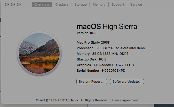

No problems here with a Mac Pro 4,1 (flashed to 5,1). Installed it on a Apple PCI-E SSD. Drive is now APFS formatted.
