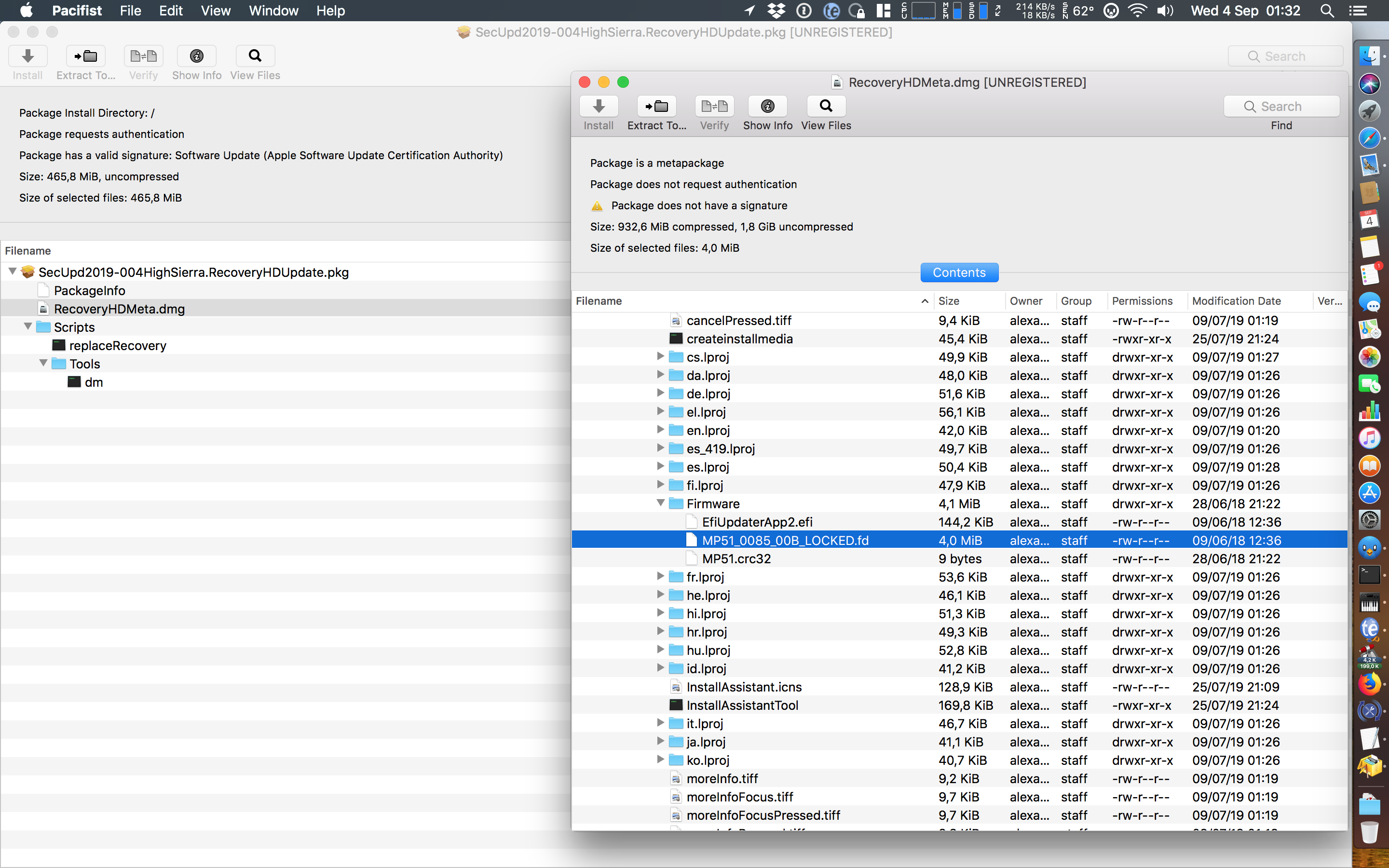

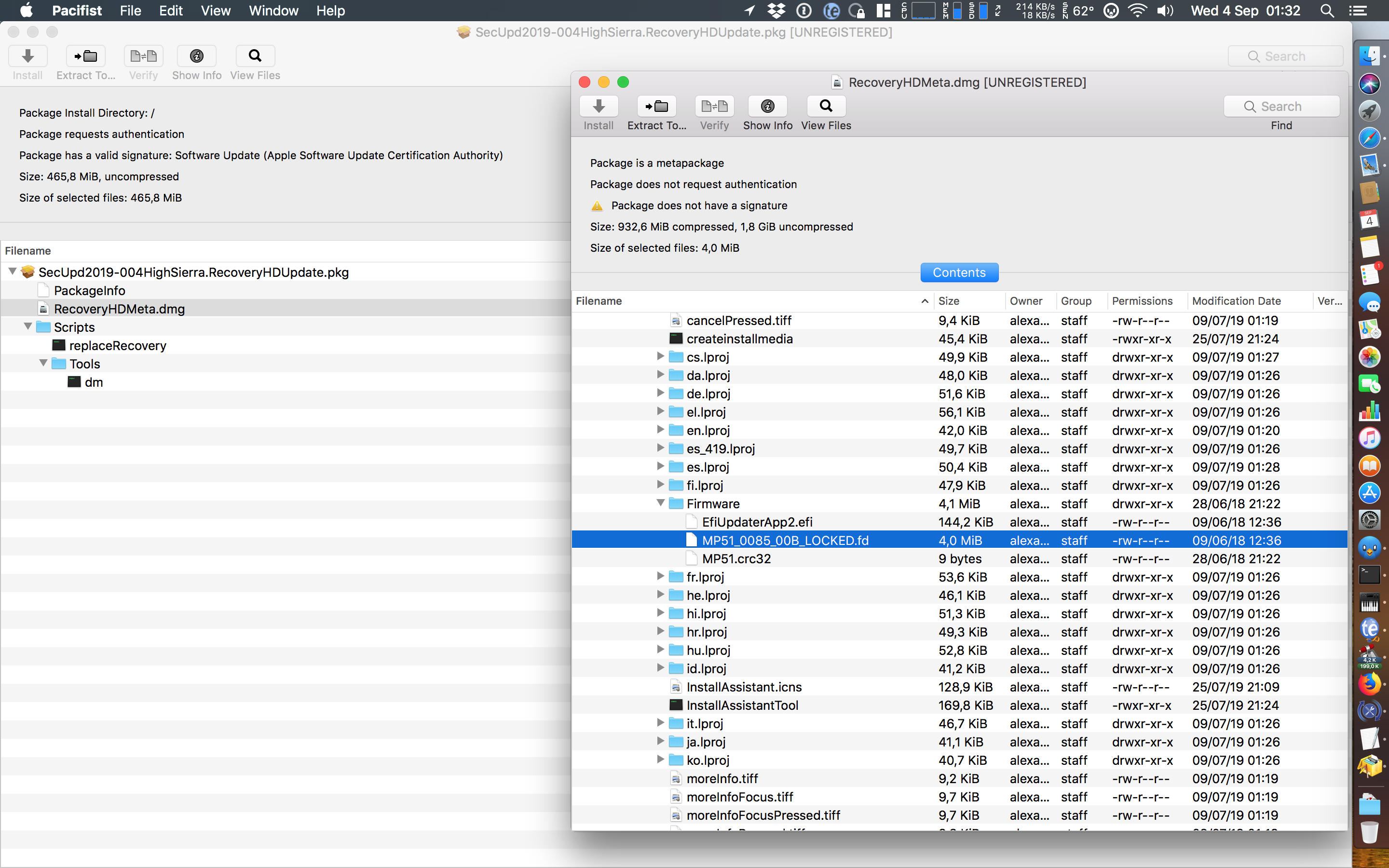

This is incorrect, Security Updates can't flash Mac Pro 5,1 BootROM and even the new Recovery Update for 17G8030, who can be used to manually flash a MP51 BootROM, still has MP51.0085.B00.
You can only get 144.0.0.0.0 running the full installer for 10.14.5 or 10.14.6.
I didn't run the Mojave installer? So how did I get the 144.0.0.0.0 . All you did was to say it's impossible, but it's done. I never intended to upgrade the firmware to 144.0.0.0.0 as I didn't want to mess the rom, but was surprised to find m Nvidia driver, same as the OP, WAS INCOMPATIBLE. That's how I knew about the build 17G8030! How else did I know this new driver? I have an Nvidia card running along side RX580.
Reactions: bvhprods
You are mistaken, see the screenshot, SecUpd2019-004HighSierra.RecoveryHDUpdate.pkg still has MP51_0085_B00_LOCKED.fd.
There are no other way to update a MP51 BootROM, it's the last Mac that have the manual method of firmware updates.
