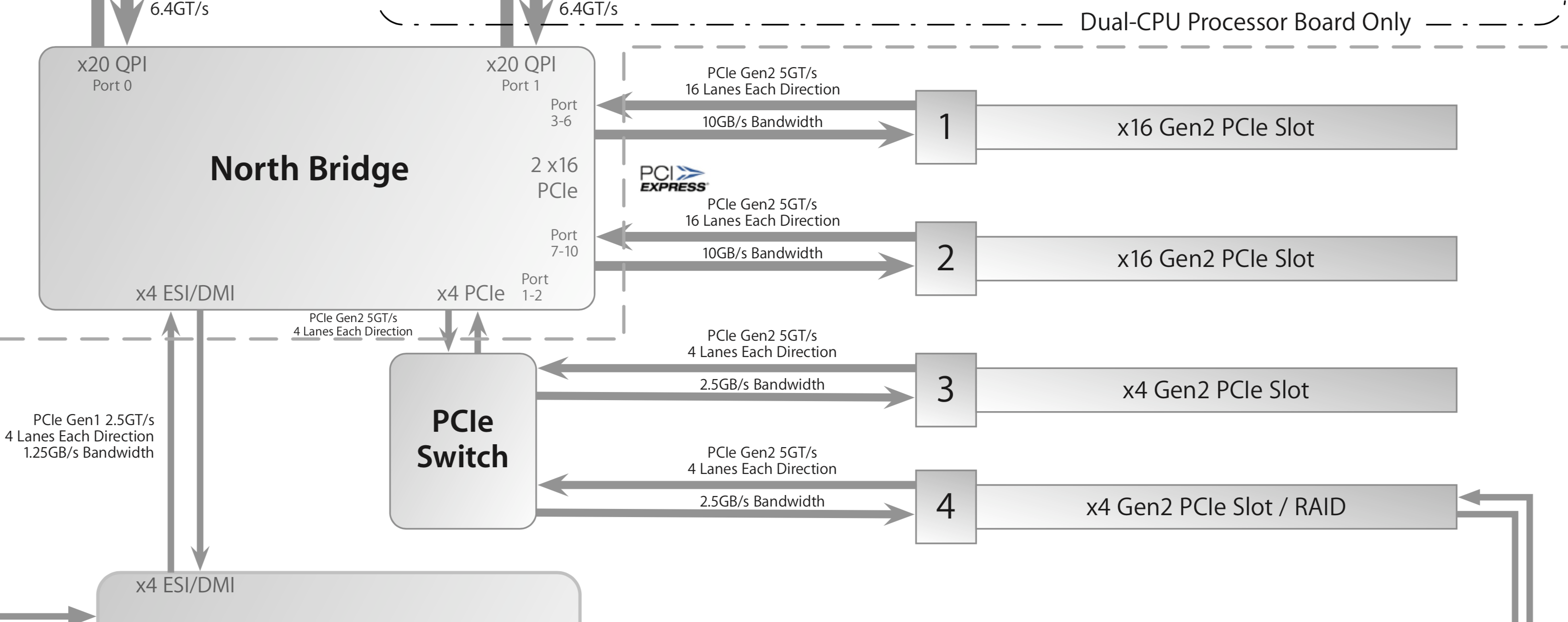

Bad news: A MacPro5,1 will not POST if a ASUS XG-C100C adapter is installed (no boot chime). The card appears to be powered though (solid LEDs on the card when an Ethernet cable is connected to it).
The card should be compatible with PCIe 2.0 x4, and I've installed it in slot 3, which should be exactly that.

bummer! IMHO this should not happen if a card follows PCI-rules/designguides.
EDIT:
did you try the card in a PC? maybe it has some kind of an option ROM or menu (net-boot for example)? or the card doesn't like slots 3 & 4 (the two slots are connected to a PCIe switch).
