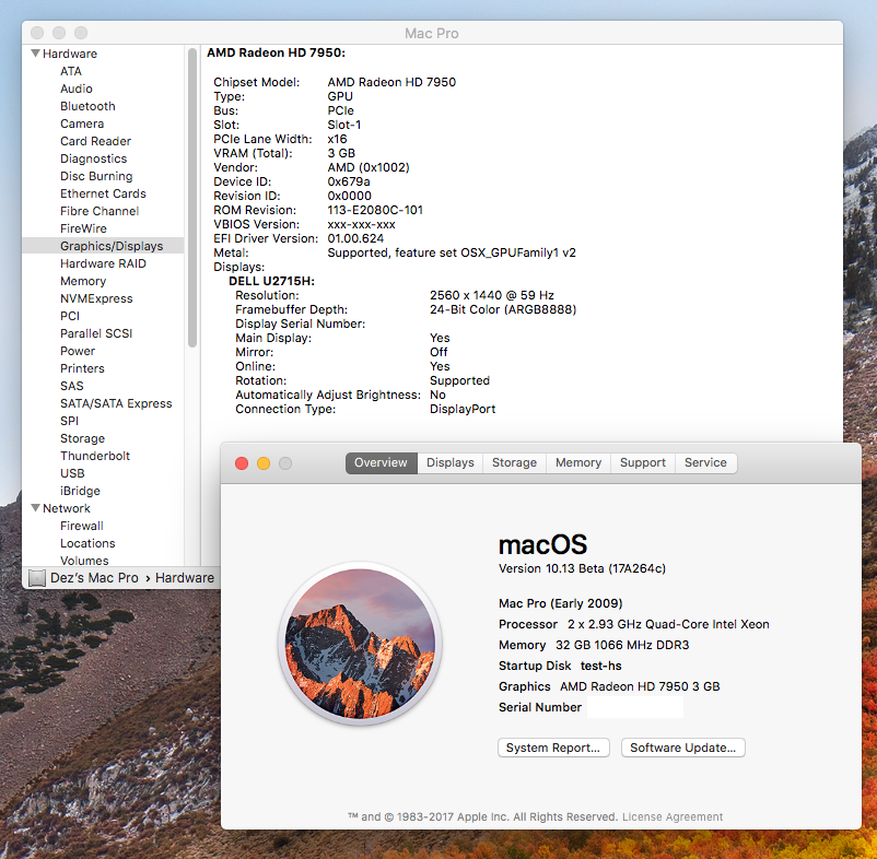

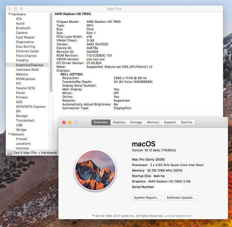

Hey 🙂 Just figured id make a quick post showing High Sierra on the cMP and a couple things i noticed about it
first one is cMP did not see a APFS drive as bootable when i tried to install High Sierra to it but HFS+ worked fine
second thing I noticed is a couple new/changed text fields to do with the GPU
1 is that VRAM is now reported in GBs instead of MBs (surprised it took them this long)
2 there is now a new "VBIOS" field thats currently blank on my Machine (it would be interesting to see what this reports on other macs, it looks a lot like AMDs BIOS version string format) and the metal field has changed 🙂
quick look in the extensions folder shows
no sign of Maxwell/pascal nvidia drivers sadly
few new intel and AMD drivers tho it seems 🙂 ill update this thread if i come across anything else if it has not been documented by then

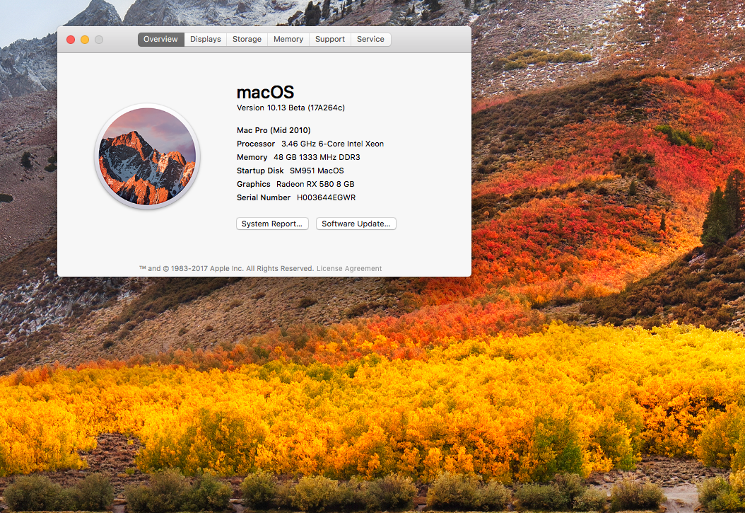

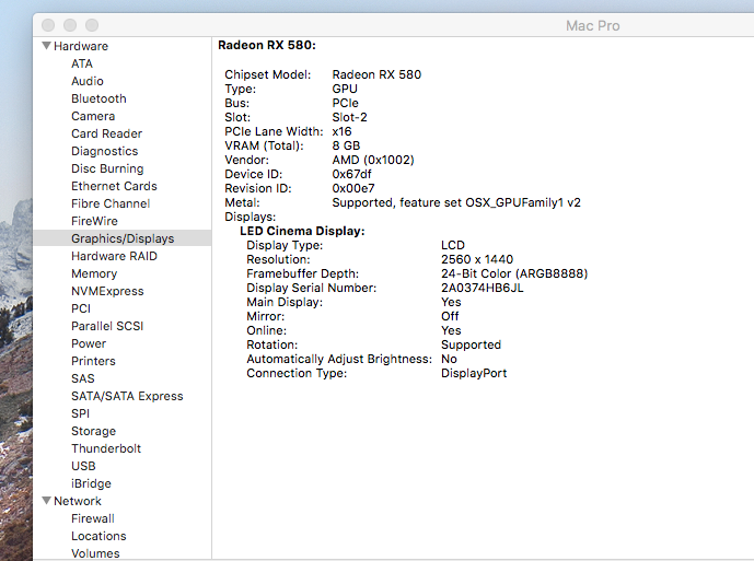

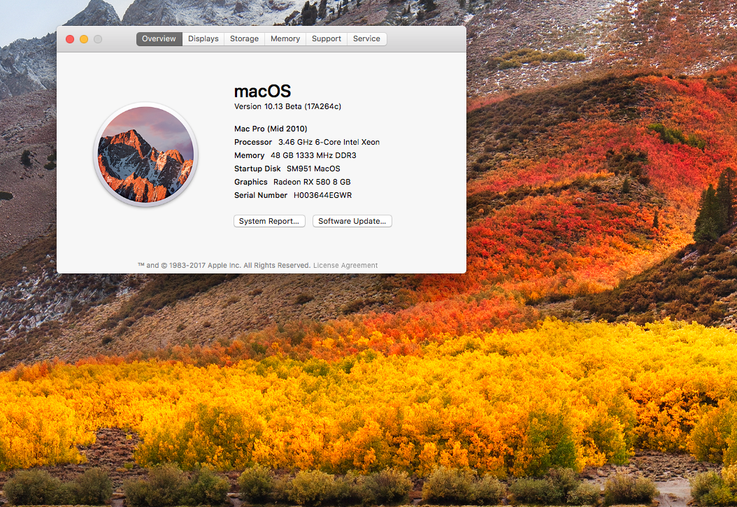

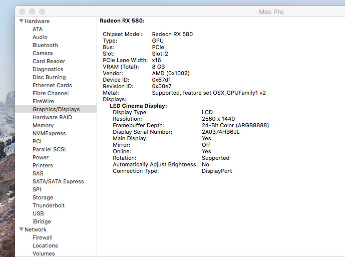

I should post it here:
RX580 natively works in Mac Pro 5.1. Running BruceX test at 16 seconds.
did it show up with that Name OOB? even on eGPU in High Sierra you get the generic R9 xxx name...
