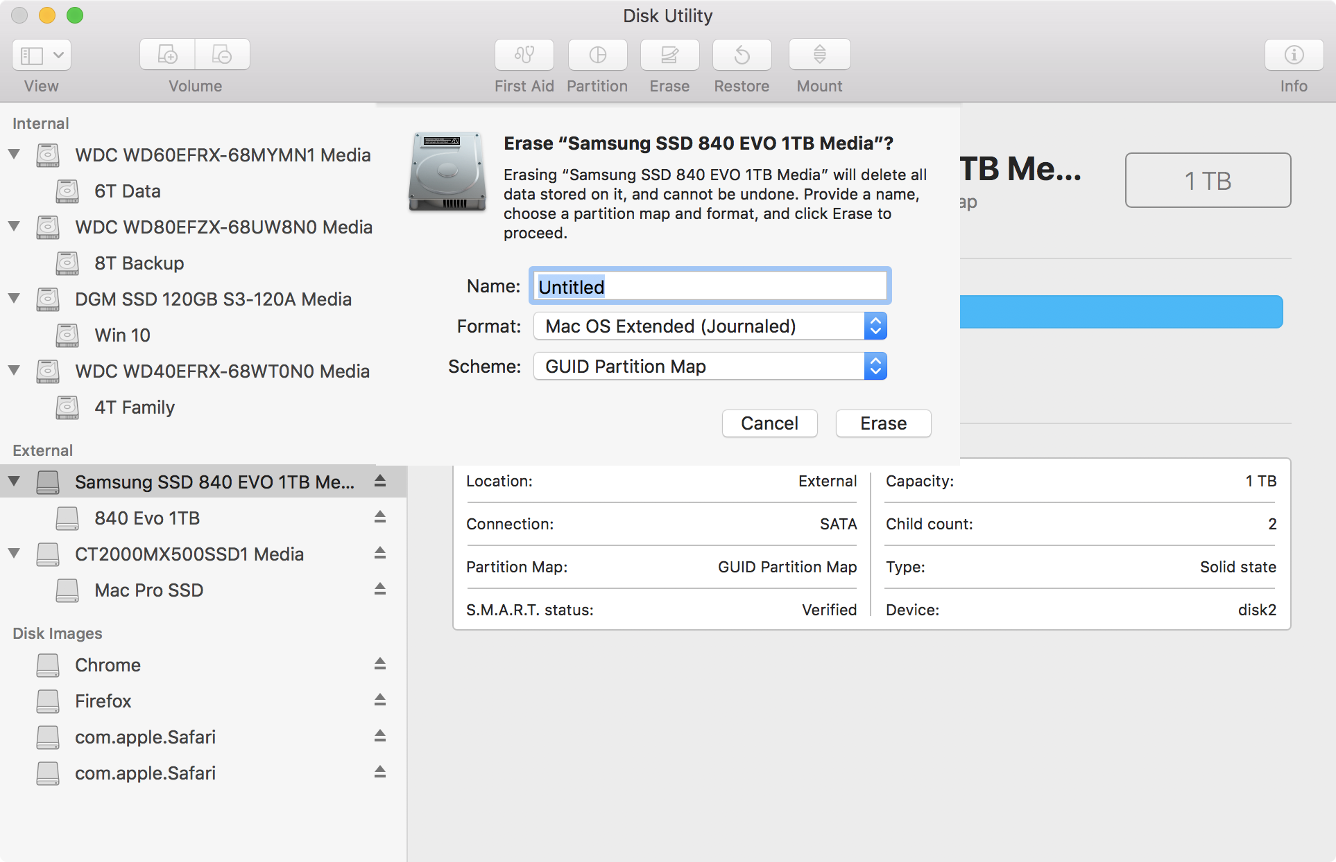

- Select erase and you will have three options- Name (Macintosh HD), Format Mac OS Extended (Jornaled)) and GUID as boot type.
- Click Erase and when done go back to the main menu and start the installation process.

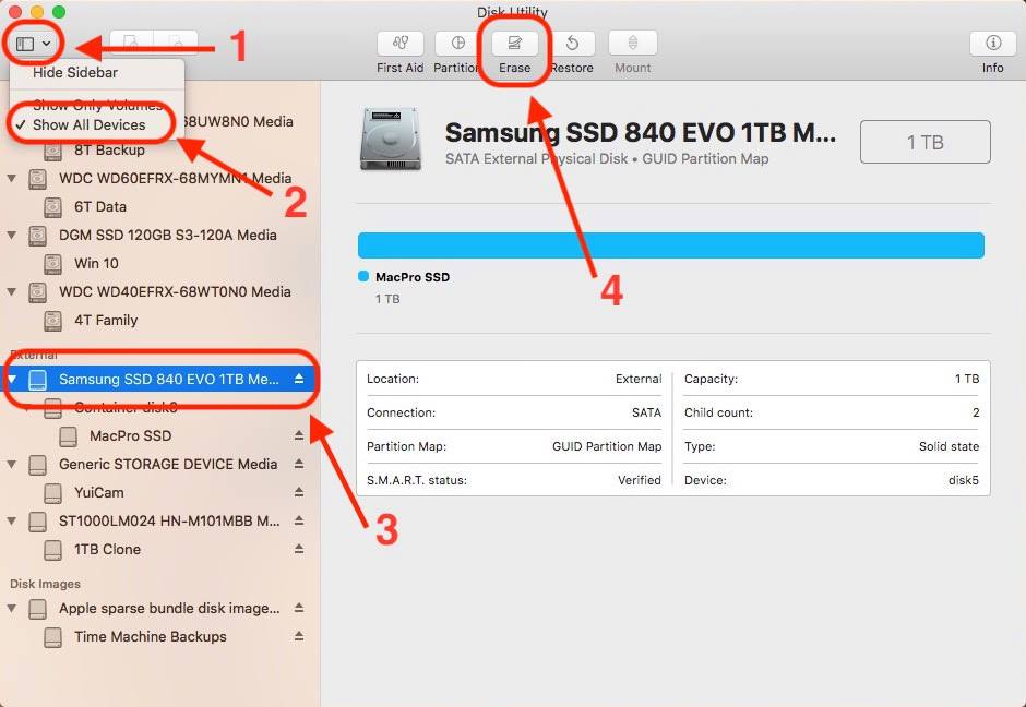

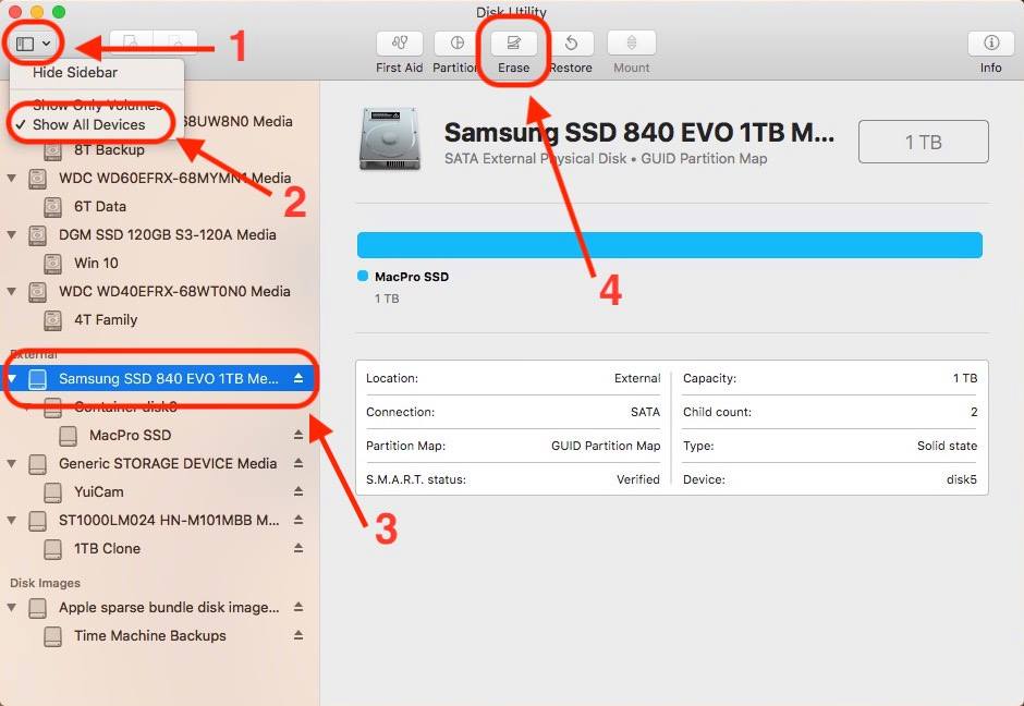

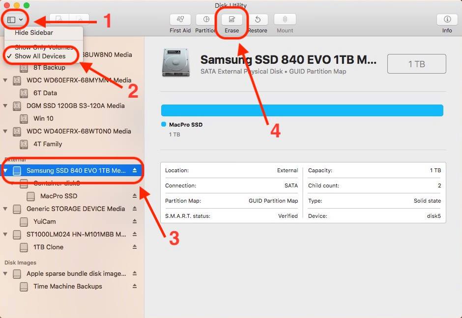

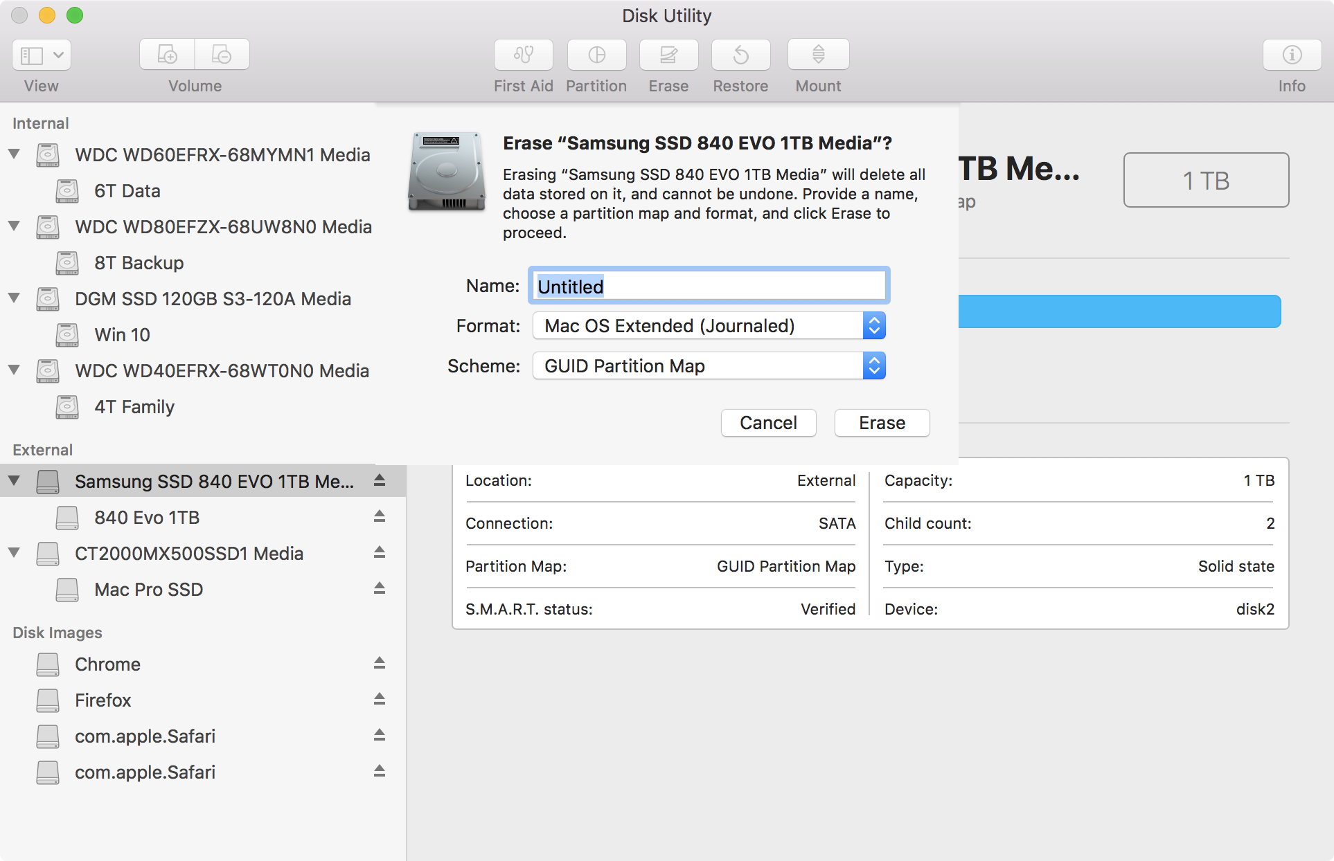

Just erase the drive, not the partition. If already inside a partition, of course can't repartition the disk.

No worries, I just want to post "how to format the DISK" properly. Lots of people says can't format back to HFS+ and looking for complicated (or even completely irrelevant) solutions. In fact, just because they don't know how to use disk utility.

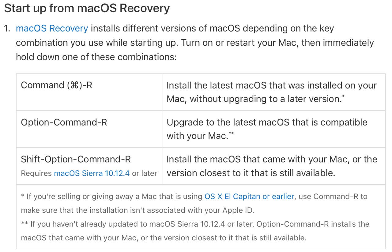

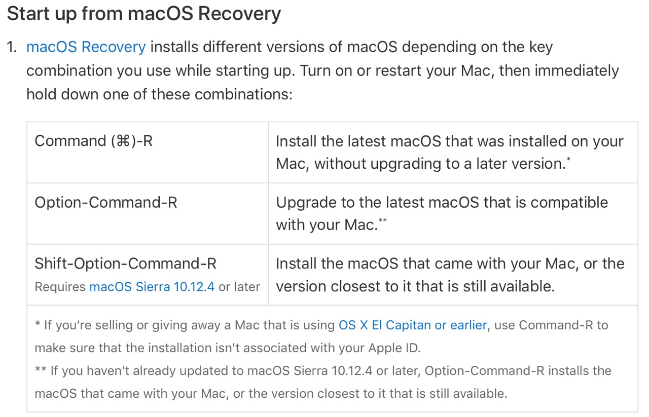

How are you entering Internet Recovery (what key combination)? Are you seeing the Internet Recovery globe on screen before the seeing the Apple logo?
You need access to Disk Utility earlier than the High Sierra version in order to format to HFS+. I would recommend trying shift + option + command + r. When you see the globe it takes around 4 minutes (depends on your internet speed) to load the 650 MB recovery image from the internet before the Apple logo start up. Latest key combinations for Recovery per Apple:

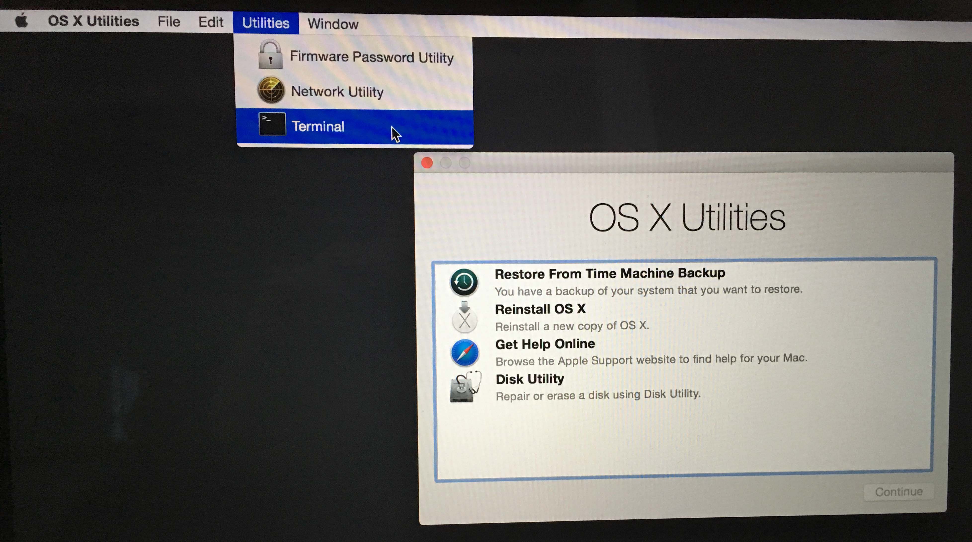

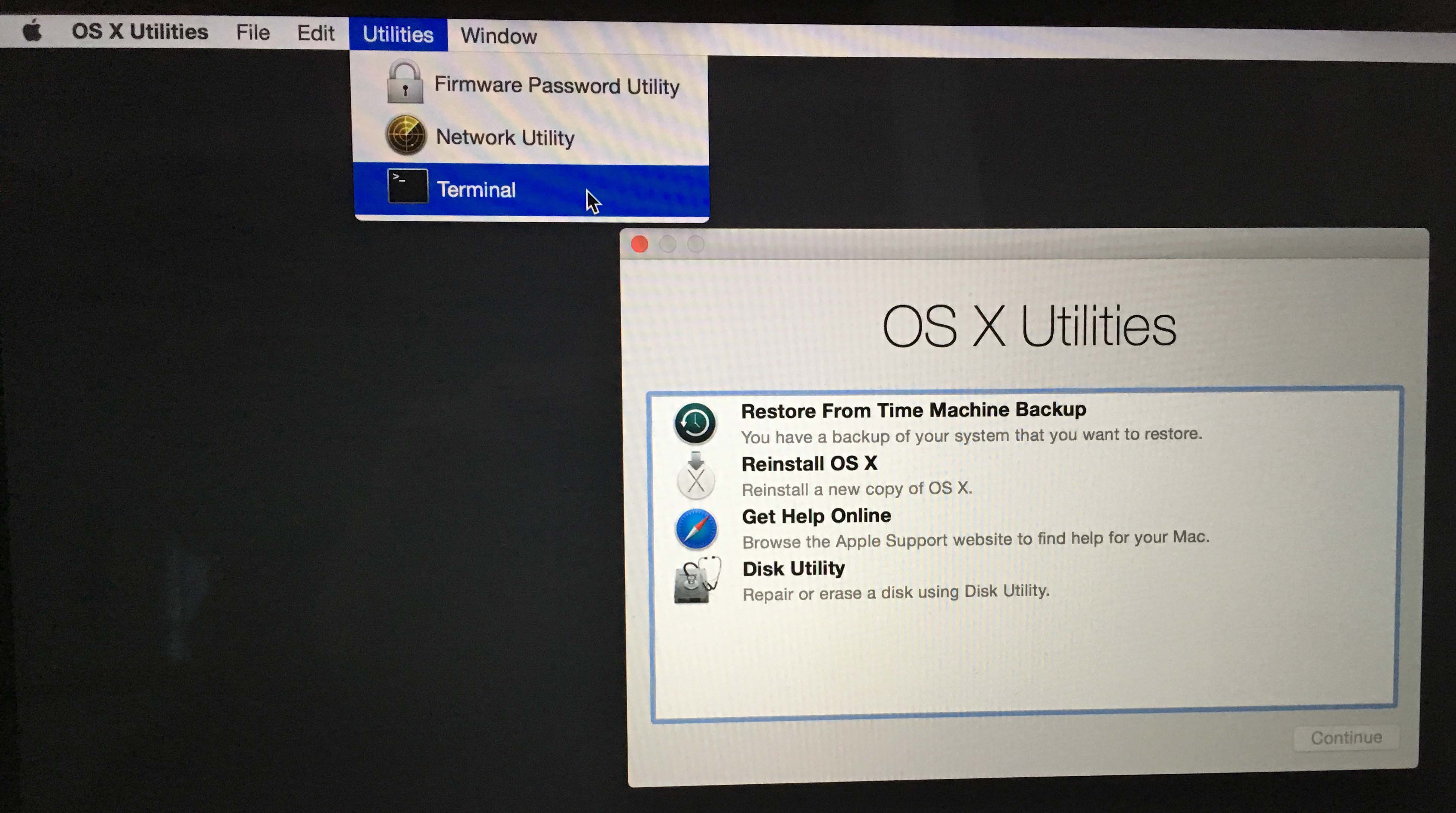

You can access the Terminal while booted up in Internet Recovery. You have to use the upper "Utilities" drop down menu and select "Terminal". I just tested it from Internet Recovery (shift + option + command + r):
