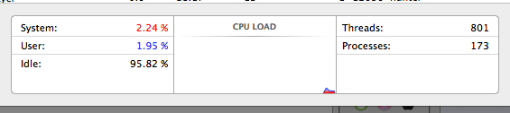

the cpu load is always low. it typically looks like this:

While it is running slow you need to post the activity monitor cpu page in full. That will tell you what is running.
