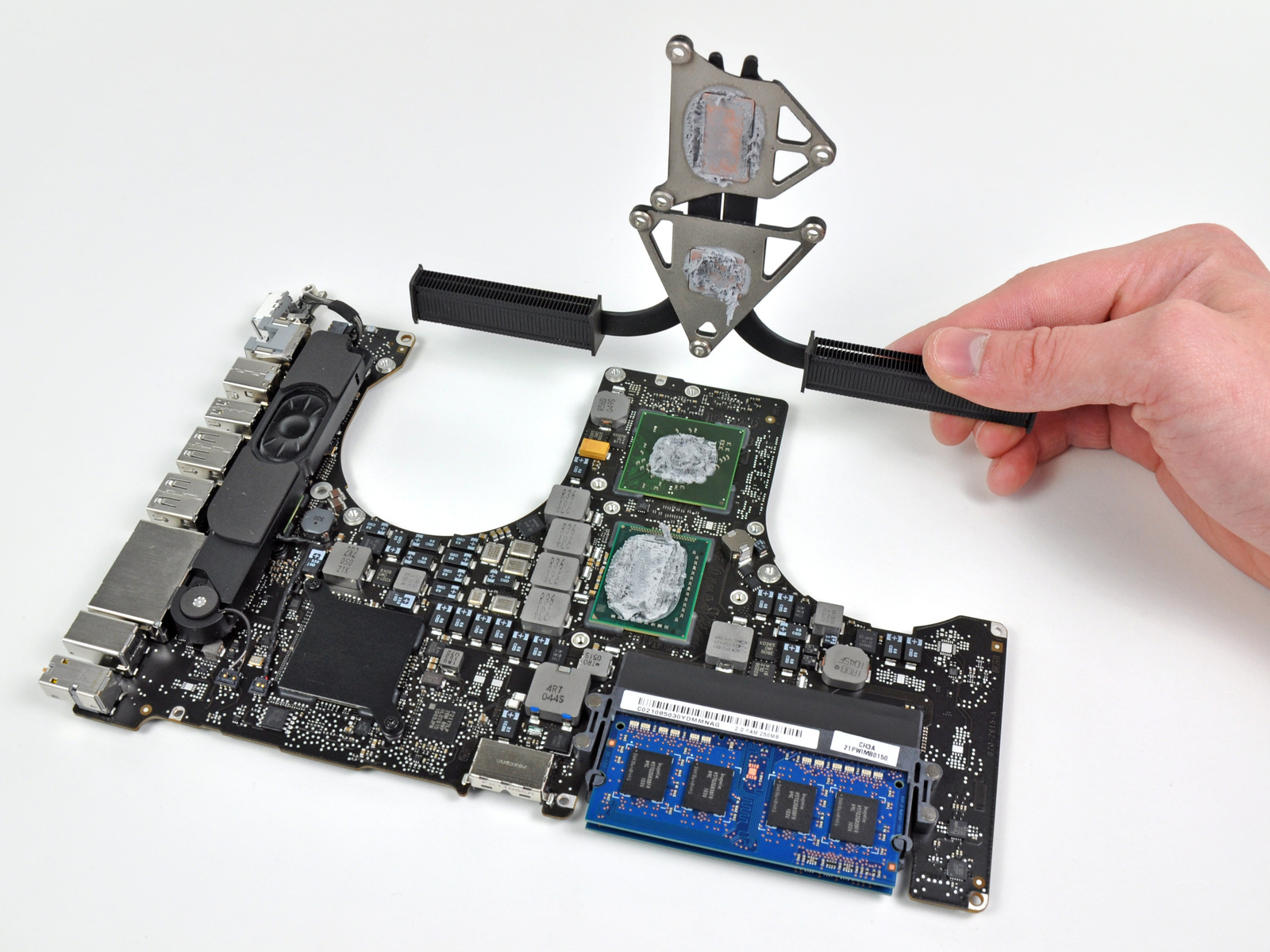

They are right next to each other, effectively heating each other up. Your temps do seem out of the ordinary for a computer simply idling.
Give resetting the SMC a try, and if that doesn't work, I think it deserves a little visit to your local Apple Store or reseller for a checkup.
here's how it works.
let's say ur not using the discrete GPU and the CPU is doing majority of minor graphic related tasks... in this case, majority of the heat would be caused by the CPU and that heat would be transferred to the heat sink... the fan would turn on and cool down the CPU.
now let's say you put it in high performance mode... this would in effective "turn on" the GPU and move the graphic related task to the GPU instead of the CPU, but CPU is still working but not as hard. the GPU will now output additional heat along with the CPU. KEY THING HERE is that the GPU and CPU are on the same heat sink. Once the GPU outputs more heat, and the CPU is no longer doing graphic related tasks, even if the CPU temps go down, the GPU will have already made the heat sink hotter. if the CPU cools down, the hot heat sink will transfer some of the heat to the CPU. (i.e., if the heat sink is 80C bc of the GPU, and currently the CPU is around 65-70C, the heat will unavoidably transfer a bit to the CPU, there by causing the temp to rise = CONDUCTION)
Conduction: Heat spontaneously flows from a region of higher temperature to a region of lower temperature, temperature differences over time, approaching thermal equilibrium.

The GPU and CPU in the Macbook Pro 15's use the same heatsink. Naturally, as the GPU heats up, the heatsink is unable to cool the CPU effectively, so both gets warmer.
Ah! Thank you to you both. This makes a lot more sense to me now that you have explained the heat sink design. I REALLY appreciate the help!
