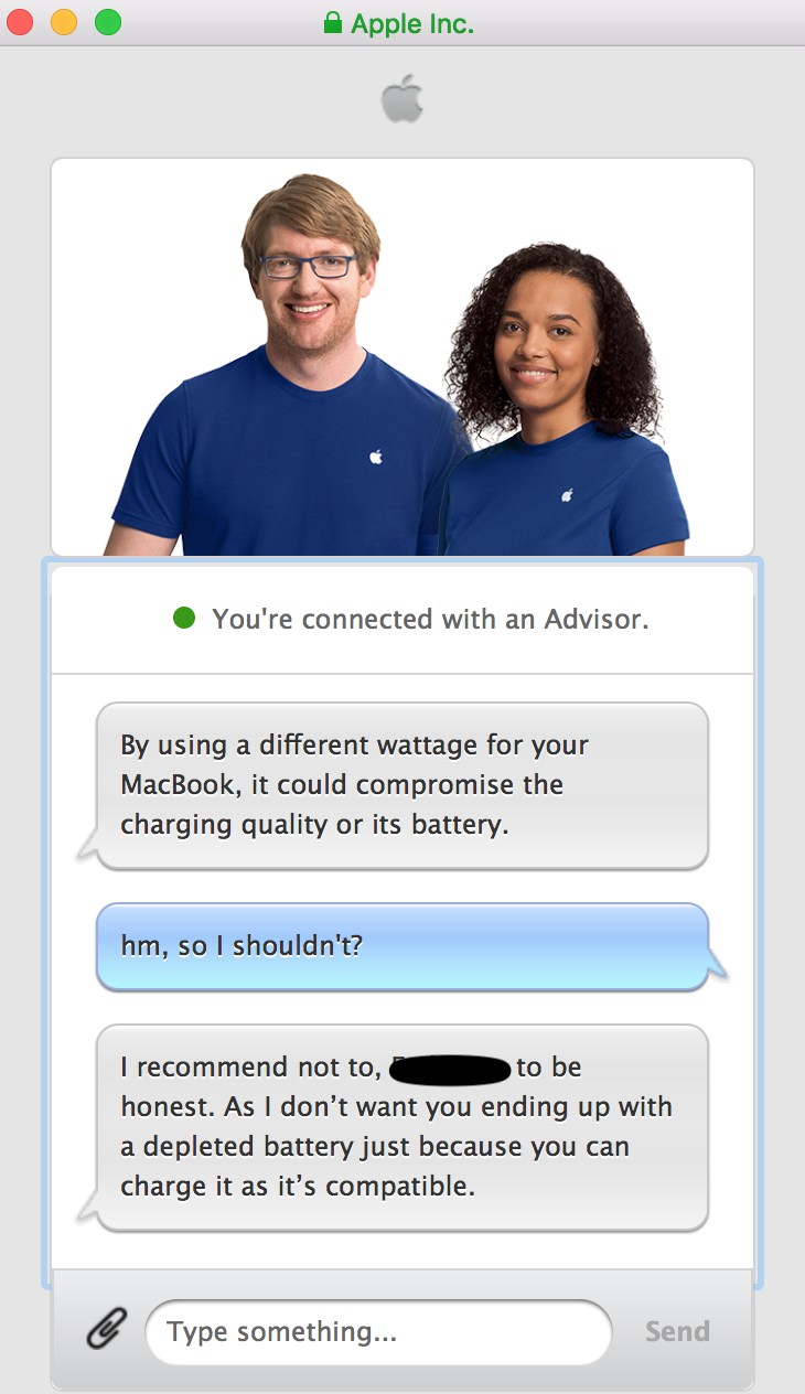

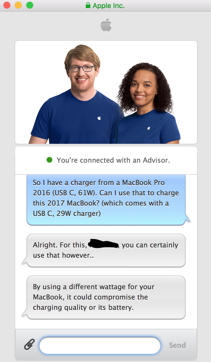

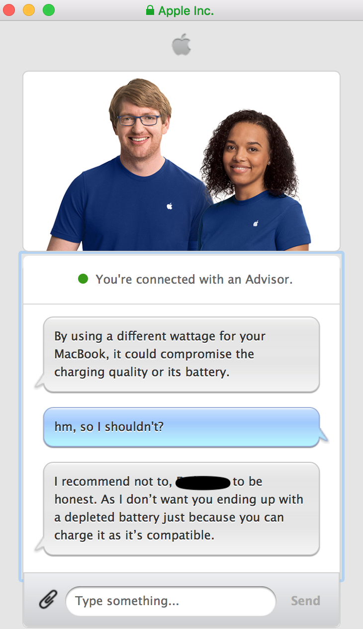

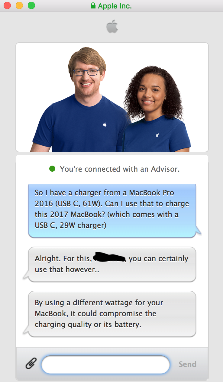

So I am reeding that this is acceptable (like using the 61W USBC included with 13" MBPs). I asked Apple to be sure, and this is what they said. Thoughts?
Screen Shot 2018-03-07 at 2.54.58 AM.png Screen Shot 2018-03-07 at 2.56.11 AM.png
Thanks!

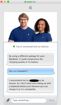

View attachment 753554 View attachment 753555
Thanks!

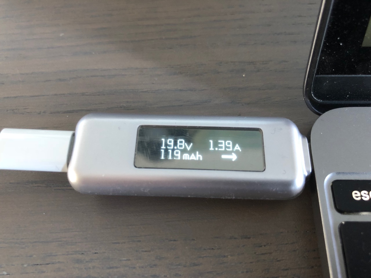

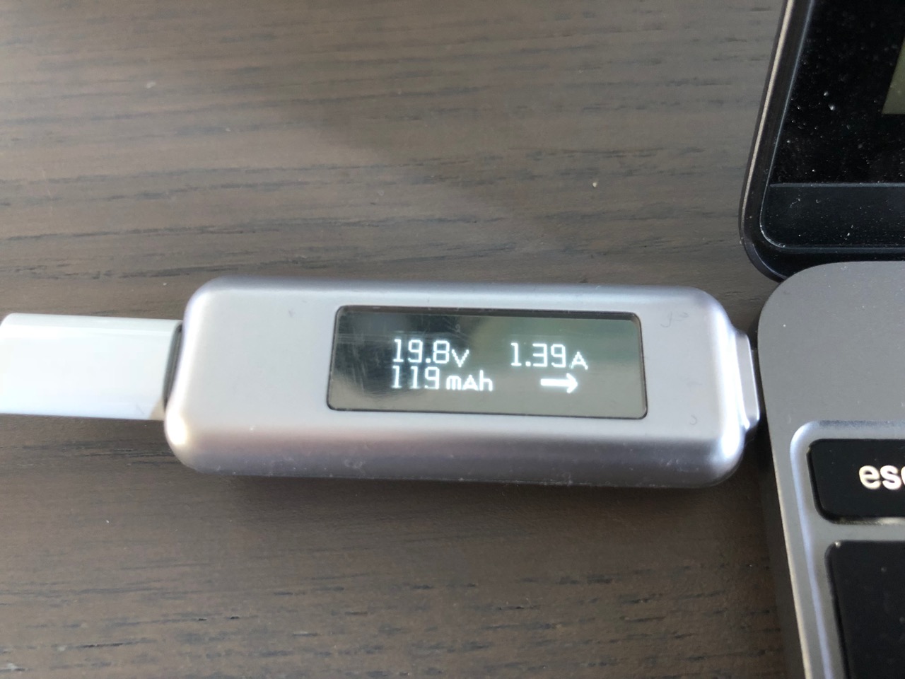

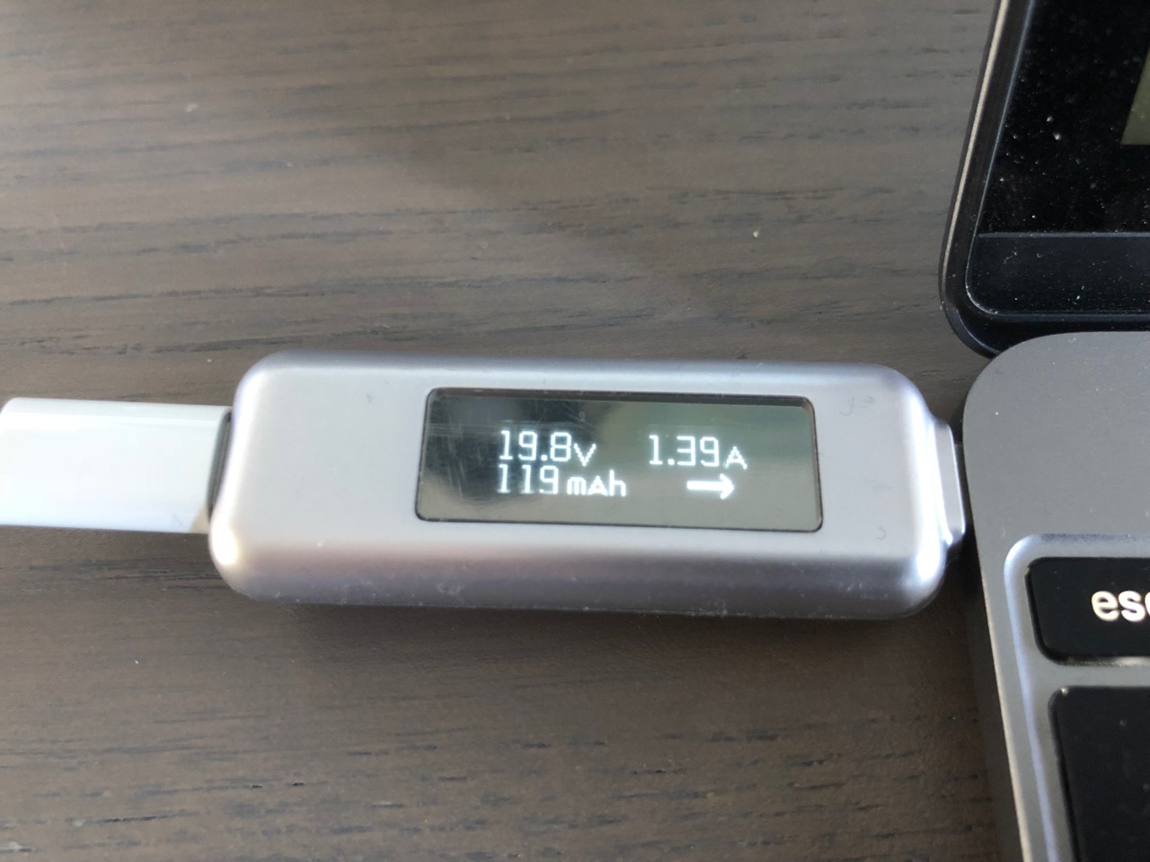

When I reported that my MacBook charges at 30W with my 87W MBP charger I was measuring voltage and current with a Satechi USB meter, not looking in System Information. I am away from home so can't plug in to the the 87W charger to see what System Information reports at present.
Whatever SI says I am confident that the physics of the situation, plus Apple's KB article are correct, and that it is quite OK to use a higher wattage compatible charger.

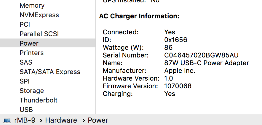

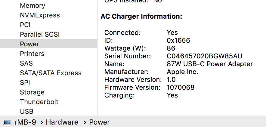

I am back home now and my MacBook is connected to the 87W Apple USB-C charger normally supplied with the 15" MBP.
The only place I can see a wattage mentioned in System Info is in the attached screenshot which confirms that the charger connected is the 87W Apple USB-C charger and the wattage is 86. The other screenshot is the Satechi meter showing 19.7V 1.39A = 27.5W. Coconut battery is showing charging with a net rate of 15W but of course the machine is in use. Without the charger Coconut shows discharging with 7W so the input rate to the battery is 22W. I don't know why the Satechi and Coconut disagree, but there is probably a good explanation and the numbers vary with time. Probably some of the current being supplied to the machine (Satechi) is going somewhere other than the battery (Coconut).
View attachment 754916View attachment 754917

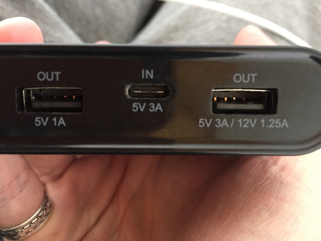

I'm not a fan of them either, but what am I supposed to do when my battery is reaching 50%? I don't want to let the battery fully die on me. I don't think that's good for it.
This is the battery pack I have:
I've been using the 5V 3A port at first, would charge really fast, but noticed that the battery would not last as usual. After switching to the 5V 1A, now the battery life seems more 'normal'. Given the year the laptop has been used.
