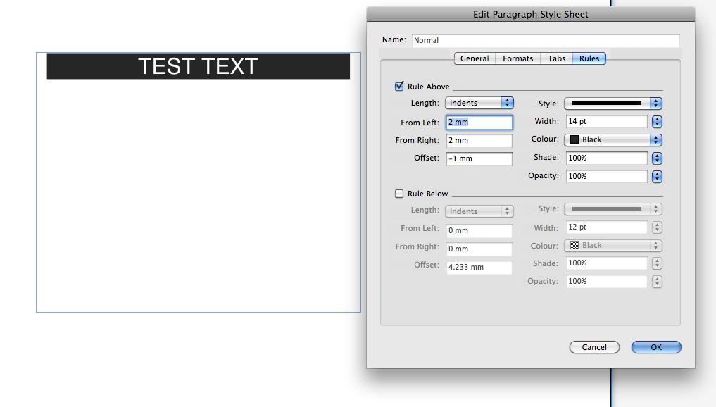

I used to teach an advance QuarkXPress class but now use InDesign. Digging through the course materials I found the following note about using rules in QuarkXPress. I haven't tried it on the latest version.
Rule Above and Below attributes
A couple of basic things to keep in mind when using paragraph rules are:
  • Absolute or relative values can be expressed in the Offset value field. Relative values are represented as percentages of the space between two paragraphs. Absolute values are expressed in any unit of measure. Absolute values require a bit more figuring but produce the most consistent results.
    Remember to remove the default percentage mark.
  • The Offset value is always measured from the baseline. In Rule Below, Offset describes the distance from the baseline to the top of the rule.
    In Rule Above, Offset describes the distance from the baseline to the bottom of the rule.
  • In order to use paragraph Rules as reverse bars, you must use the Rule Above, make a fat rule, and use a negative number (26% of the rule width) in the Offset category. (Example: 14 point rule with 0p3.7 Offset) Set First Line Indent to a few points in the Format window. (Tip: Value fields accept mathmatic equasions so you can type 0p14*0.26 to get 26% of rule width/height.)
[*]In order to use paragraph Rules as reverse bars, you must use the Rule Above
Yes, that's it -- Rule Above -- sorry for the imperfect recollection. It definitely works in Quark 8 with Rule Above:
