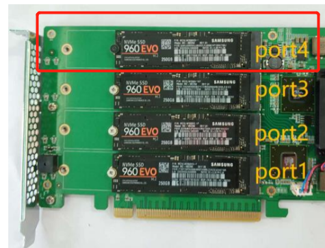

Hmmm. I put a pair of 1TB 980 Pros in my SSD7103 today, and put it in slot 5 of my 7,1. I didn't even install any HighPoint software or drivers, and only one of the two 980 Pros was visible for initialization. Is that normal? Do I need to wait to install the revised HighPoint software to see both of them? I thought the HighPoint 7xxx cards with no drivers installed would show all attached NVMes. Note that per the instructions for the SSD7103, I installed the 980 Pros in the top two positions.
Both should show in disk utility. I suggest checking that both 980 Pros are seated properly on 7103. I’m assuming 7103 is Mac compatible.
Does anyone else think the thermal pad on these cards is too thick? My card has a slight gap between the screws on the NVMe side after I installed the heatsink cover. I hope my 980 Pro didn't bend enough to get damaged. My other NVMe carrier had several pads of different thicknesses, to avoid this issue. Like I say - hope I didn't damage one of my 980 Pros.
Ok - so I purchased a third 1TB 980 Pro and installed it in my SSD7103. Now two 980 Pros are visible in Disk Utility. Noted the S/Ns of the visible NVMes, and opened up my SSD7103 to find it was the 980 Pro in the top slot that was not visible. Also note that I had tried swapping the ones in slots 1 and 2 already, so apparently there was a problem with slot 1 (top) and not with that 980 Pro. I moved that 980 Pro to the bottom slot (4) and booted to find all 3 visible.
I've asked HighPoint support for advice, and if they have RAID drivers that are stable for us yet. FWIW - I found a YouTube video where a guy says he installed 4 NVMes in his SSD7103, and only 'saw' 3 of them until he got updated firmware from HighPoint. The plot thickens...
If I remember correctly, on the SSD7103 the top M.2 slot and the Marvell 88SE9235 SATA controller on the back, that provides RAID boot support for PCs, both are connected to the second PLX switch and not to the main one.

I contacted HighPoint on Thursday, asking about why I don't see any NVMe in the top slot, and I asked if the software version I had was the latest. They requested clarification of the NVMe/slot issue on Thursday, which I provided. I have not heard from them since.
Based on the entry above, I decided to try installing the HighPoint software, and it appears to be working (so far). I successfully created a RAID 0 from my three 980 Pros, and I have been using my Mac since to try and determine if it is stable. So far, so good. The only thing I have noticed is that the RAID volume does not appear on my desktop until after all of my startup apps have run. That makes me suspect the my next test will fail - using CCC to clone my startup volume to the RAID, and starting from it. I'll let you all know...
In case anyone is curious of the speeds I'm seeing - I initialized the three 980 Pros first with APFS (I know - the older format is faster) and then the RAID with three 980 Pros. I need APFS if I want to try making the RAID volume bootable.
Tried an Option/Boot to see if the RAID volume shows up, and it does not. Guess I'll have to try HighPoint Support again, although they still have not gotten back to me on my first issue (slot 1 not visible in SSD9103).

Meantime - I decided to buy a fourth 1TB 980 Pro to see if it works in the top slot of my SSD7103, and it does. I deleted the old RAID, and created a new one with 4 instead of 3. Interestingly, HighPoint claims it makes no difference which slots you install your NVMes in on the AAD7103, but clearly it did in my case. The printed instructions I got said to install starting at the 'top', but Support sent me a picture showing the number 1 slot is the one at the bottom of the card, so apparently you should install from slot 1 to slot 4. They also tell me it is not bootable at this time, but that it should be again in the future. They want me to keep them posted on my testing.

Incidentally, my RAID was not mounting occasionally (4 - 5 times in the three weeks I had it). I told HighPoint that each time it failed to mount, the WebGUI showed 1 of the 4 980 Pros in my RAID was disabled - always the one in slot 4 (top). I tried swapping different 980 Pros into that slot, but the problem persisted, and HP eventually gave me an RMA.
They were unable to find any issue with that SSD7103, so they were going to return it to me. I told them to keep it, since it was no use to me as it was, but they finally decided to send me a new one and they say I get no support with it, so I guess I'm on my own now.
I will see how that goes...
