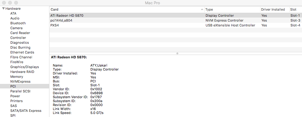

I then totally cleaned, de-dusted & applied new thermal paste to my HIS HD 5870 which previously was showing a Link Width of X 8 in PCIe slot 1 ..
Hit the power button . ..
Voila !
it now shows " X 16 @ 5.0 GT/s as it used to.
PCIe slot 1 HD5870 x 16 at 5.0 GT:s.jpg

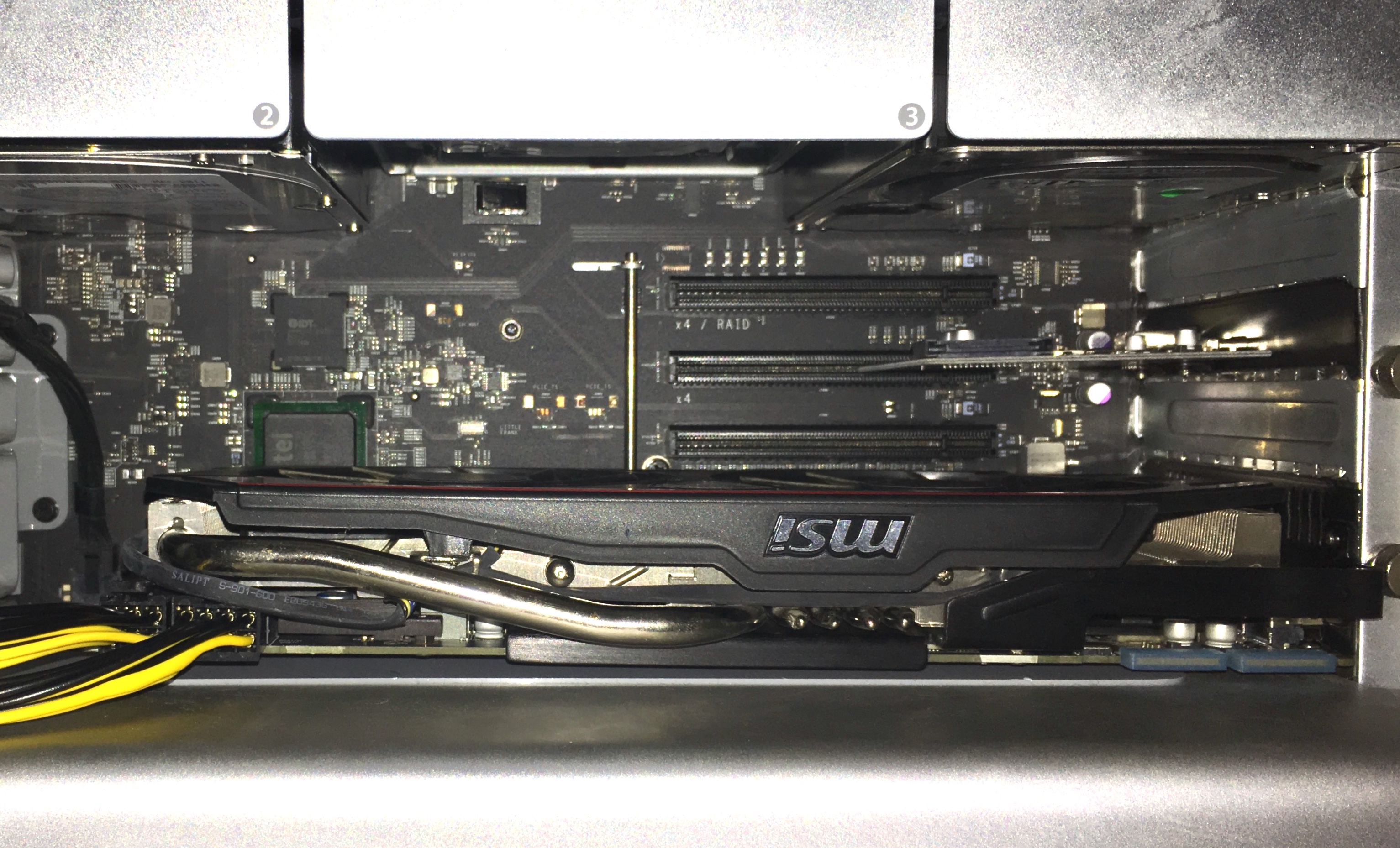

Off topic : Does anyone know if the MSI Gaming R9 280X 3 gb allows access to PCIe slot 2 ?

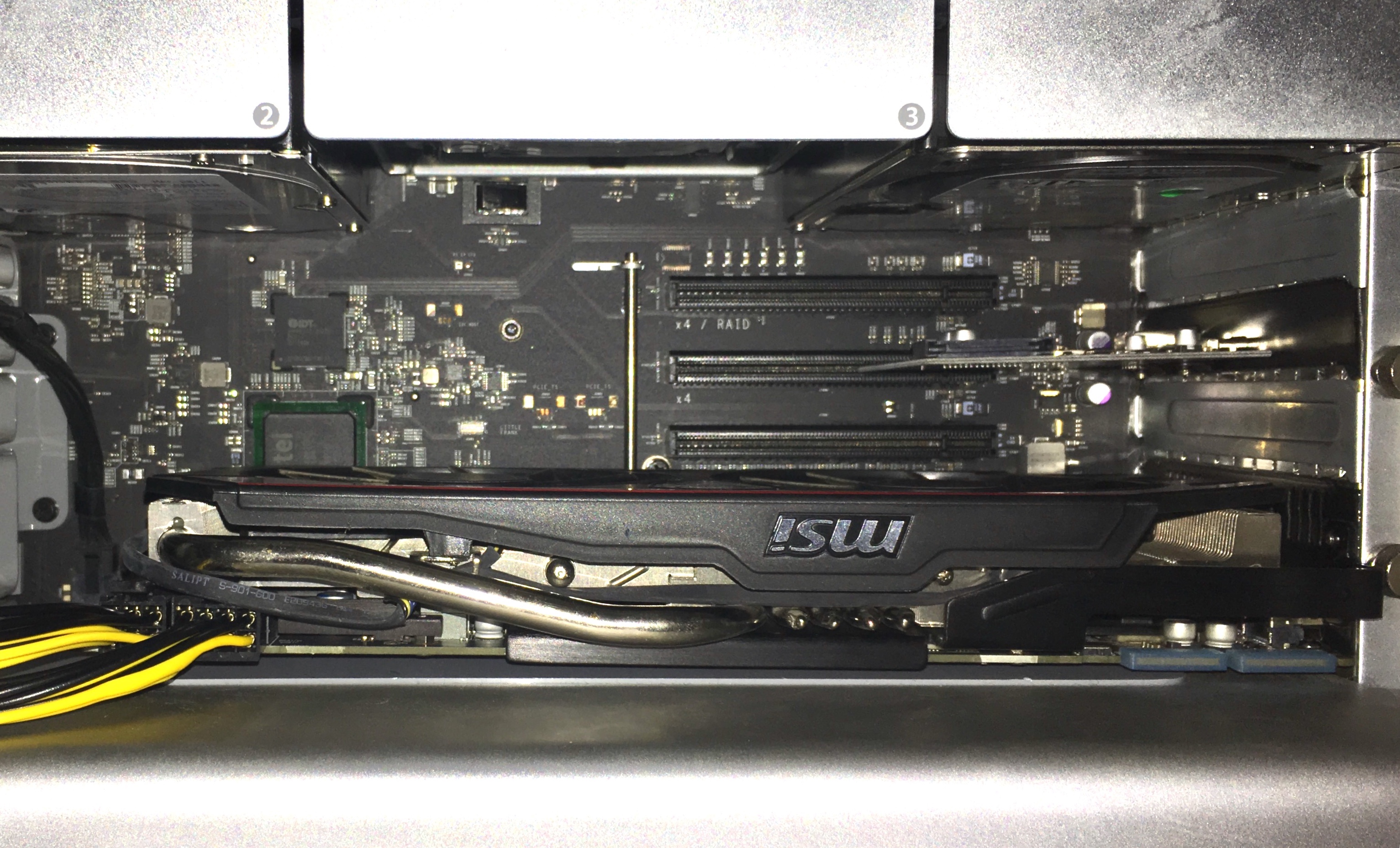

If you mean the Twin Frozr then you have access to slot 2 but it will block one of the intake fans. I've taken a pic of mine so you can see.
