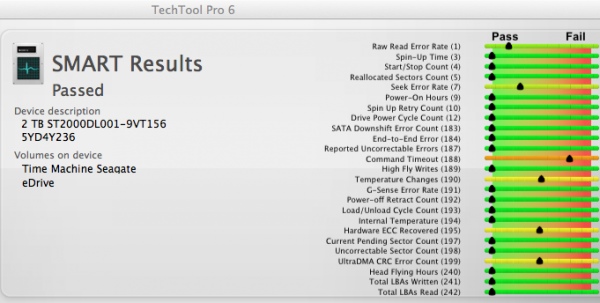

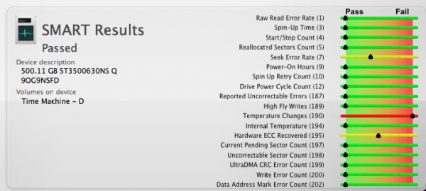

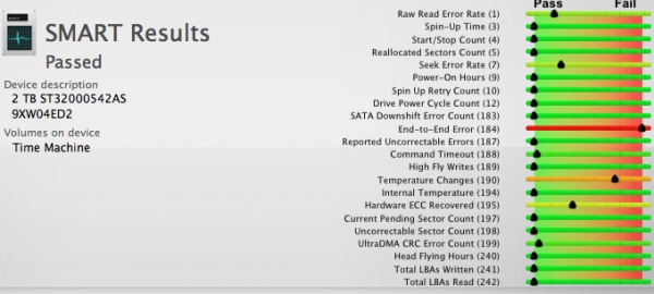

That the drive is overheating causing it to look like this is the normal culprit. These are typical screen shots out of the hundreds I've pulled from these during a school district contract. Most passed SMART. Not one was good. These were all between 3–5 years old. The one in that iMac is 11.
The cause of the heat problems is the HDD. These run extremely hot in the late 2009–2012.
