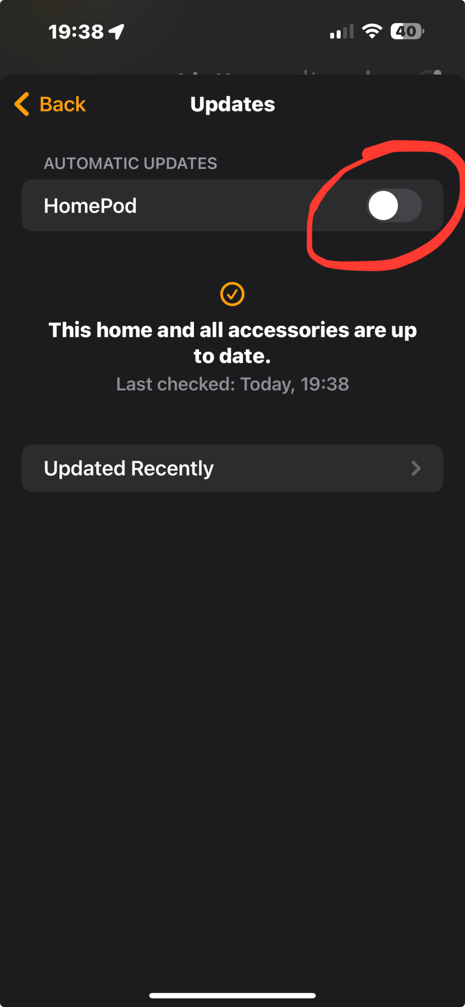

For the next update (17.4), disable auto updates on the HomePods and update your hardwired ATVs first. I’ve had luck with this for keeping them as the active hub.

All my devices are up to date, but I always do my ATVs first now. In HomeKit settings, you can disable auto updates on the HomePod. After I update my ATVs, then I do the HP’s one by one.

Nah, I update them, mostly in hopes that every update will fix the awful Siri on them lol.
There was an issue this OS cycle where the HomePods got an update and the ATVs didnt. Think it was 17.1.2 or something like that. Biggest mistake was doing those HomePod updates. My HomeKit was pretty much unusable for that month or two waiting for 17.2.
