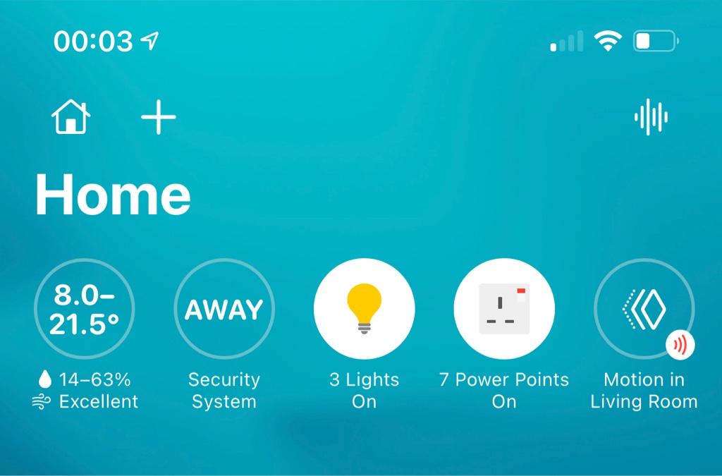

Your Security System shows you are away from home and the Motion Sensor in the Living Room shows Motion. 🙂
Hope you didn't get burglarized while we are discussing HomeKit shortfalls...........
Haaa. No that’s the ring doorbell via HOOBS. I never change it because I want it to always alert me
