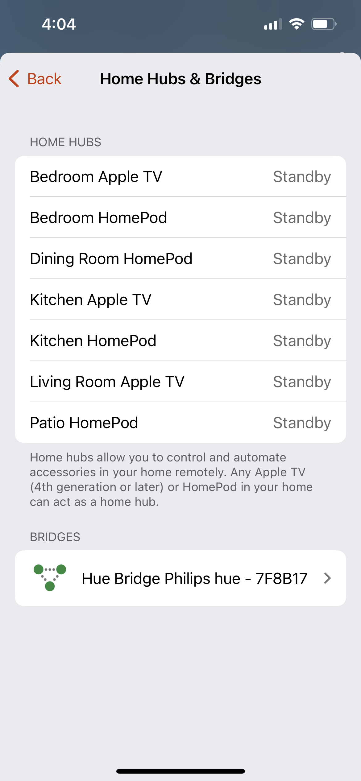

Here's what's showing in the Home App on my iPhone for Home Hubs:
The Bedroom and Dinning room HomePods have already been power cycled multiple times today. I've rebooted the Living Room Apple TV twice too. I also removed both of those HomePods and added them back. No change.
They ALL still show Standby. I can't get any of them to show "connected".

These solved the problem with a Home Hub not being active:
It is beyond IDIOTIC that rebooting or power cycling a device does not restore its functionality as a Home Hub.
So you had to toggle the Home Hub setting on each device to get it working?

I only needed to toggle the home hub setting in ONE device (my Apple TV 4K in the Living Room). There's no need for more than one Home Hub.
