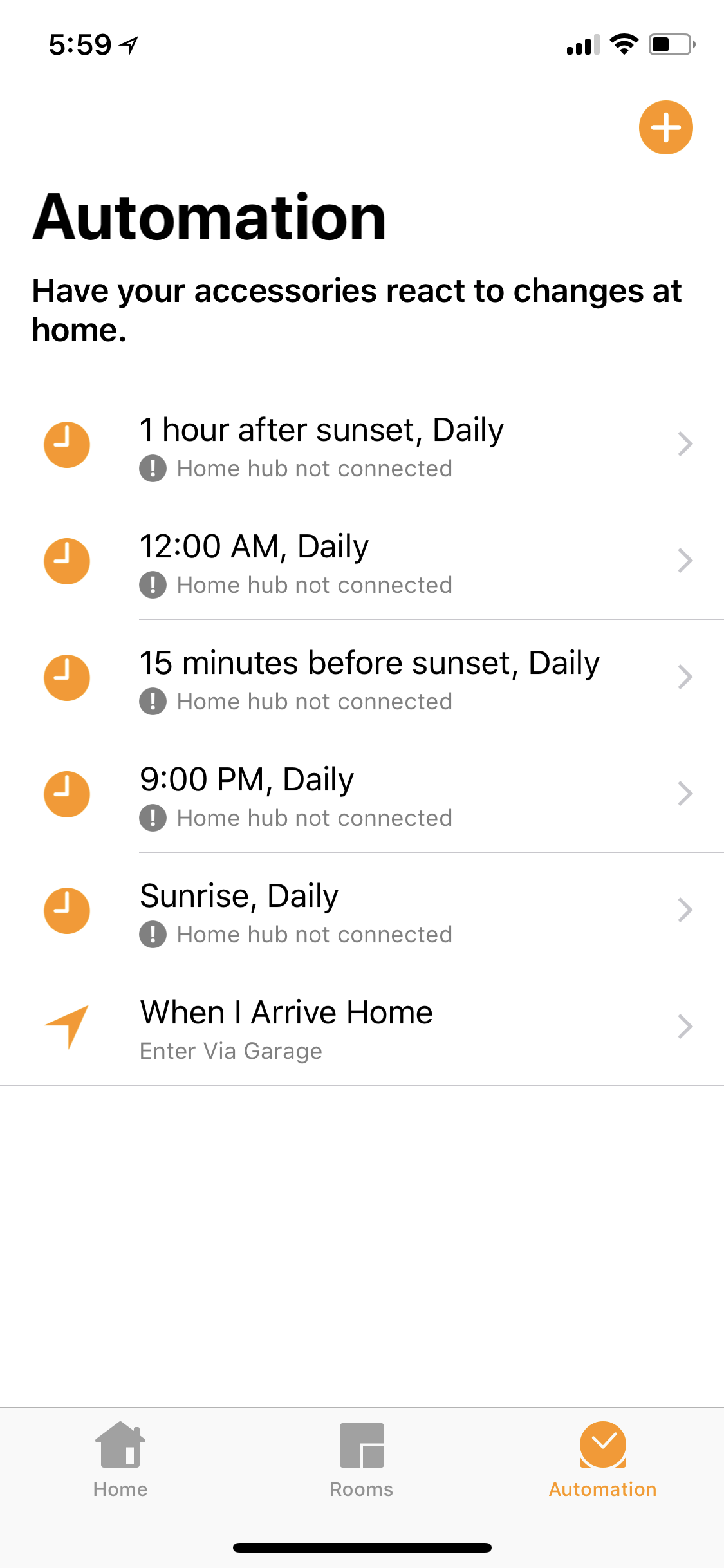

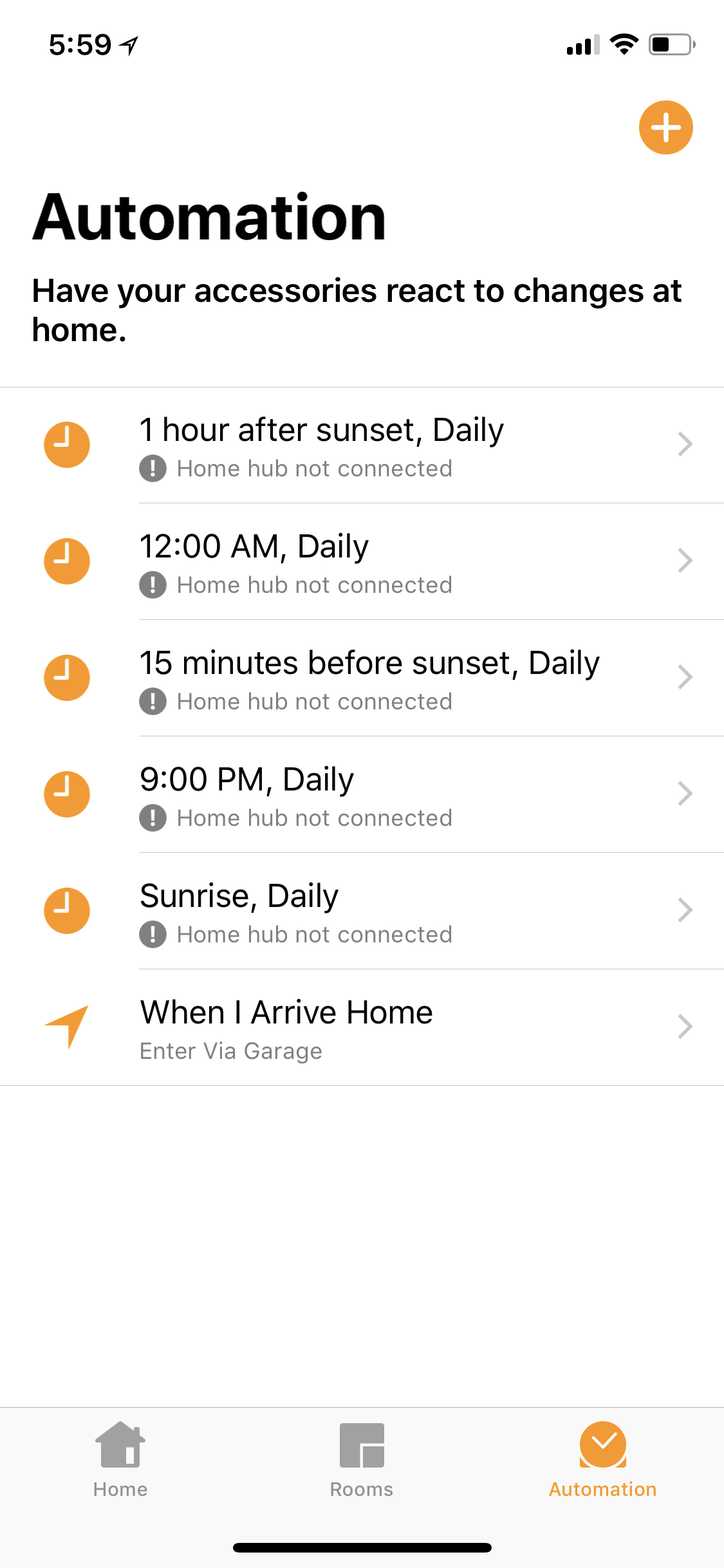

I have been using HomeKit for months now with no issues. I have four Apple TVs (and now a HomePod) serving as 'hubs'. I have multiple scheduled automation tasks that worked fine.
Recently, however, the automation tasks are not running, and underneath each automation task I see the message 'Home Hub Not Connected'.

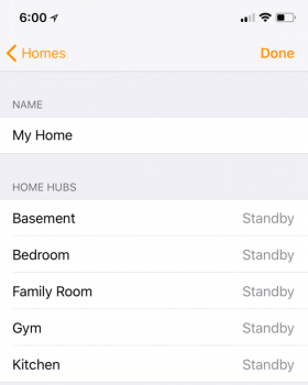

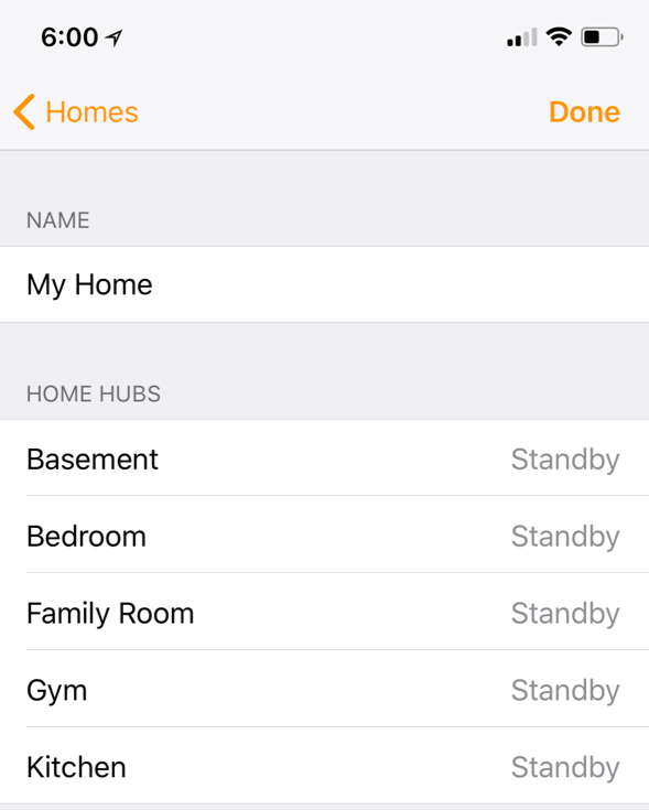

When I look at the list of hubs (under Home settings), all 5 of them are listed in Standby.
I've tried rebooting and upgrading all ATVs to latest release but still no luck.

Update - logging out and back in to iCloud on the Apple TVs seems to fix the problem. For a while, one of the ATVs shows 'Connected'. But after a couple of hours all the hubs are in 'Standby', and none of the automation works. So frustrating.
Make a note of which one is listed as connected. The next time the problem occurs again disable home for that one. Then see if everything continues to work. Basically narrow down the problem, one device should remain connected and if there is an issue another one should take its place however I’ve found “switch” to not always be reliable.
UPDATE: I think I fixed it (in case anyone else has this problem).
I set the 'Sleep After' to 'Never' on one of my Apple TVs. I then logged out and back into iCloud from that ATV. It has shown 'Connected' ever since. I suppose I could disable sleep on the others but it probably doesn't matter at this point.
This is still obviously a bug, because even when all the ATVs go to sleep it doesn't 'promote' the HomePod to be the active hub.
Post back if it happens again. I have both of my Apple TVs set to sleep and its never been a problem. Although ever since I got the HomePod that is always the device it defaults too as the connected device and that doesn't have a sleep option.
