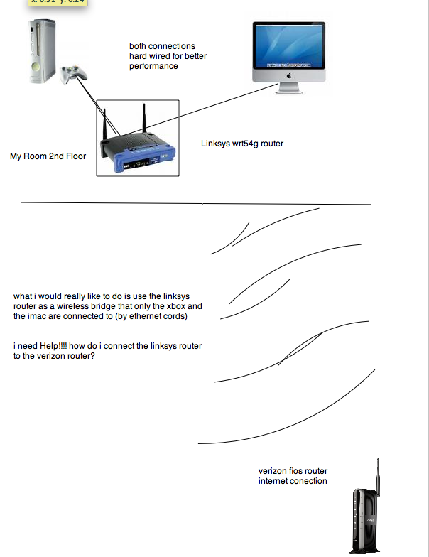

so i need help this is what im trying to do! tell me if its possible and if so i would really love some help...

Why do you want to hard wire the two devices? You'll lose any performance gains if you then go wifi to get from the linksys to the modem. You're better off just connecting everything to one wireless network I think. If your internet connection is less than 54mb, it'll be slower than wireless anyway so hard wiring won't make a difference (apart from transfers between the mac and the xbox).
I just got fios ... last night actually. They brought the same router. Since I got it for internet only, I just called and asked them to enable the ethernet in the box outside the house. Then I can just run that to my current router (airport extreme).

the reason i want to do this is becuase the xbox 360 wireless adapter SUCKS ask anyone... its a ****ing joke. but if i could do it this way it would work 10X better than the wireless adapter that im going to have to buy for 100$ (which its not worth)
what you want to do is possible, but I don't know how to set up that feature with a Linksys router. I've done it using a Dlink and an Airport Extremee, as well as a DLink and DLink. However, just note that as one poster above mentioned, your speed between the linksys and xbox (or linksys and mac) will be the same speed as the fios wifi. They wont have a wireelss speed because they'll still have to go over the wireless network...
You are going to need to create WDS (Wireless Distribution System) link between the Linksys and Verizon FIOS routers.
The problem is WDS is not in the 802.11g/b/a specification, and its implementation is optional for router makers.
You need to find out if your Verizon FIOS router supports WDS. Go to its setup page and look around.
The Linksys should support WDS with the latest firmware update. Otherwise, you could always install a third-party firmware like Tomato on it to enable that feature.
In general, WDS is a complicated mess with two routers that aren't the same brand.
Good luck. On a side note, Apple has been using WDS for years. If you had an AirPort Extreme Base Station, an AirPort Express and a wired switch this process would take around 10 minutes.

yeah that would be great but i dont have 200$+ to spend for a wireless network...
Indeed, configuring a WDS is the solution for your question.
i've tried connecting a linksys to an apple extreme, to no avail. I can only recommend, google is your friend and find somebody who did it on the net and documented it.
Let me help. Buy a Linksys WRT54G and go to this site:
http://lifehacker.com/software/top/hack-attack-turn-your-60-router-into-a-600-router-178132.php
Have some patience and get the DD-WRT firmware installed on the router, I give you my assurance that all it requires is some concentration and the ability to follow directions. No technical skills required.
I am not sure what $200 wireless network you are talking about but all you need is a wireless router and you're done. $80 max.
