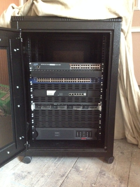

One other piece of advice: label everything. I've just started the in-cabinet wiring for my network and labels are slowing me down now but will be invaluable later...
