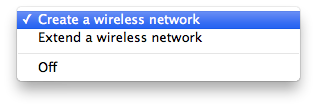

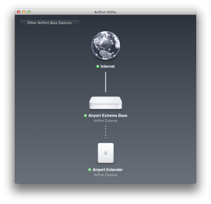

I don't have a time capsule and an extreme to test, but I can set my extreme to extend a wireless network. I would imagine you can do the same thing on a time capsule.
I use an Extreme as my main router and an Express to extend the network with the same SSID so that devices can roam seamlessly between both networks.

What you're looking to do is called a "Roaming Network" in Apple's vernacular. This is the ideal way to extend a network between two AEBS/TC devices since you'll get maximum throughput between devices connected on opposite routers.
Here's the Apple KB on the subject.
That looks like exactly what I need. Thank you! Hopefully the devices will know when to switch between the base stations.
