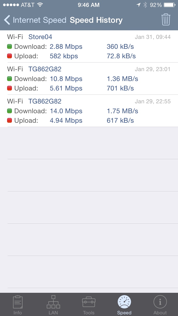

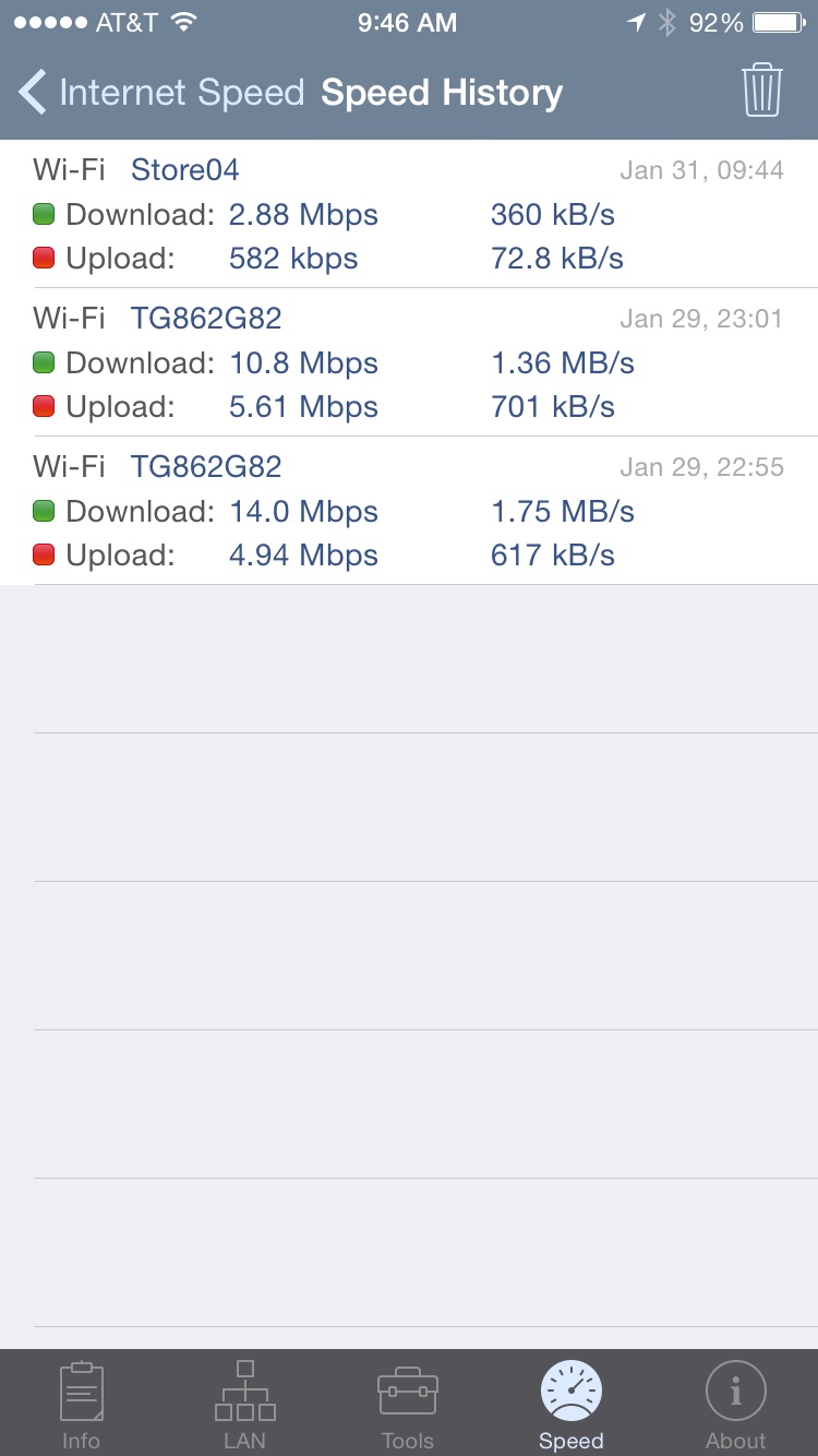

Well I downloaded a mobile version of wi fi explorer. It turns out it is not much help if you don't know what the hell you are looking at. I did find it interesting that is clocked my home network at much less than 30 megs. That said it is signifigantly faster than my work wi-fi which has zero lag.

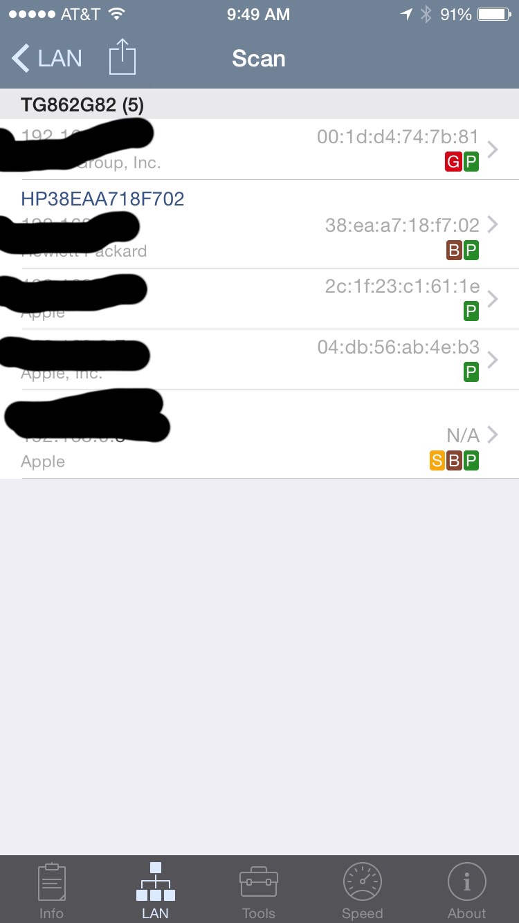

Not sure if this helps much. I think it just shows what is on my network. I ran another test but it did not save. I will re-run it tonight and post it here.
I am going to assume that those three items are devices not names of a network correct.
