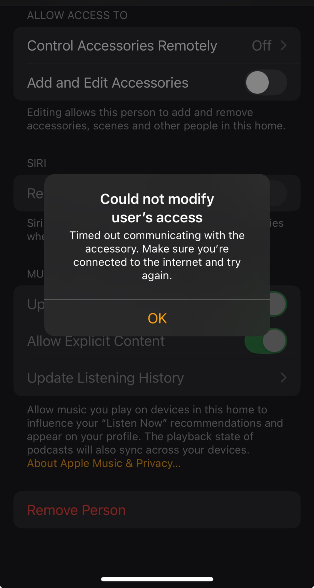

As in the title. I've shared access with someone (marked as Resident) owning an iP when they stayed in my home, to be able to control my Philips Hue (via Philips hub) lights from the Home App, with myself being the Resident (owner).
At one stage outside my home they were able to see what lights I had on and when, until I unchecked "control accessories remotely" for them. Trouble is that I often get a notification that "Home Hub is not responding"...but so does the other person.
When I do bring up People within Home and have the option to "Remove Person", the following message appears every time:
So ultimately I would like to delete this person entirely but Home isn't letting me do this. Any ideas would be appreciated.

have you tried re-enabling remote access before you delete them?
I cannot believe this actually worked!!
On one hand I think I should have admin privilege to delete no matter what, but on the other hand I'm thinking it needed this connection on their end to allow me to delete on my end?
