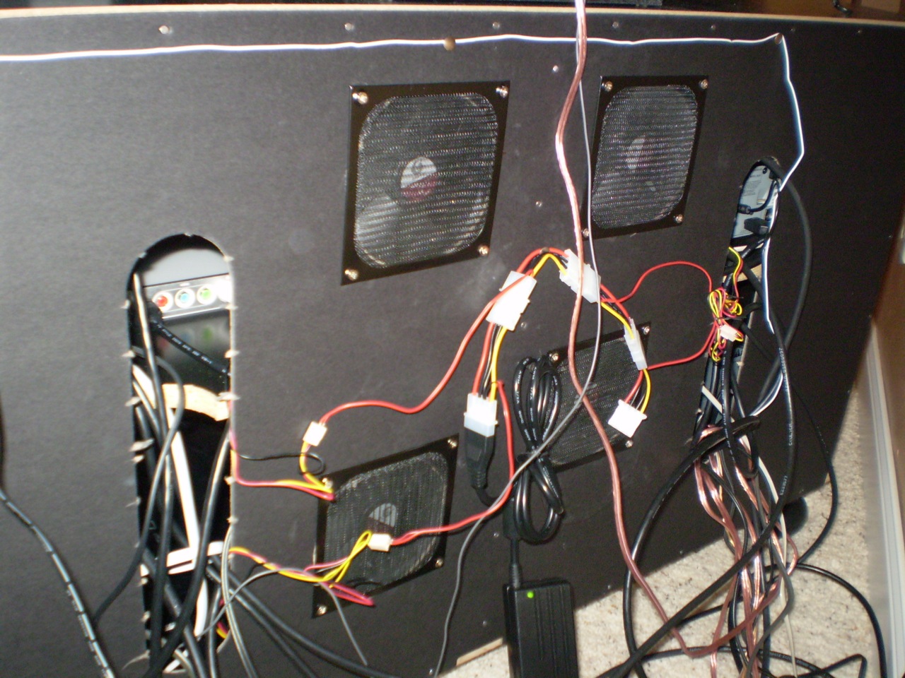

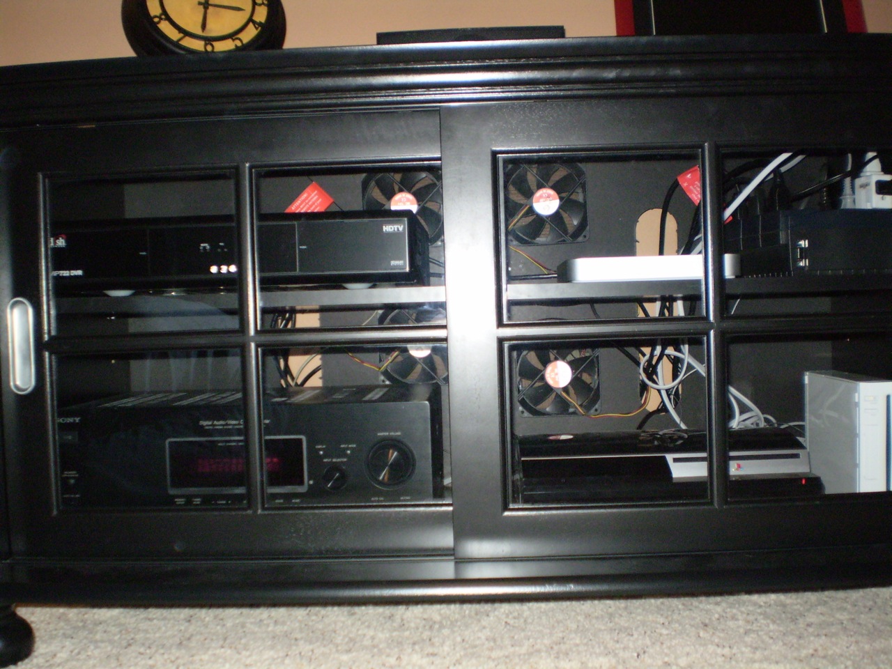

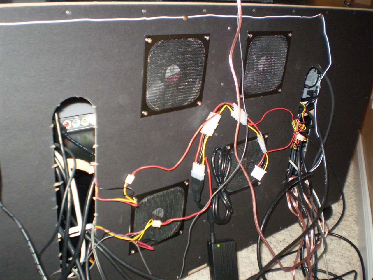

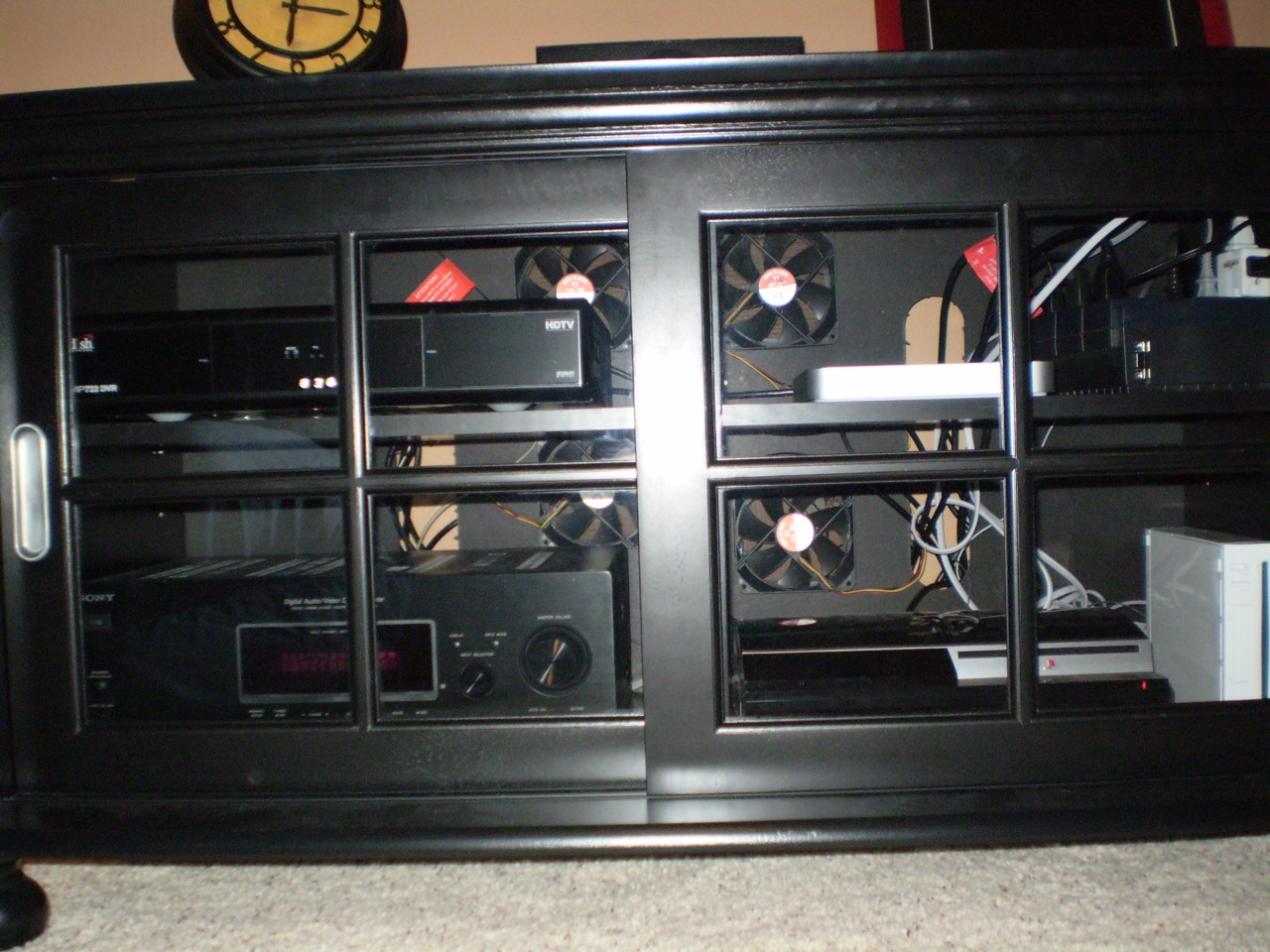

I have 4 120mm computer case fans in mine... running them at 5V, practically silent, and I doubt they are using much power.
