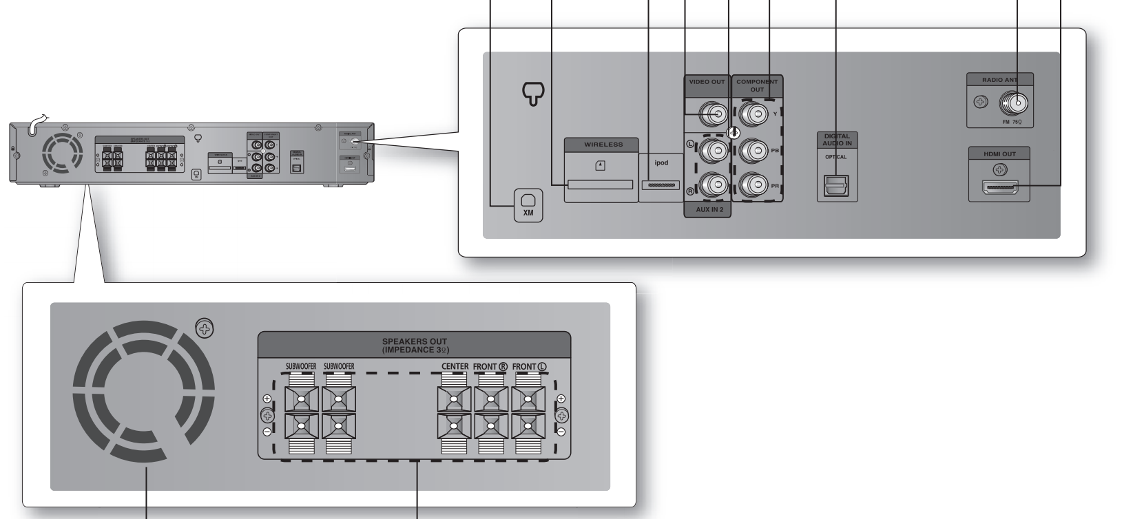

OK, and this is these are the ports on the Samsung:
So you're using the AUX 2 analog in from the TV, and the only other input is the TOSLINK, and you said, you're not getting digital audio out from the TV. You've checked all the output options in the TV menu? I'd definitely root around in the menus (like someone mentioned above), maybe see if there's an HDMI setting for the audio.
If it's not working, it's like the HDMI port is passing the audio to the DAC in the TV, and losing the digital signal (like it's not "re-converting" it for TOS output).
If you're having that issue, you could maybe use something like this:
It's extracts the digital audio out via optical, and passes the HDMI signal through, so it would be like:
Chromecast >> HDMI Box >> TV
and
HDMI Box >> TOSLINK >> Samsung
