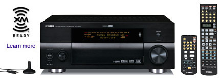

7.1 Channel Digital Home Theater Receiver
http://www.yamaha.com/yec/products/receivers/RXV1600.htm

I'd choose something besides the Yamaha receiver. I had one. It was fine, until it broke(the surround processing would fritz out). Which I think is kind of ridiculous for a receiver to do.
I highly recommend Denon receivers. They are generally in the same price range as Yamaha and are rock solid, high quality components. Seem to be better build quality too. If you want to step up, NAD or Rotel make some really nice receivers.
A comparable Denon receiver would be the 3806 (or 3805, which is last years model). Which from what I can tell is basically the benchmark in that price range.
I too would go for a comparable Denon receiver. While the Yamaha's are great for the price, they tend to be built from cheaper parts. They are also a bit bright sounding especially when playing music. Denon's are very warm sounding on the music end. But for 7.1 or 5.1 I give Denon the edge as well.

1. Denon has a 2807 (new) receiver that it hasn't yet made available for sale (some time in March '06), but the specs are on Denon's site: http://usa.denon.com/ProductDetails/3038.asp Most notable is 1080P HDMI support (many receivers don't carry HDMI and those that do often offer 1080i only.) This will UPCONVERT analog, s-video, and component video to HDMI. Bad-ass!!

That's an awesome new Denon model. The HDMI switching is extremely valuable and even the iPod connectivity is a cool throw in. Denon receivers are better IMHO.
Ya, that Denon is looking pretty sweet, wish it had atleast a low level THX mode though. Reliability is a plus, my last Yamaha did blow a channel, and hearing others have that experience reminded me of that. The 2807 is at my top of the list.
