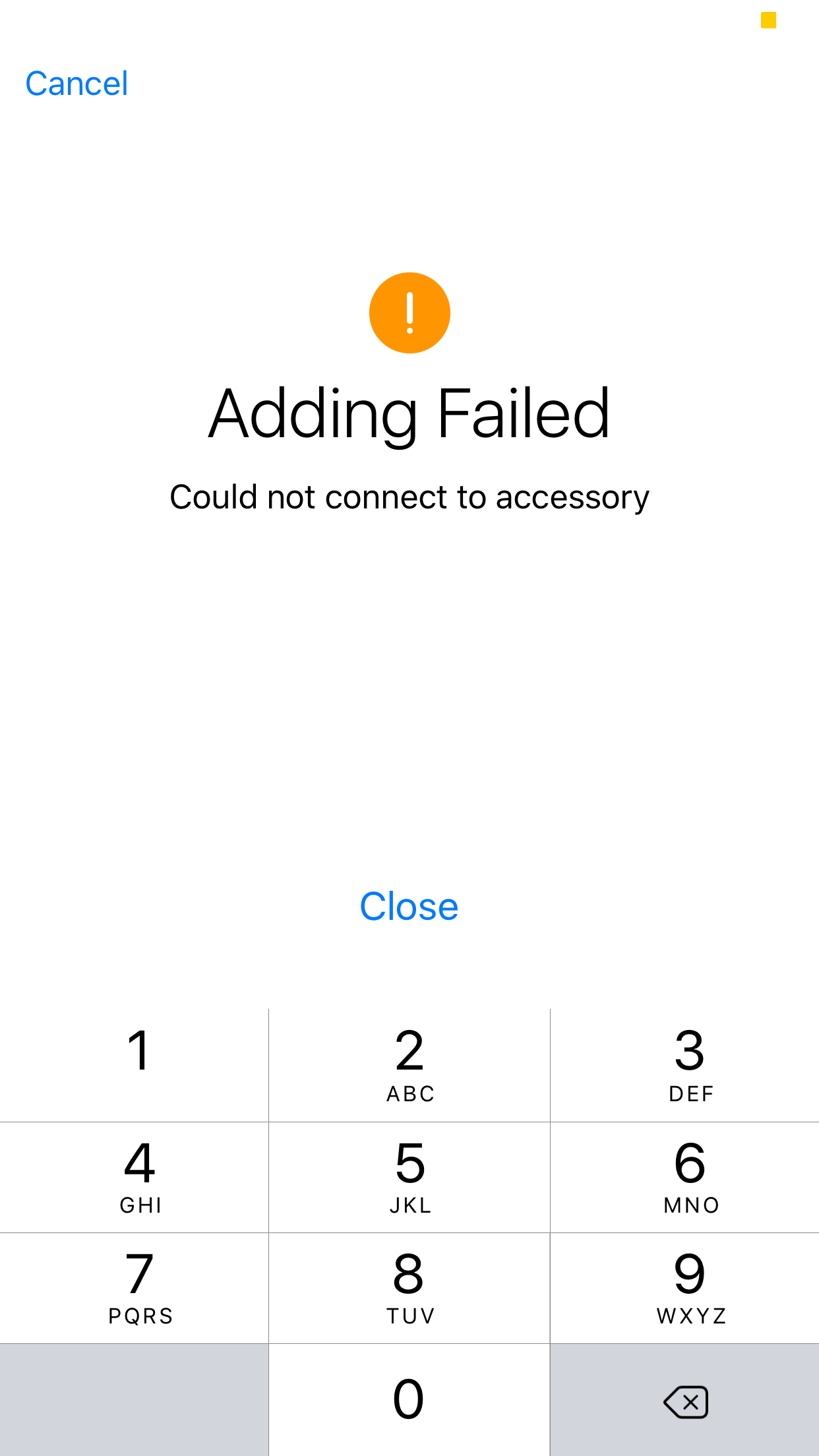

Disaster!
My Homebridge has stopped working, couldn't get it running on my Rpi so did a clean install of everything (Raspbian noobs) and a fresh install of Homebridge.
Using the HMCatalog app or the Insteon+ app, Homebridge is discovered, but when I try to pair with it using the pin it fails.
I've tried running Hombridge on my MacBook,
Using a different iPhone/iPad.
Deleting the Homebridge persist files.
Resetting HomeKit configuration.
Logging out of iCloud services.
Rebooting all devices.
Using a different iCloud ID.
Using a brand new iCloud ID.
Rebooting my router.
Factory resetting my router.
Unplugging/disconnecting as many other devices from my router that I can.
Anyone else seen this error?
I'm running out of options now!

I'm not sure if this fell into one of the steps you already tried, but if not, FWIW:
iOS device has gotten your Homebridge username (looks like a MAC address) "stuck" somehow, where it's in the database but inactive. Fix: change your username in the "bridge" section of config.json to be some new value.
Reactions: Recognition
Try this(at the same time)
Reset the homekit configuration in iOS
Delete the presist folder on the .homebridge
Restart rpi
Restart the homebridge.
If this dont help i am sure it has to do with the recent change in homebridge to support latest ios beta. Let us know if this helps.

Thanks all, I've tried combinations of what you've suggested but not necessarily in that order!
I've wiped my Rpi already and will do a fresh install of Homebridge on it tonight with both your suggestions.
The problem started when I tried to update Homebridge npm to work with iOS beta.
I think I just did 'npm -g update' and missed of 'Homebridge' from the end.
After that when I tried restarting Homebridge the terminal would just say "command not found" or something similar.
I guess I accidentally deleted part of Homebridge and screwed up everything else!
Really hope I can get it working again, it was so handy to have!

No luck getting my iPhone to add the Homebridge using the methods you suggested.
I did try one thing though that did work.
I ran Homebridge on my MacBook Air and used the the iPhone simulator and the HMCatalog app and it connected and paired! I was able to control my WeMo switches and Nest thermostat through the simulator.
So that leads me to believe it's my iPhone that is the issue?
My iPhone was running ios9.2.1 so I've installed the latest public beta. Hopefully this will work.
Just re-installing Homebridge on my Rpi now...
EDIT:
Success!!
It works again! Looks like my iOS version (9.2.1) was not connecting to the Homebridge, (I understand that it uses Apples Bonjour to communicate?).
Updated to the latest public beta (out today) and it lives!
Just tentatively re-populating my config.son file one plugin at a time!
Hopefully now more issues for a while.
I can finally sleep easy (the wife will be pleased...!)
Thanks for your help!
