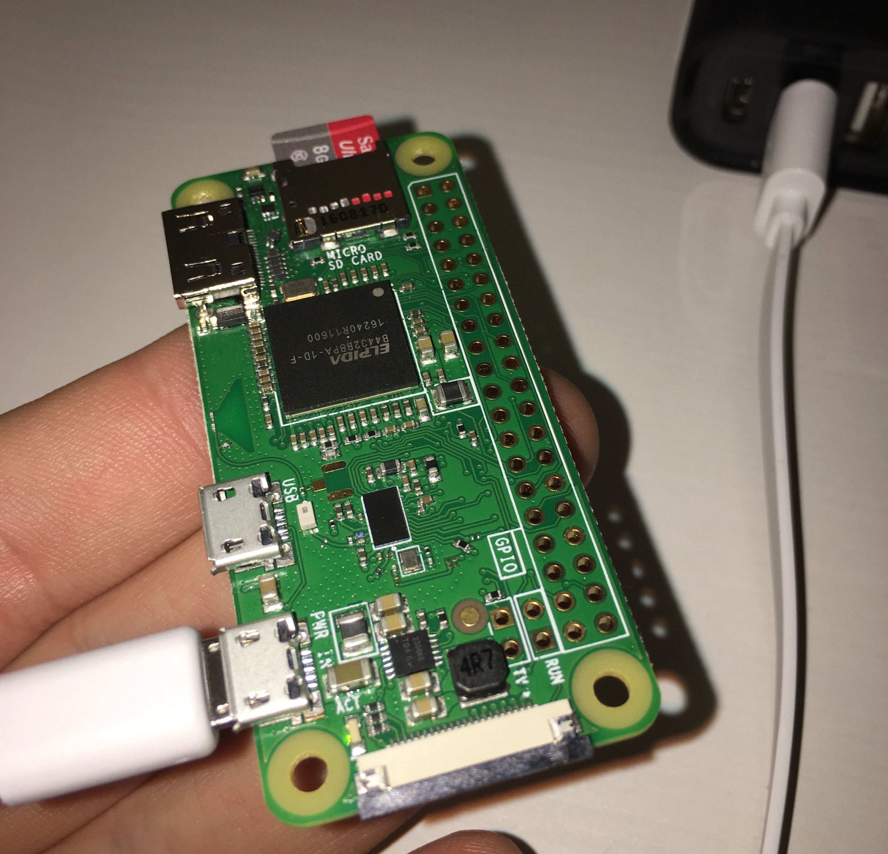

I’m using a raspberry light zero w. I don’t need to run anything demanding (like ffmpeg for video), so the pi zero works great. To be honest, it’s almost identical to using a Mac. The configuration is nearly identical, I think.
Here’s my setup (attached photo)
At one point I did have ffmpeg running on a raspberry pi 3, and added the stream to HomeKit using homebridge. I stopped doing it because it wasn’t powerful enough. Had too many issues with freezing and low quality.
