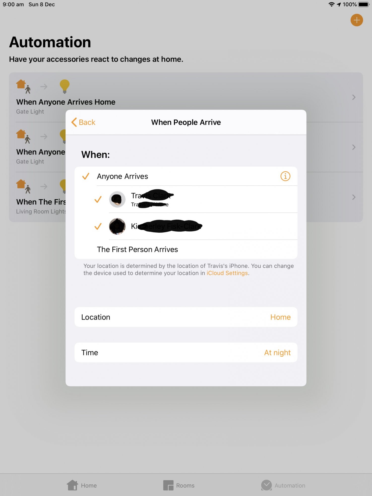

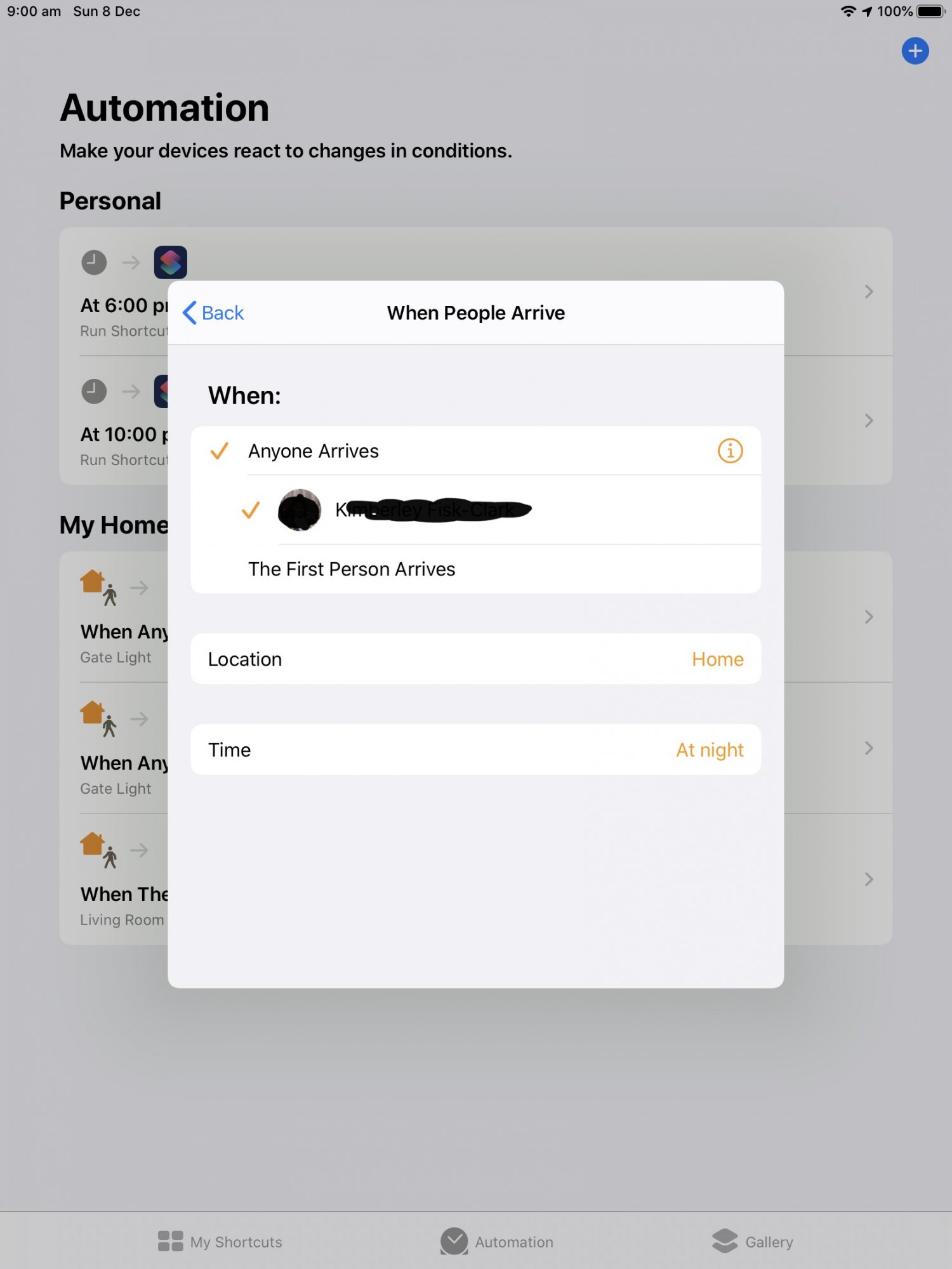

i have an issue with time based automations not working.
I found one issue for my location problem, but I am unsure how to fix it.
If you look in the home app automations, under “anyone” arrives, it shows all users as it is supposed to.
But if you go into the shortcut app and look at the automations – under “anyone” arrives for the exact same automation, it only shows users I have shared the automation with, it doesn’t list me at all.
It happens on both my iPhone and iPad, and my iPhone is set to the primary location for me.
Does anyone else have this issue?
I re-created the automations in the home app, and the issue still happens.
I have checked all location setting, everything is turned on.
I have even disabled the passcode on my iPad home hub temporarily so I can see if that was my issue, but nothing helped.
im running iOS 13.2.3 on all my devices
first photo is of the automation from the home app.
second photo is the same automation (created in the home app) inside the shortcuts app.
