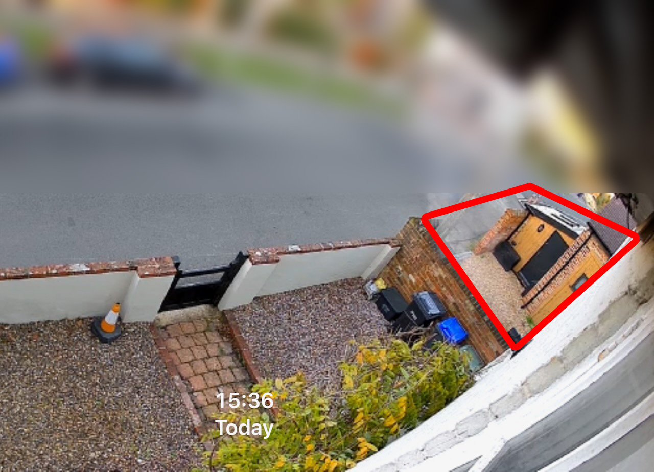

I am using an Aqara G100 camera with Homekit, and after setting it up I am disappointed to find that it can never detect a person, and sometimes even a car, in the area marked red either during the day or at night when night vision is on. It can detect people coming through the black gate, so I know it is working correctly.
I understand Homekit is limited to HD resolution, this is a 2k camera and through the Aqara app the quality is much better, so this seems to be a Homekit limitation rather than the camera. The only way I have managed to get it to trigger motion from this area is setting it to detect any motion, but this records hundreds of clips a day whenever even the slightest shadow occurs, so again I know the camera is not faulty as it detects motion in that area then.
Has anyone else had this problem with Homekit's apparently inadequate motion sensitivity? I would understand it not picking up motion in the far distance, but this is not an insignificant area.
Alternatively, has anyone got a camera that does detect people that are outside the immediate centre / front of the camera? I don't mind buying a more expensive one, but I feel like this isn't the cameras fault.
(In case anyone asks I have deliberately blurred the top half, that's not a fault.)
I would say the visible area is far too small to be reliably detectable. Camera is far too far away especially when working at lower resolutions like HomeKit is limited to.

Yes maybe so, but I'm interested to hear how other people get on in similar situations.
Well I can speak from experience with my 14 HomeKit cameras. Not one of them will accurately pick up specific motion when are too far away. Very accurate within perhaps 3 or 4m. After that, take your chances.
Reactions: eddjedi
I've noticed a few similar things occur occasionally but I don't have any G100 cameras. HomeKit is not exactly cutting edge up to date. I don't rely on HomeKit near a much as the Aqara software. The HomeKit front end is a nice to use convenient way to navigate the smart home.
I use numerous G5 Pro's and they pick up everything that is selected within a zone (60'+). HomeKit seems to be sleeping on the job sometimes but I just jump over to the Aqara app to check or verify.
I never rely on one to confirm anything.
Thanks, maybe I'll try the Aqara software instead, I just liked the idea of using HomeKit and staying in the Apple eco-system.
