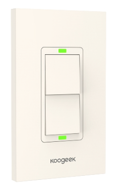

I have two overhead kitchen light fixtures that can't be modified with HomeKit compatible bulbs, and would like to have the switch be HomeKit compatible.
The problem is, the single switch has two toggles on it, one for each fixture.
What kind of HomeKit switch do I get that is compatible?
Thank you!

Another vote for the Koogeek 2-gang switch. I have three of them in my house. Works beautifully on 220V even though it's advertised as 100-120V only, by the way.

And if you mean a 2 pole switch (2 switches that only occupy a 1 gang switch) and live in the US your options are limited. Koogeek is the only HomeKit 2 pole switch I can think of off the top of my head.
It would look like this.
