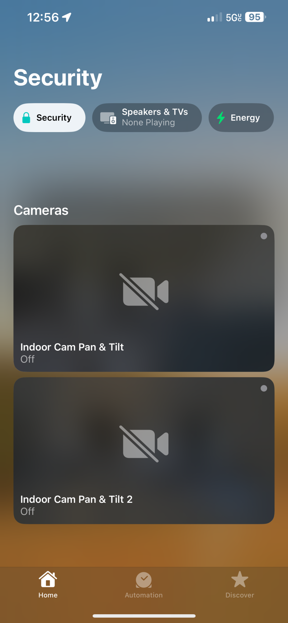

That's interesting. I've set up this system 3 different times. I've read everything I can locate online on how to set it up and use it. But as soon as I start using a vpn on the same TV as the hub it stops connecting. I have it set up to stream and allow recording when I'm away and did not receive the usual notification that that Home had "changed to streaming and recording because everyone had left." The cameras in the Home app always say OFF, even though they have been turned on in the Eufy app. I've been trying to get this going for several weeks and I'm just about at my wit's end. I'd hate to have to go back to using Eufy's videos but sure enough, I came home today to find a maintenance worker in my apartment which is illegal in my state and I have no proof. I just disconnected my vpn and restarted my Apple TV. Instantly got notices of the cameras being onlline again. So apparently for Homekit to work I have to disconnect my vpn and restart the hub every time I leave the house 😡
