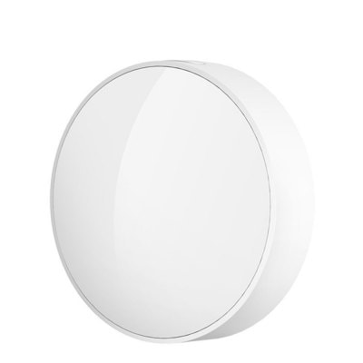

The Aqara sensor (it’s really a Xiaomi/Mijia but works with the Aqara Hub as most of their devices are interchangeable) is just a light sensor. Doesn’t do motion sensing. Yes it does require an Aqara Hub to work. I’ve only found them on sites like GearBest, AliExpress and Banggood.

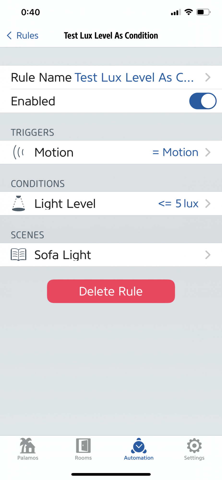

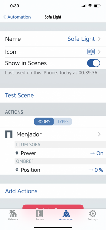

These are the rule and the scene linked. If i remove the lux condition then it works. When i add the lux condtion, the scene is not executed.

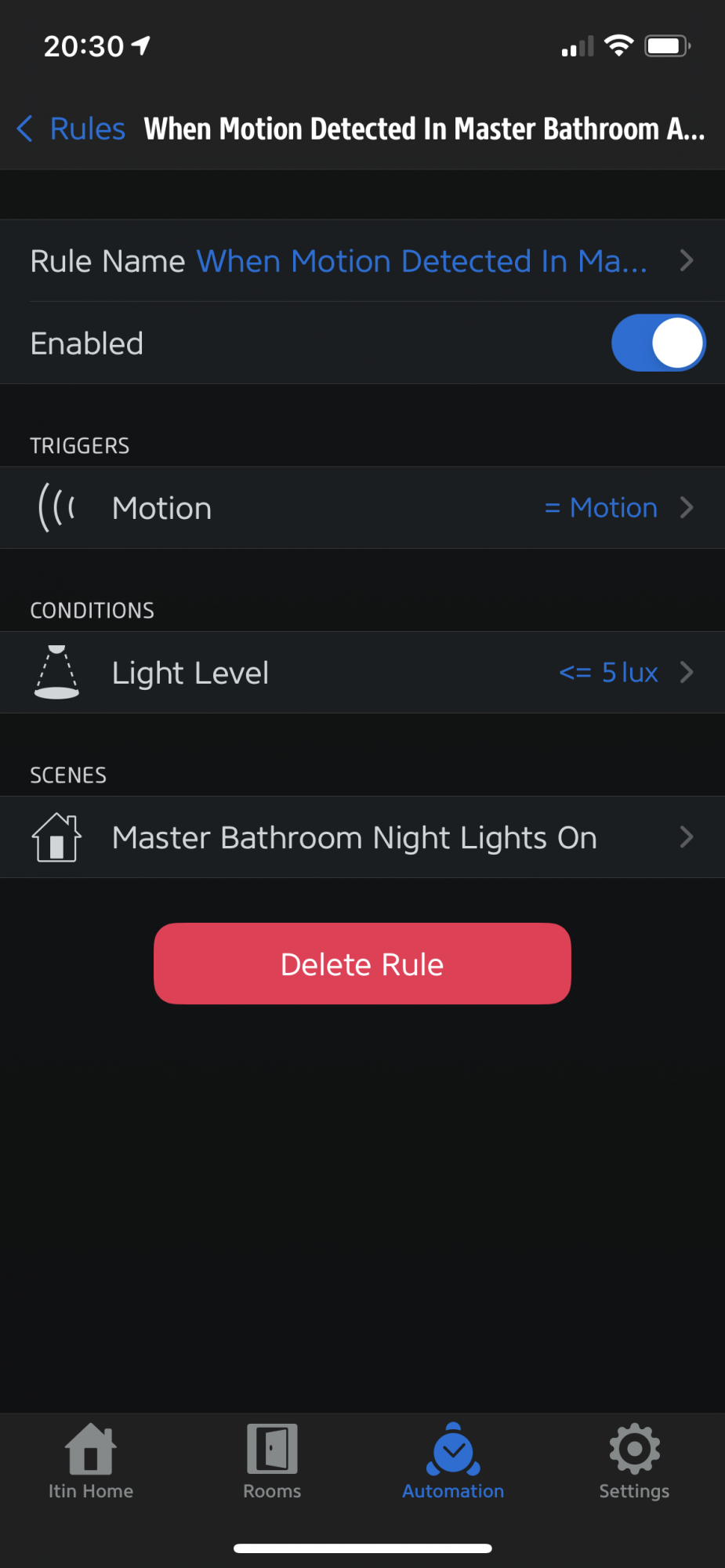

Here’s mine. It’s pretty much identical. Are you sure that the light Lux level is equal or less than 5 at the time the automation is being run?
Yes. It is 1 lux. I turn off all the lights and homekit app tells me that lux level = 1. In any case, if i increase value to 10 or 20 don't work either.
Hmm. Mine definitely works but of course that doesn’t help you. Did you try rebooting your home hub?

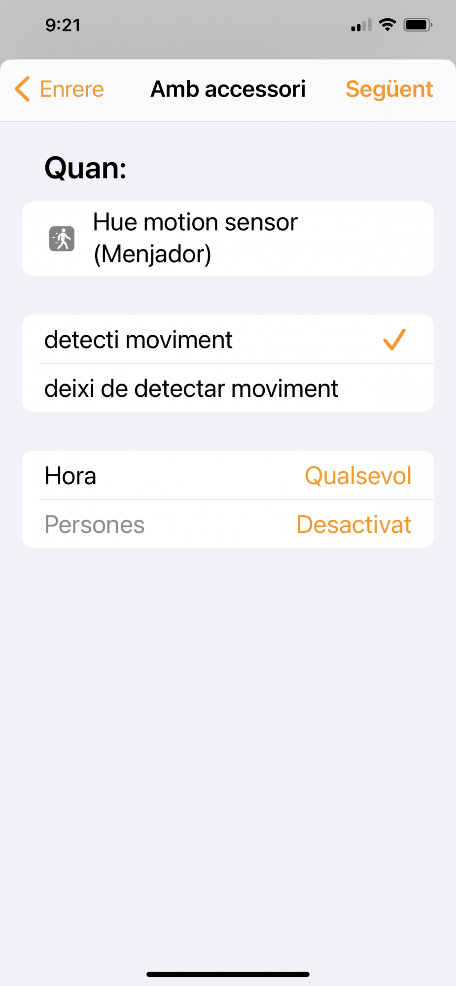

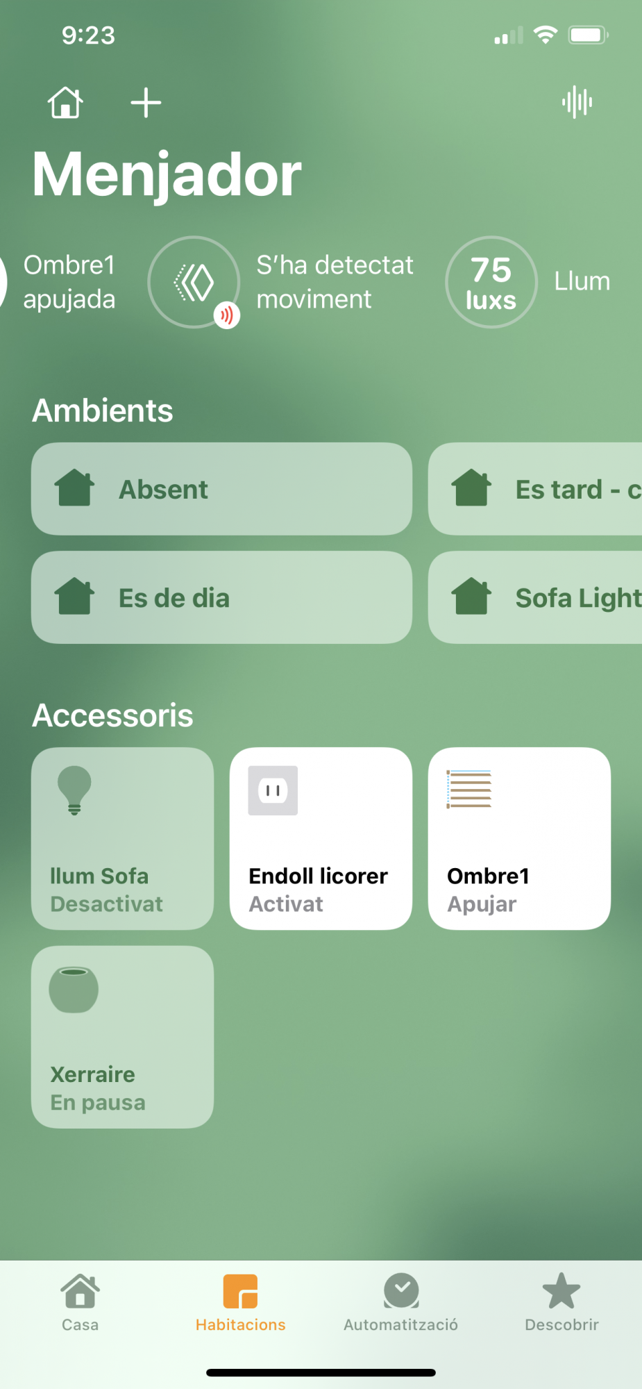

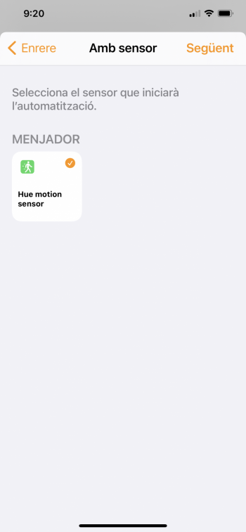

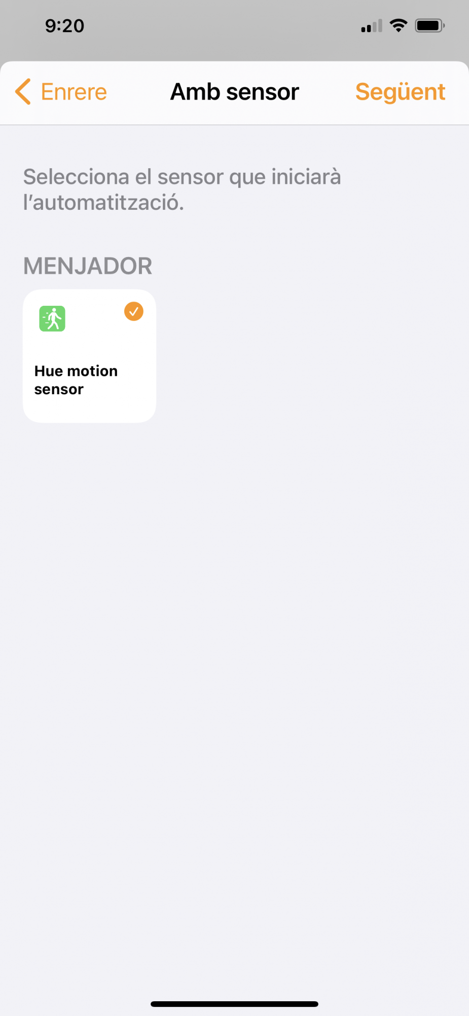

On the other hand i have detected that when i try to create a rule from Apple Homekit app i can select Motion Sensor as trigger but i only have the option to use the movement sensor. Lux and tempersture are not available to be used as trigger inside homekit app. Lux and temperature sensor are shown in home status bar but they are not an option when creates a trigger (see pictures). Is this normal?
Yes, it’s normal. The native Apple Home app doesn’t support automation triggers for items such as Light Lux, Humidity, Temperature, etc... That why I suggested the Eve app initially. Only third party apps support this. Why? I haven’t a damn clue lol. Once you create it in the Eve app, you can go into the Apple Home app and edit it.
