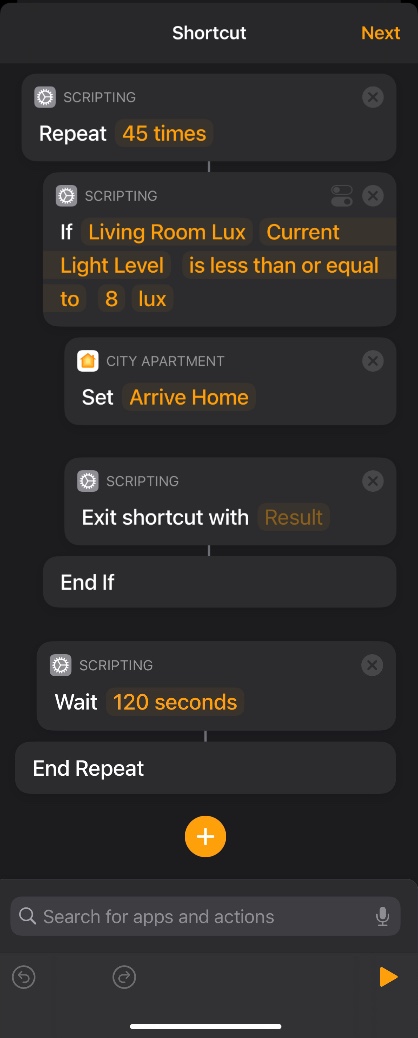

You can’t trigger based on Lux status, so here’s what I did. I created an automation to start 30 minutes before sunset, and repeat every 2 minutes for 90 minutes. It’s assessing the lux every 2 minutes and then turning on the lights when the lux is at or below my set point (and then exiting the shortcut). Please note that I use the lux measurement on a Logi Circle 2 camera that reports at regular intervals as lux changes. Philips Hue motion sensors only appear to report lux when motion is detected, so if you’re using one of them, you’ll want to make sure it’s in a high-traffic area so the lux is reported frequently enough to be used in this automation.
Hope this helps!
  1. Create new automation
  2. Select “A Time of Day Occurs”
  3. Set it to 30 minutes to sunset, or whatever might work for you.
    1. You don’t want to set it too early that the automation runs for too long, but you need to set it early enough to catch the point when the lux drops below your set point in all situations (e.g. both sunny and cloudy days)
    2. Set any other parameters for your situation. Note that I use this for my entire house, so I don’t account for motion or device occupancy - Only the HomeKit delivered “someone is home” functionality. You could nest some additional “if” statements here to account for other conditions.
    3. Select Next
  4. Select the lights or scene you want to trigger. In my case, I also use arrive home for the evenings. Don’t click next yet.
  5. Scroll to the bottom and select “Convert to Shortcut”
  6. Set it up as shown in the screen capture below.
    1. Note that no value is needed in the “exit shortcut with” value
    2. 45 is probably more repeats than I need, but this just ensures that the shortcut doesn’t run out before the lux drops below 8.
    3. Also, I used loops with 120-second cycle time, but this could be shorter or longer depending on your device refresh and how quickly your room gets dark.
