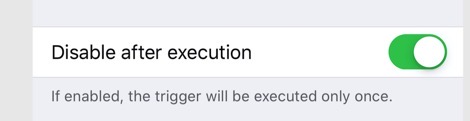

I know its late, but I've been having the same problem. I see what's going on and how to fix it:
If you look at the automation with Home 3 app (search for Matthias Hochgatterer in the iOS App Store), there is a "Disable after execution" flag. I don't see this in the apple home app. Sometimes, this flag gets set. I don't know why, perhaps it happened when I upgraded to Catalina or iOS 13 betas, but can't guarantee that. Anyway, turning that flag off and reenabling the automation has done the trick for me. As far as I know, this can only be done from the Home 3 app.
I don't believe you can do this from either the Apple Home app for iOS or for Mac. I don't know why Apple would not expose so important a flag. You may have to go pay for the other app.
