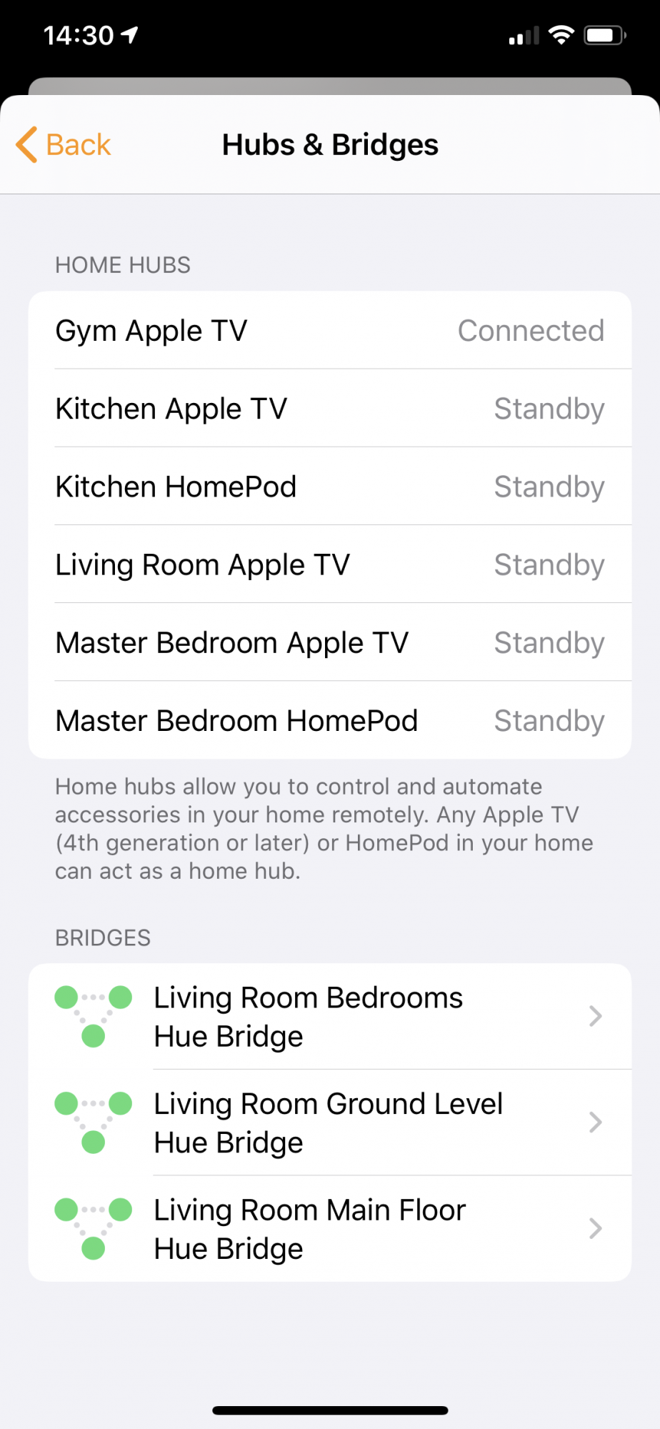

There doesn’t seem to be any rhyme or reason to this. I have four ATV 4Ks and two HomePods all being used as Hubs. Two of my ATV’s are connected via ethernet, one to an Eero satellite node and the other direct to the main Eero router and for some reason, HomeKit keeps defaulting to an ATV in the corner of the house running on WiFi. Like you though, HomeKit is running as it should, except for terrible lag and accessories updating when I have too many apps running in the background and Safari is open (I’m attributing this to the Ram management issue of iOS13). iPhone runs hot while this is occurring but it clears out when I close the background apps.
