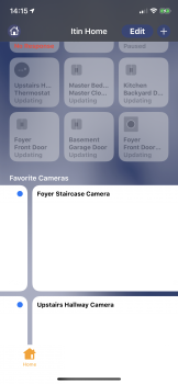

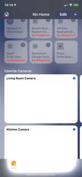

I don’t know what’s going on with this. Was very stable in iOS 12. It’s very laggy and then today all my devices are taking forever to update. Then when they do I get “no response”
Freezes a lot too. I’d have to close it out and re open.
Look at these pics where the camera row is:
***Edit*** Reboot fixed it but it’s been laggy since iOS 13. I feel like I’ve rebooted my phone 100 x in the past week lol.
