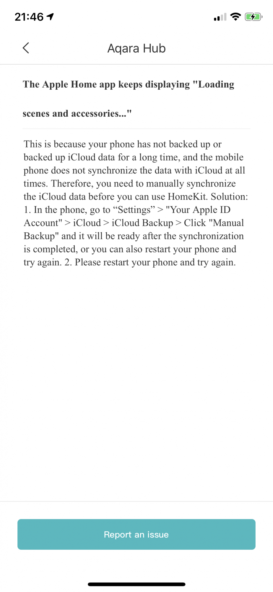

Came across this a while ago. Not sure it works but worth a shot.
I am getting this same bug in 2023. The manual iCloud sync didn’t help. Other options?
