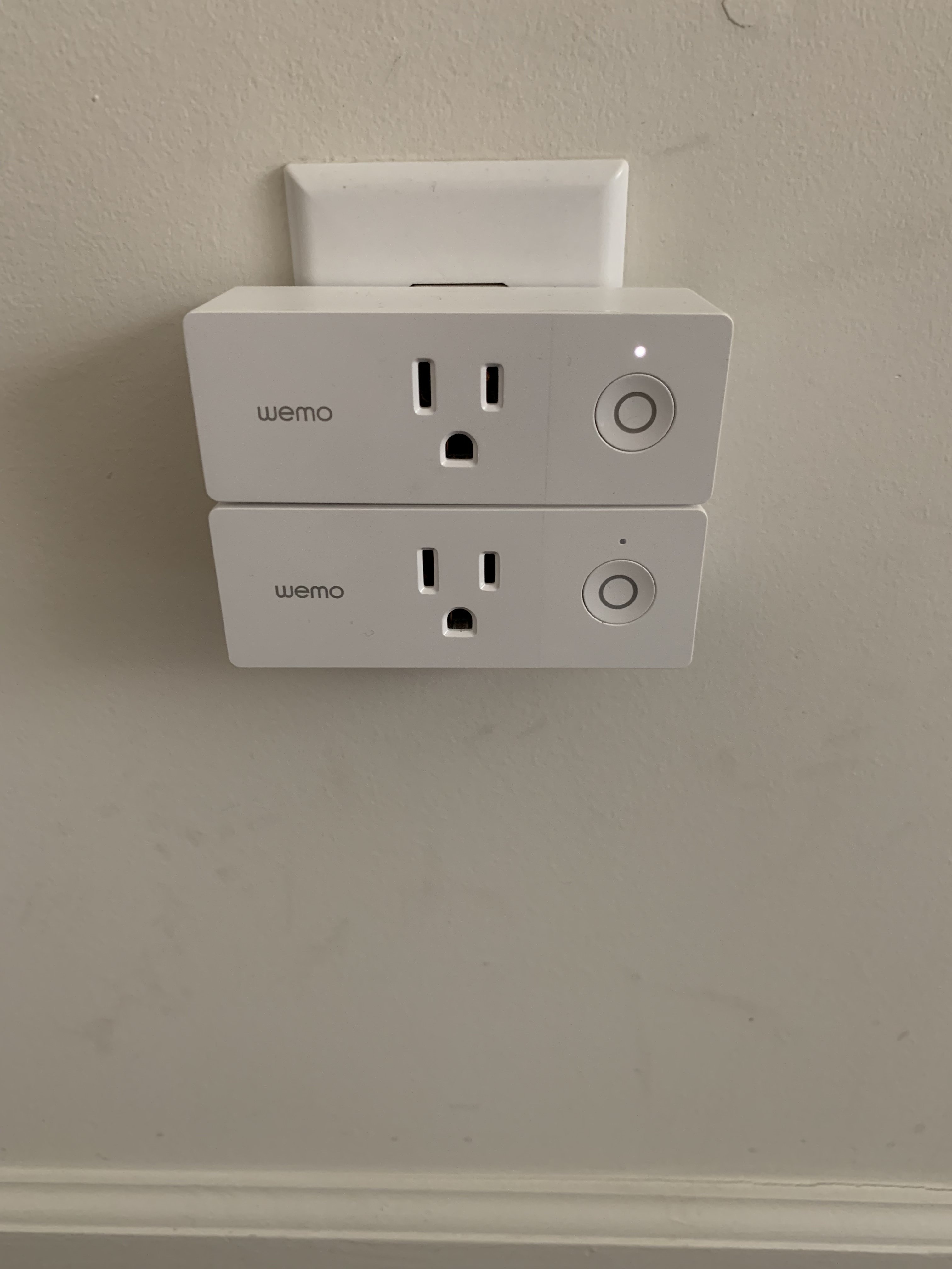

I personally use the Wemo Mini. A separate Wemo bridge is not necessary for these and they have a horizontal bias which allows you to stack two on one double outlet or use one and leaves the remaining outlet still available. A bit finicky to set up but work well once they’re configured. There are two versions out there. One is HomeKit compatible out the box with a HomeKit QR code sticker and one that requires an update through the Wemo app for HomeKit compatibility. Both work the same once configured for HomeKit but I’m sure I read that with the one that doesn’t have native HomeKit compatibility, the Wemo app is required.
[doublepost=1561058194][/doublepost]Here is a pic of two of them stacked. The little white LED indicates that it’s on. A nice little glowing light that doesn’t light up the whole room in the dark. I use them as “Presence” indicators (something I miss when I was using SmartThings) and for automations. It allows to bypass a notification for my garage doors and open them automatically when anyone privileged arrives.
