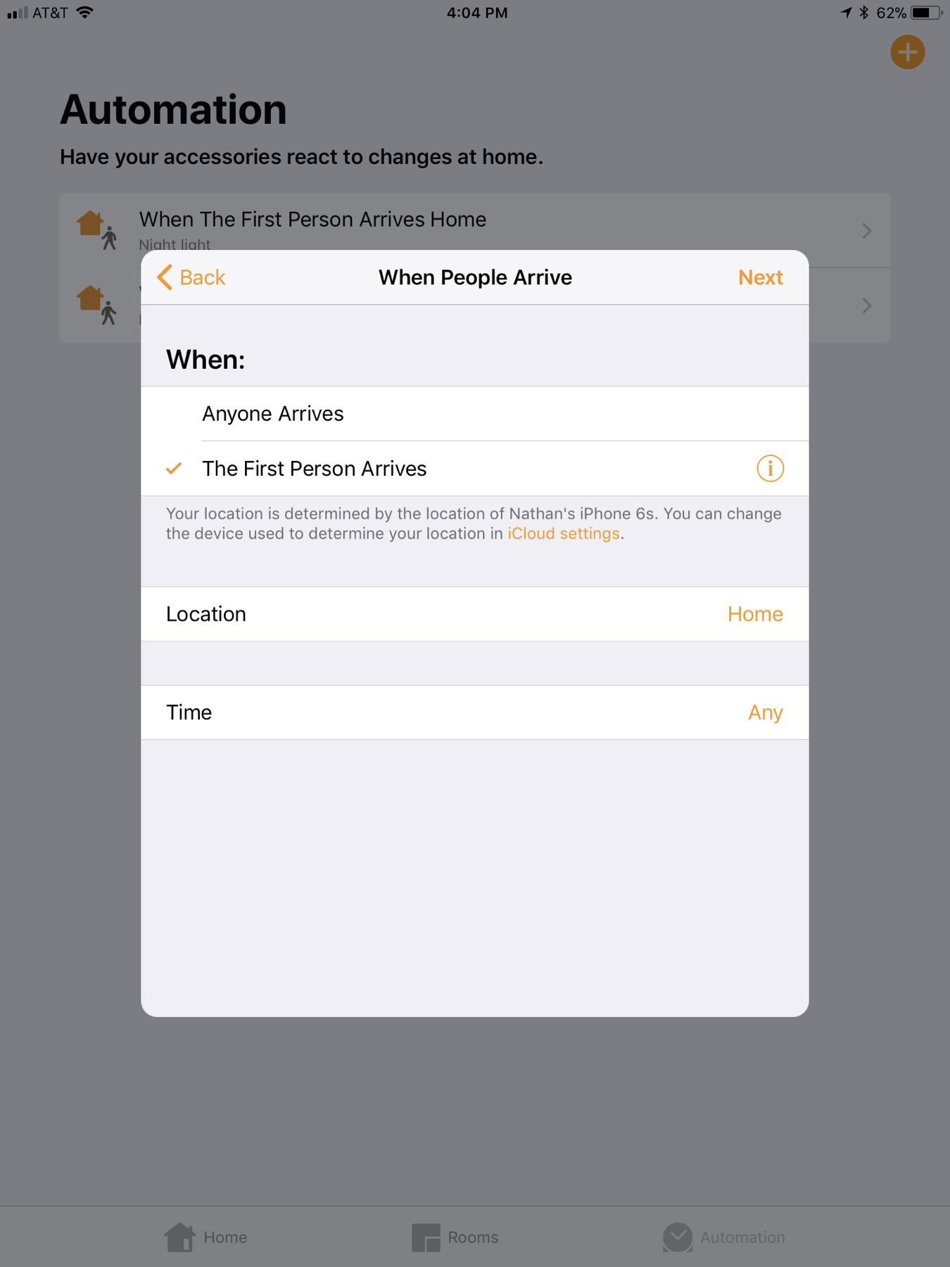

Update: feature request was added/fixed.
Edit: I deleted all of the automations and created new ones. Works as it should now. This is going to make a lot of people happy.
HomeKit is still missing a much needed feature. There needs to be a setting for automating first person arrival. For example the first person home sets off an automation stating that; if it’s after sunset turn on the den lights to 100% and the set the thermostat to 74°. Let’s say that my fiancé was the first one home and before I arrive is now watching TV in the den with the lights at 27% and the thermostat at 72°. When I arrive home I now want the automation to do nothing because quite frankly that would be nothing short of an annoyance and inconvenience if the automation were to run again.

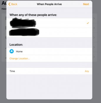

The “When People Arrive” automation is for “when any of these people arrive”. As far as I can tell, it does exactly what you want? Am I misunderstanding your requirement maybe?
To do it now I have a homebridge setup. This has the concept of “Anyone” and “No-one”, as well as each individual, as presence detectors but I think I can ditch that particular piece when she updates to iOS 11 and we updated the Apple TV in the fall.

I just tried it and it activates every time someone arrives not just the first person. I’ll reset it and try again if that’s its intended purpose.

Ah, I see, As I said, I haven’t tried it yet as it’s only me on iOS 11 (hence the reason I cannot put a tick on the 2nd person in the screenshot below). Are you both on iOS 11 beta? Anyway, wouldn’t be surprised in the slightest if its buggy at this point but the description of the function is pretty clear.
Hopefully a reset will fix it but, if not, it should get fixed later.

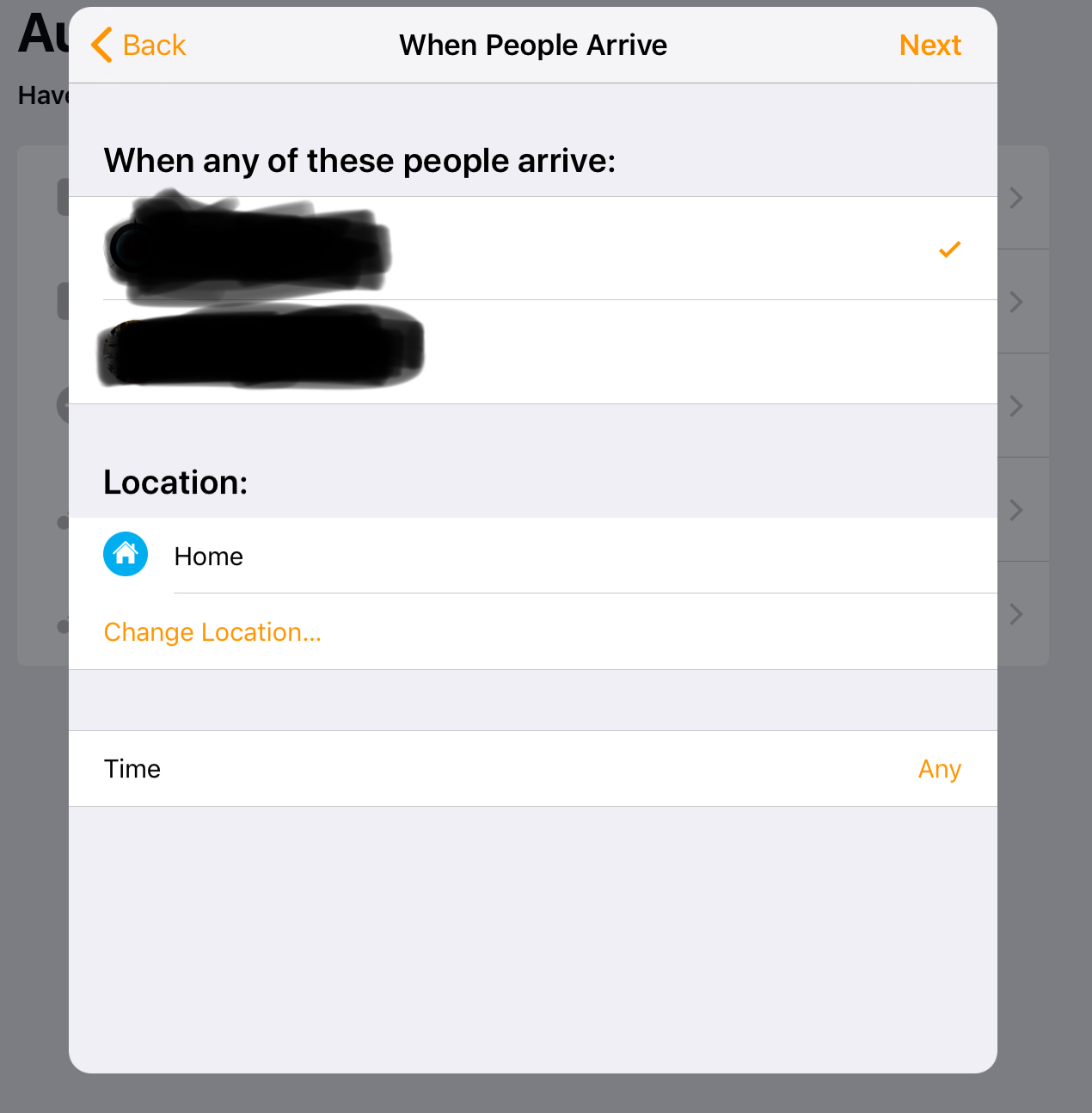

Edit: I deleted all of the automations and created new ones. Works as it should now. This is going to make a lot of people happy. Updated first post.

Hey. They added it. That’s exactly what I was looking for.
