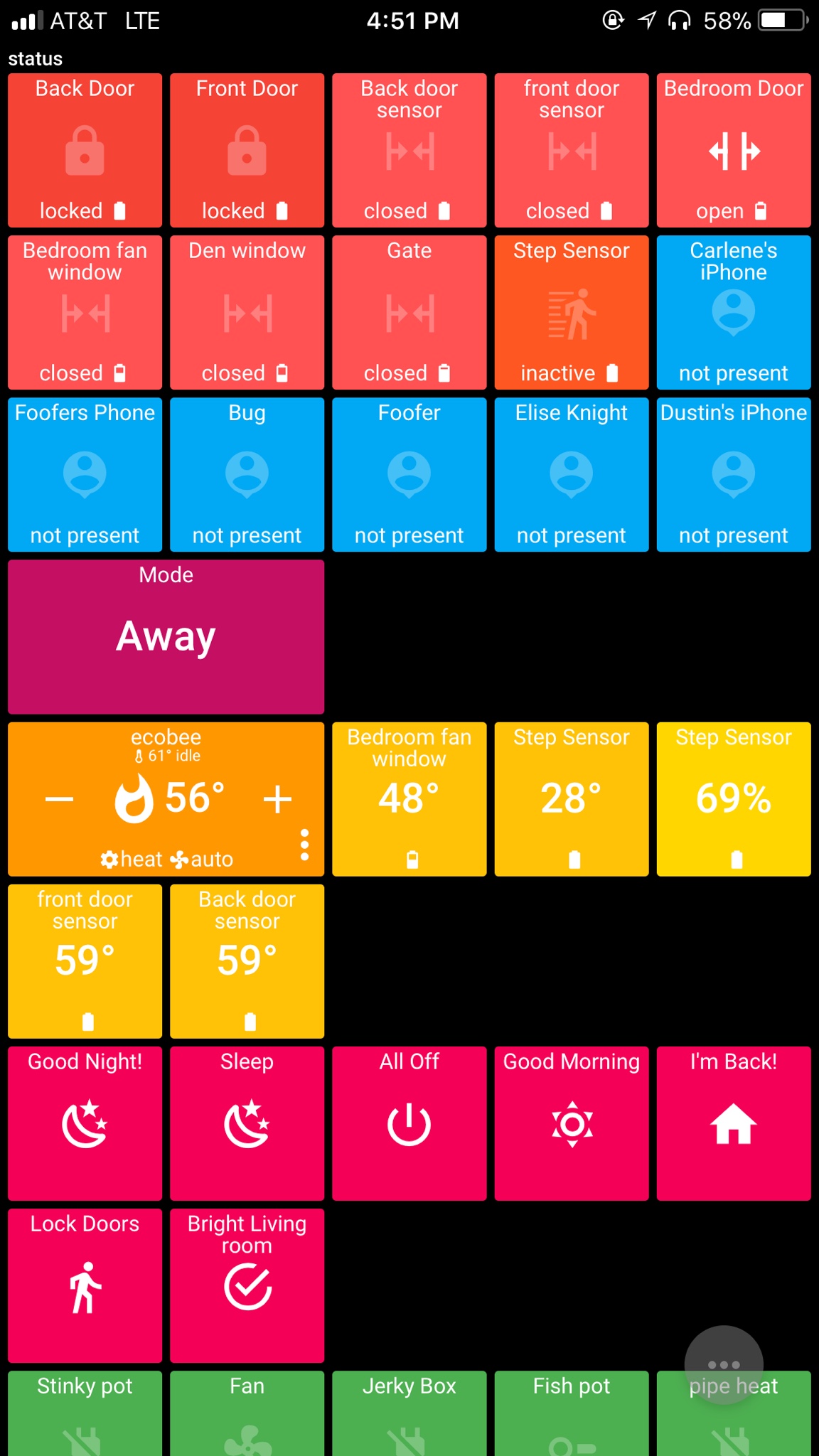

SmartThings is what I use and I have had it longer then HomeKit has been around. Mainly my wife uses homekt to control things with her voice as she is blind or Alexa. SmartThings automates things better. Like here is a web based app that shows me all that going on at-a glance you can run it on cheap tablets too. Now I try to get devices that run on everything but I have most things.
Impressive setup. Barring the fact that some/many of those devices can't be control via HomeKit because they aren't enabled for such is there anything there that there is no homekit solution for?
Just curious, again that looks pretty nice. I'm especially curious what sticky pot, jerky box, fish pot and pipe heat are.
I have a few things like the ecobee and some outlets and hue that work with everyone. but most of it is automated to our coming and going and smartthings does all of that. the stinky pot and fish pot are just those wax hot pots for fragrance. the jerky box is the dehydrator. pipe heat is heat tape for our pipes that I have set to turn on and off when it freezes. a few things homekit does not have. like the smart mouse traps and such. Plus it is far cheaper to get generic sensors where I can use them. I have a pill box for my wife that sends notifications when she opens each compartment that I built for her. I try to buy new things that work with all the main controllers smartthngs alexa homekit and google. but I have been doing this for several years now so I don't really buy much new. sonos will notify us when someone is on the porch or our children arrive.
Heat tape is a really good idea since generally its found in locations you don't want to be in (crawl space, attic, etc). I have some for my furnace drain piping but it operates off its own thermostat that is strapped to the pipe.
With Smartthings could you set a trigger (via IFTTT for example) to only turn it on when you local temps are below freezing?
I'm to the point now where I'm automating things I never really use just so everything matches. Nearly every single switch in my house (except guess bedroom) has a smart switch/dimmer. I can't really think of anything else to "automate".
our pipes are open to the elements. I thought I had them wrapped well but one small area froze and caused hell. it was 20 degrees and i was crawling on the ground replacing the pipe. smarthings can be setup to turn it on and off. or you can use webcore to really program the hell pout of it. I had to pay a neighbor to install the heat tape and insulation. I odn't have too many plugs controlled I don't need them. but I do have a whole house fan plugged into one and when I open the window the fan turns on. reminds me to shut the window if I leave and I have forgotten tells me to open the window when the temps are different house and outside. heat turns off when we leave turns on when we come home. when I run the goodnight routine most lights turn off some dim doors lock all the things that should turn off like other sonos speakers and hot pots turn off the heat right now is set to 1 degree warmer when I take a shower. when I am in bed a button hit will turn everything off check the doors turn the heat down and arm the system. in the morning one hue light strip slowly ramps up then another light and another then all of them.
Don't get me started on the nightmares of frozen pipes. I had to physically remove the furnace to add heat tape the frozen pipes (drains). And then reinstall it. Since its accessed through an outside closet this was done in 15 degree weather. It was such a pain I actually used two heat tape strips and one is just a "back up" incase the first one burns out. Piss poor engineering.
