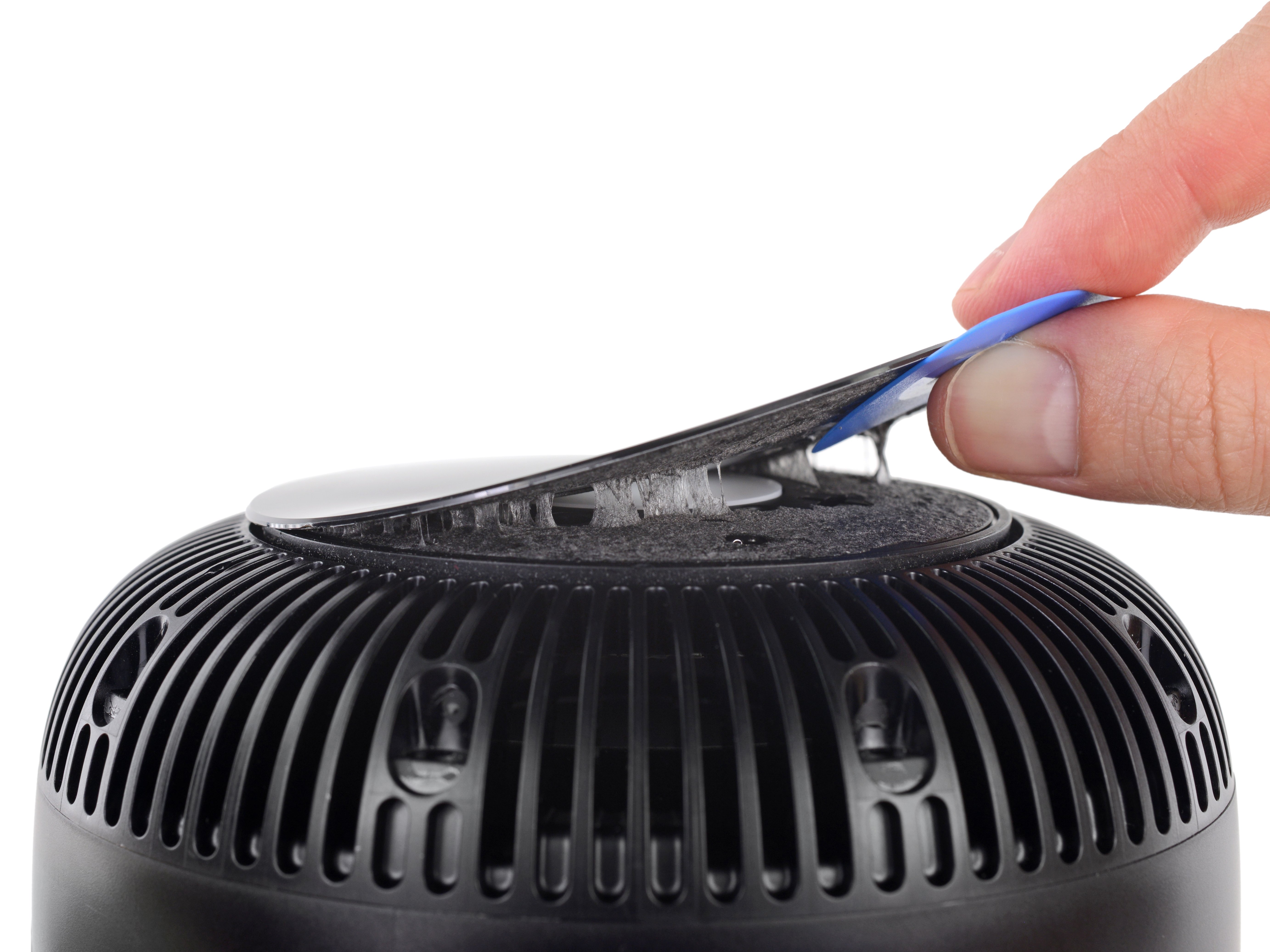

I'm pretty sure the HomePod downloads the firmware by itself, not the iPhone. When I first had mine and automatic updates were enabled, it updated while I wasn't home and my iPhone and iPad were with me..
The diode you speak of is located on the circular shaped amplifier board. The main logic board is the smaller circular board right underneath the touch sensitive control board on the top.
I've written a proper disassembly guide on iFixit a while back.
