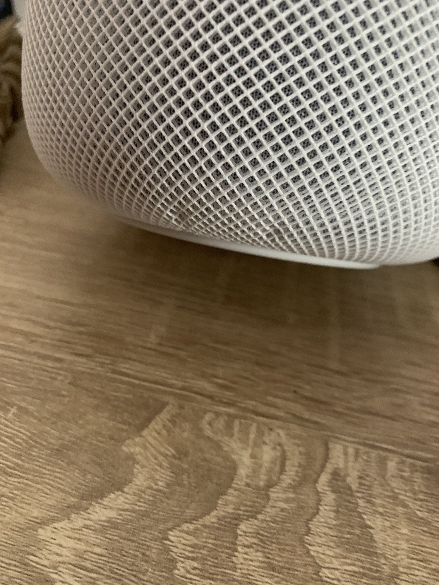

Received my replacement and am not overly impressed it wasn’t a BNIB, it just came in a standard brown cardboard box.
Also upon inspection there is what looks like a dirty mark on the fabric and two sort of puncture marks in the fabric near the base.
So in short I had the HomePod for 2 months had the fault above, sent it in and got a replacement which works fine but the condition is worse, thinking of contacting them about this... as not overly impressed with the service so far

Can you upload pictures of the marks you describe so we can see what they are.
Here is how my replacement came, I know it’s not major, but I know Apple will use this in the future if I have any other issues whilst in its warranty, claiming I dropped it etc...
The one I sent to them was flawless as I literally only had it 8 weeks, they calling me Monday morning to discuss the issue.
Hmmmm certainly not perfect as you’d expect anyway....looks like it wasn’t sitting right in the packaging and that has left a depression on the fabric...wonder if that will correct itself if it is only a depression in the fabric?
You should show Apple that picture when they call you and see what the response will be?
Yeah I have forwarded the image to them, and they said the department that they needed to speak to don’t work weekends so they giving me a call on Monday

Just an update having sent the replacement back Apple have decided to replace it again, and agreed that the damage was unacceptable
