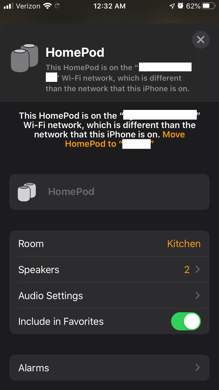

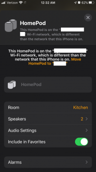

Did you try doing this: https://support.apple.com/en-us/HT208341
HomePod Settings in the Home app:
Tap Wi-Fi Address to see the Wi-Fi Network that HomePod is connected to. If it's on a different Wi-Fi network than your iOS device, tap "Move HomePod to [Wi-Fi network]" to connect HomePod to the same Wi-Fi network as your iOS device.

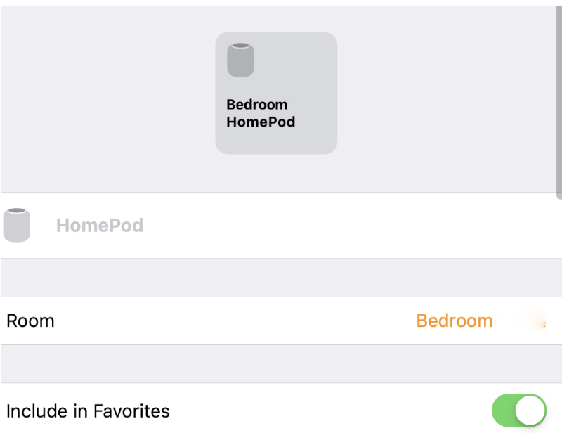

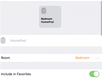

I don't see the Wifi setting?

Your second screenshot shows Wi-Fi Address, right after Model and before Version. You need to click on it so it shows the network it's connected to. If it's different than your iPhone, it should ask if you want to move to that network instead.
Sorry, wasn't clear since I wiped it out. The WiFi address shown (and I wiped) was the mac address, not the IP address. It is not clickable or changeable. So I don't see a way to change the routers to which it connects.
I know it doesn't seem clickable. Just tap it and the mac address will turn into the network name. Trust me.

It was greyed out so I didn't click it. But you are right, a click shows the WiFi network. For a HomePod pair you have to click on Speakers, and then the individual HomePods to see them.
However in neither case do I see an option to change to the different network which my iPhone is using.

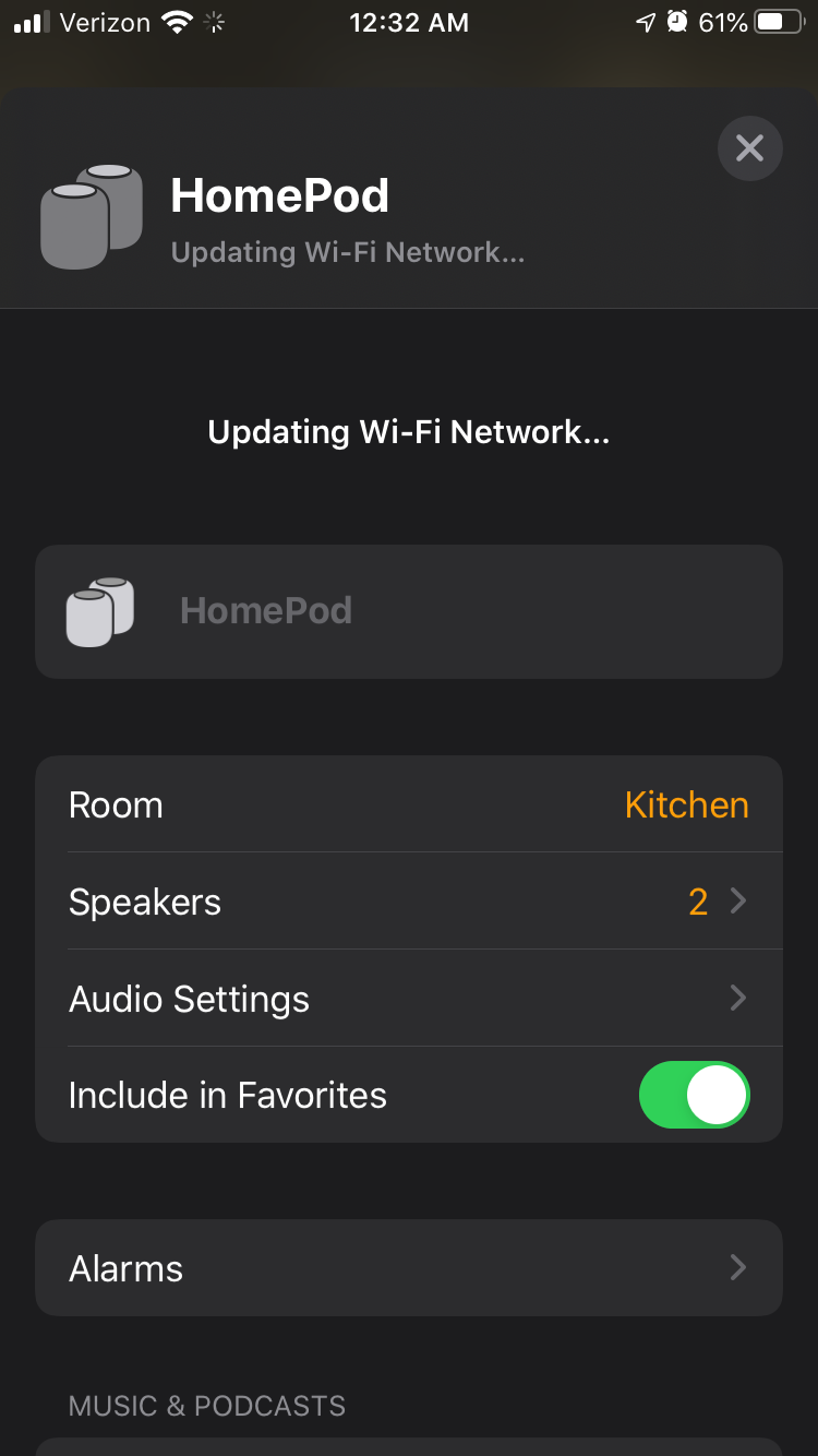

Once I'm in bluetooth range intentionally using a different wifi network (hot spot)....
Clicking on Move HomePod to.. results in a brief update then its on the same network.
Switching back is just as easy.
Yes, this works. But you should not have to do that. My HomePod is 10 feet from my own router and my router is always broadcasting. So I don’t know why it would try to flip to the Xfinity router (which has a much weaker signal).
